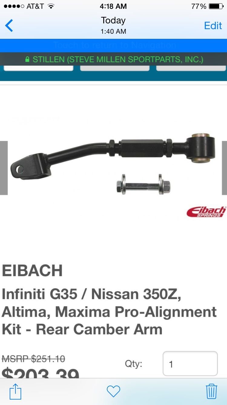

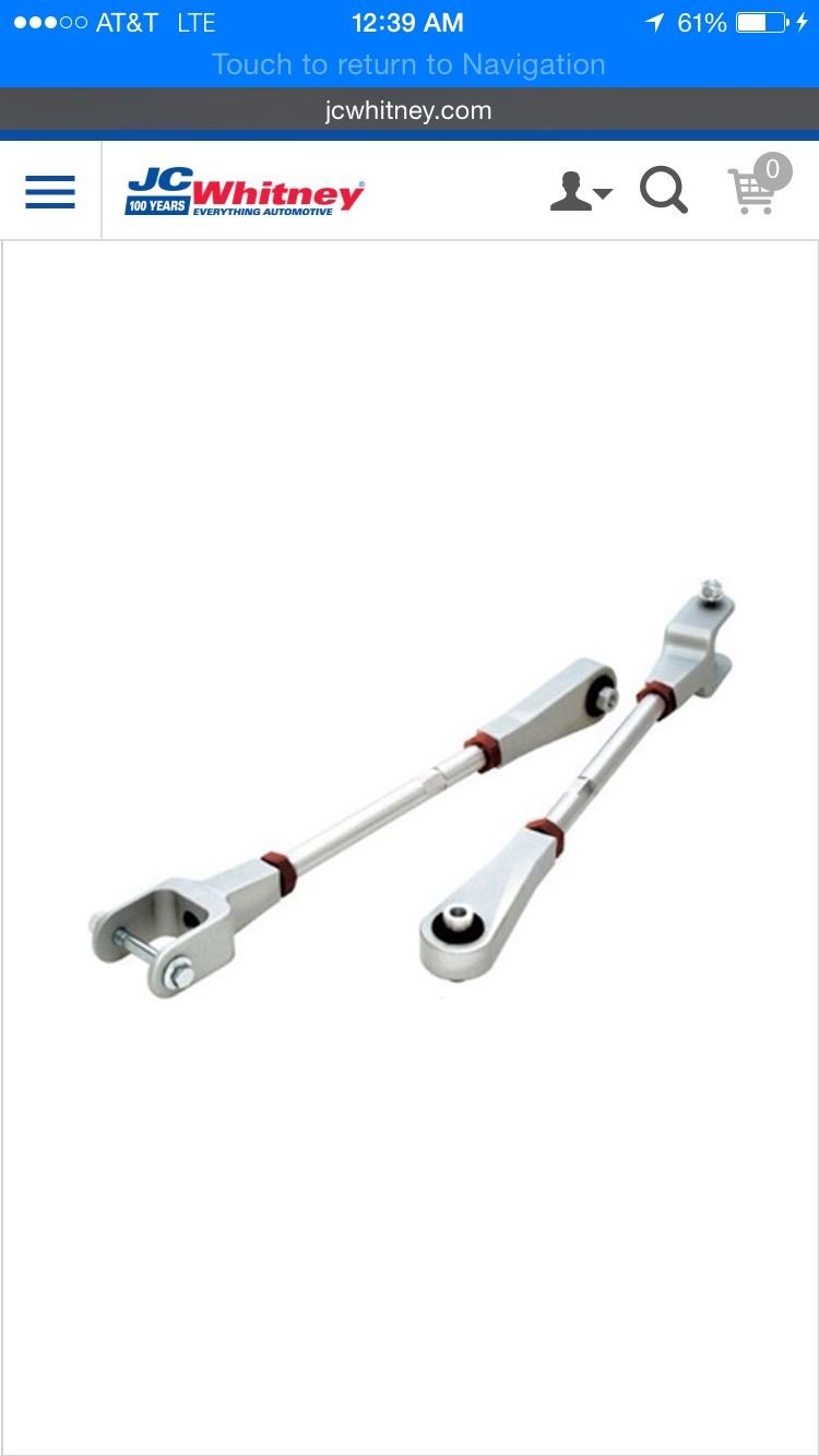

Confused
So I was looking into the eibach camber kits and came across two that claim to be eibach for the 7th gen. I don't want some half a** part on my car, which is the correct piece?
Old Aug 2, 2015 | 10:21 AM
MaximaDrvr's Avatar
Joined: Nov 2012
Posts: 1,269
From: Charlotte, NC
They would both probably work, but the second one is the one we are all familiar with.
