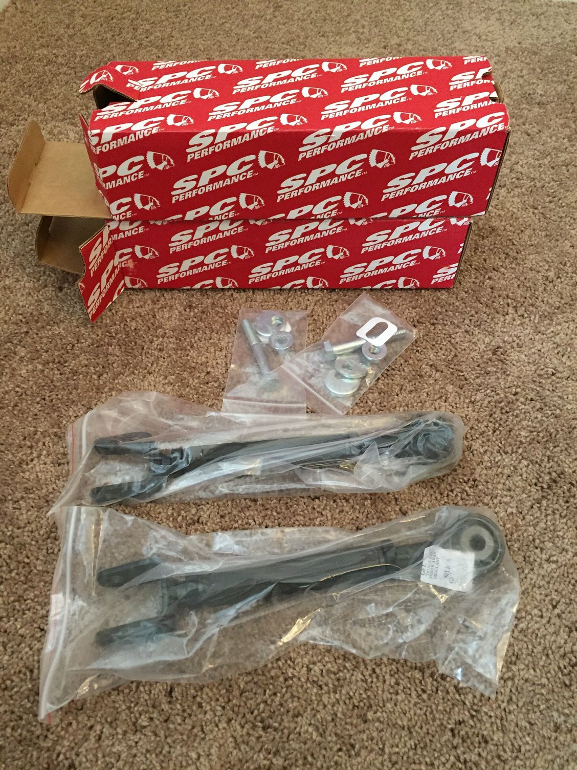

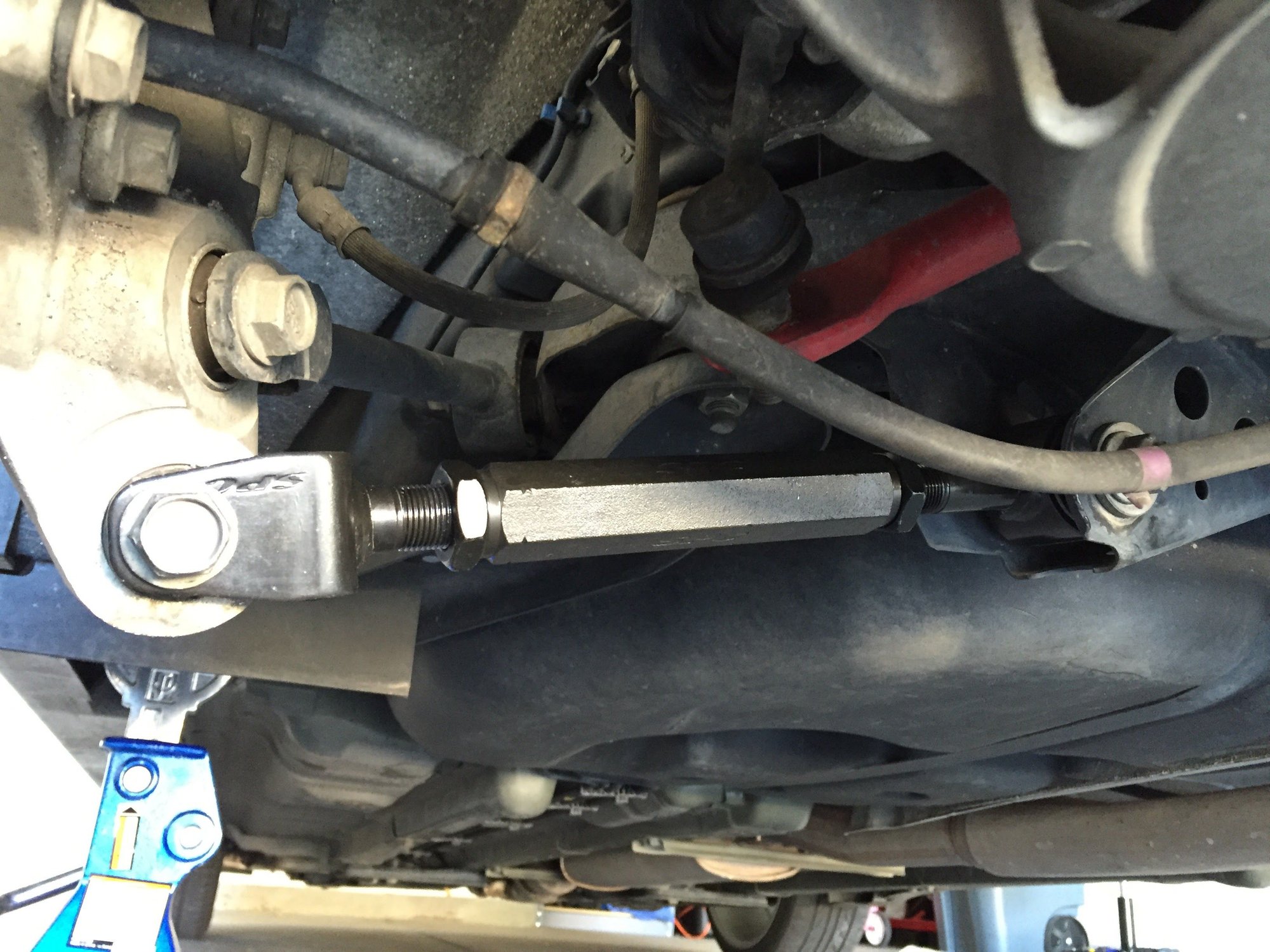

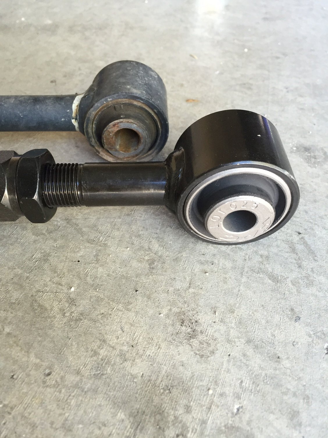

I only am running Eibachs and still get too much negative camber for a daily driver. I've got 1.7ish in the rear and the front 1.2 negative. I will dial out the front a bit with camber bolts and the rear will need arms. I am not going to install the toe bolts since I can get that correct without.
