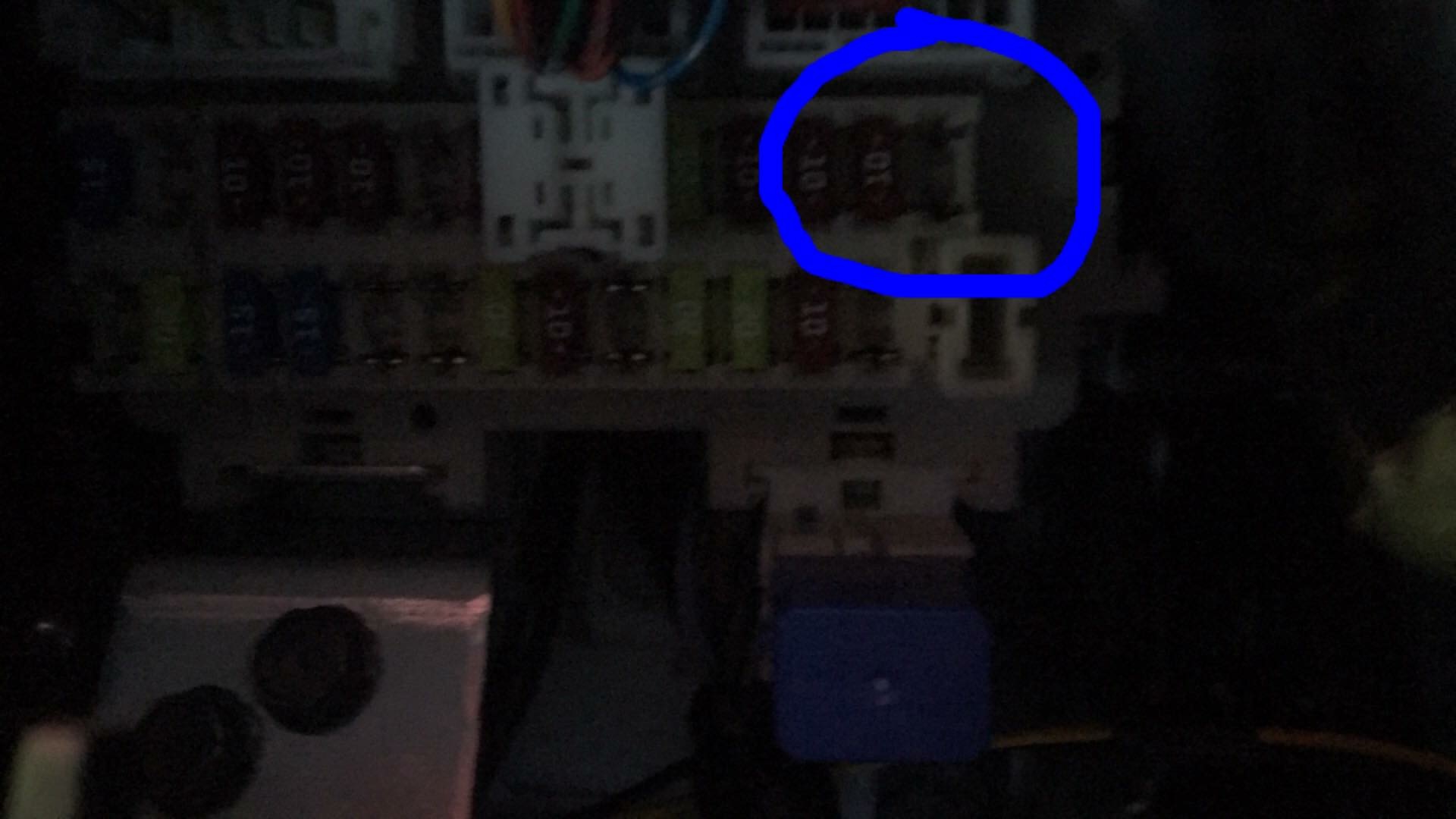

Okay so I figured out it was a blown 10 fuse called "elec parts (ign)" Smh It's in top right,2nd from right in the fuse box by the driver side. For some reason, if that's blown the gear shift won't move and the AC won't come on.
Attached Thumbnails A/C  won't come on and park stuck 2014 Maxima-photo.jpeg
