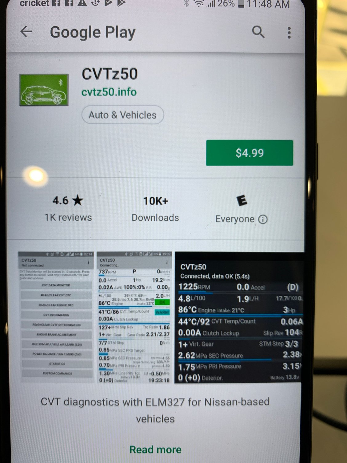

theres a app for that allows you to turn it off if you have android and a bluetooth obd2
Only CONSULTIII can hook up to ECM and does the job (correct me if I'm wrong) unless something new came out.

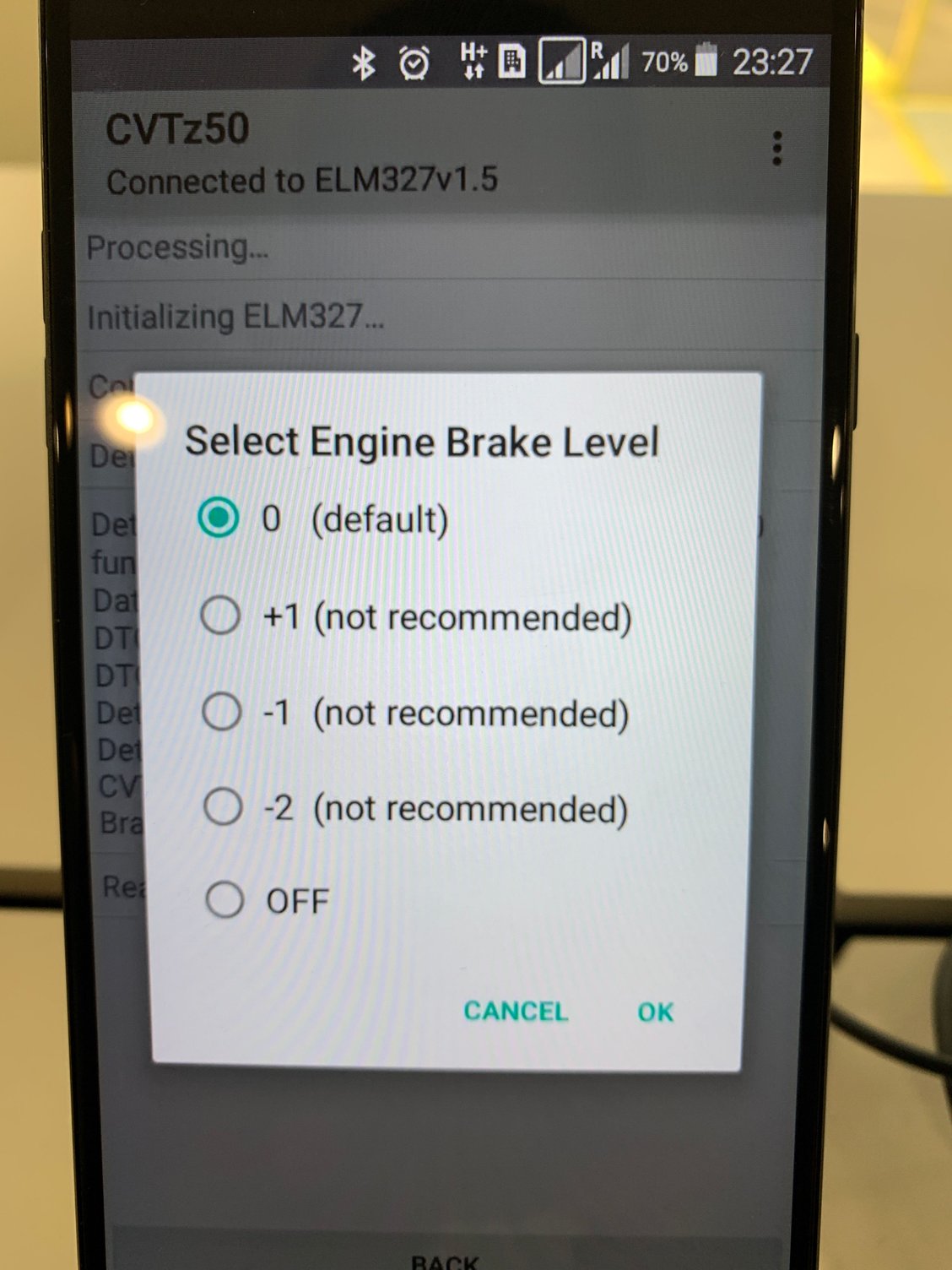

Originally Posted by Anthony Langley
If this wasn’t what your looking for I apologize
Never heard about that before, can you send link please ?
Edit: Found it in Google play.
Edit 2: Man you're great! thanks! I bought the app and it worked like a charm. Set engine braking to off from default! No more stupid RPM to 2.5k to 3k when going slight downhill!
Thanks a bunch.
I owe you a beer lol

CVTz50

Bluetooth obd2
Originally Posted by MadMax07SL
That's pretty nifty! How does the phone interface with the car, USB and that's it?
As long as you have a Bluetooth obd2 a android phone or tablet and $5 your good to go

Great app, provided you have a Bluetooth OBDii dongle.

Do you have engine braking off?
I was imagining, as you mentioned, engine braking is in effect even when letting of gas on level roads costing to a stop (light or sign). I have it off now, car "seems" and "feels" more free when off gas. I guess you have to try it for yourself (if you're still have the EB on default).
