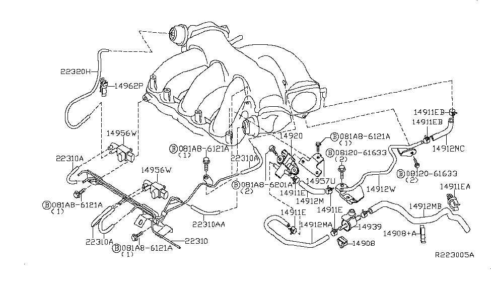

I replaced the left rocker cover on my 2011 and a few tubes were cracking and splitting, causing my engine to shunt and heave as heard in video. I replaced the cover because of a failed spark plug that was covered in oil and the engine seems to run fine disregarding the noises caused by what is probably a vacuum hose. I was going to buy the GATES EMH297 and whatever fits 22310AA on the provided diagram. I can't tell what gauge the hose is and I don't exactly feel like taking it off to bring it into a store because I don't think I could get it back on without grease, so if someone could point me to a manual containing hose sizes by engine section that would be very helpful. I'll update how the engine sounds after I replace the two. Then comes the control arms, cv axles, brake pads. So expensive...
Engine Control Vacuum diagram from https://www.nissanpartsdeal.com/part...um_piping.html

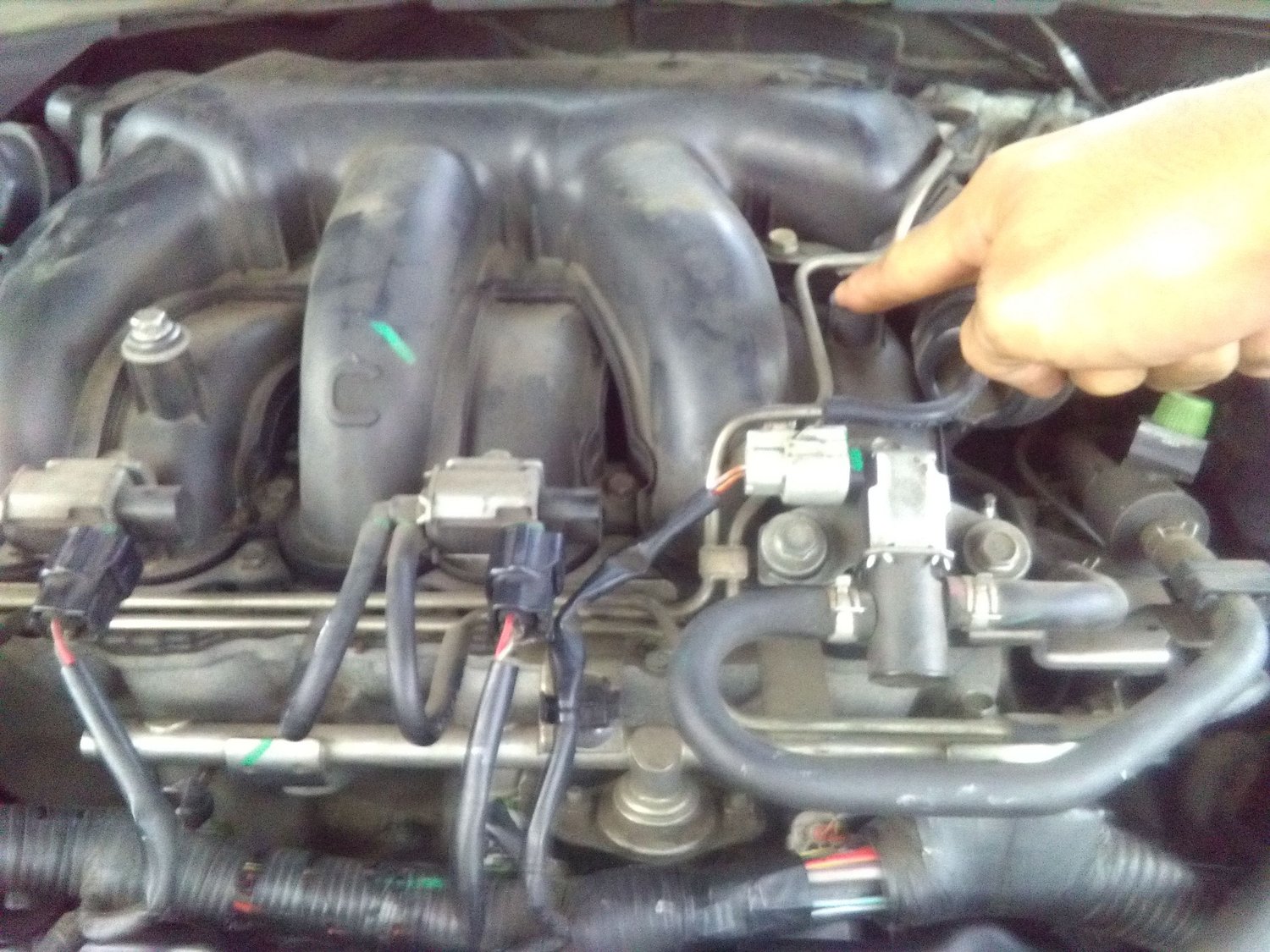

Update: I found the issue. I wondered why the plenum bolt had a rubber piece on it; I now realize it was a seal
Plenum bolt missing
