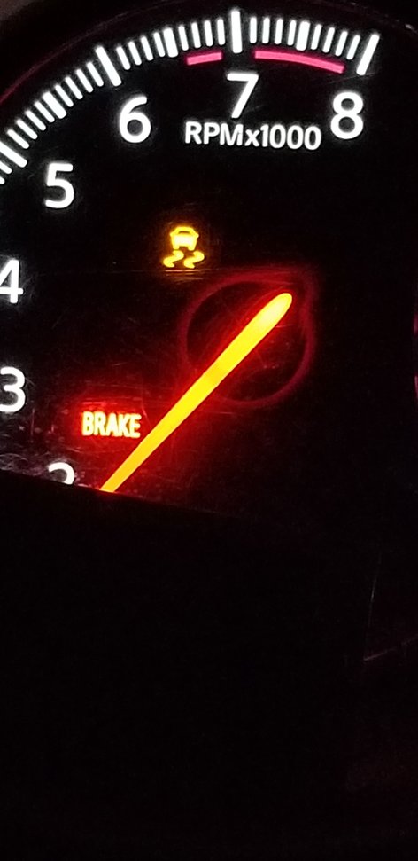

These lights keep coming on randomly, any ideas why??

Check your brake fluid level and top it off. If that isnt the issue, you may need to look deepet.

That's what we thought so we topped it off and it still comes on

Could be dirty ABS sensors. found at each wheel...

Try overfilling a bit. Some have reported that works as well. But the intermittent nature sure sounds like the fluid level sensor, but if not, MadMax's suggestion sounds like the next place to start.
