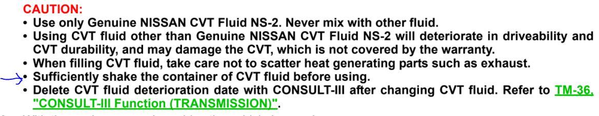

.....Per FSM they want it exactly 158 to 161 when fluid level is checked.
I know this is an old thread, but the FSM for a 2010 says to check when CVT fluid is between 122°F and 176°F.... Just saying
