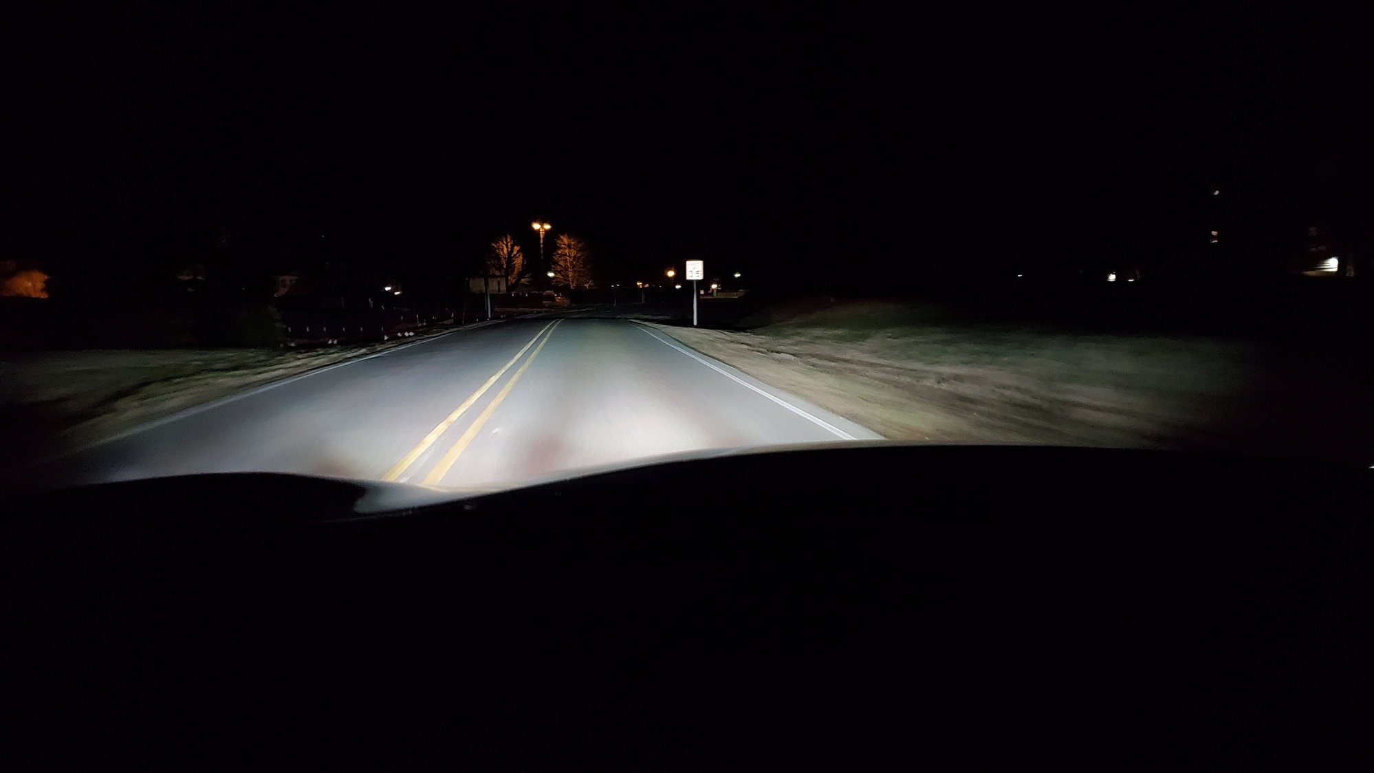

Done! Also replaced fog lights, both seemed to have issues (melted interior, cracked lense, and other was fogged over)
I'd say it's a 4000% improvement over stock halogen, before, I would easily notice my fogs being off, now I really have to focus to tell.
Morimotto 35w 4500k HID kit

Much better. Actually makes night driving fun . Prepare to look back at your car 20 times after you turn it off and wait for the headlight delay. Such a pretty sight
