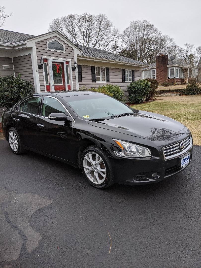

Hey folks, new guy here.....just got my son his first car, 2014 SV. I have a dilemma I'm hoping you experts can help me with, and PLEASE don't skewer me if this topic has been discussed, I did a search but there's SOOOO much info here!
The car has the OEM 18x8 wheels with the OEM 245/45/18 size tire. Since this is my son's first car and I KNOW he's gonna nail some potholes/curbs, I had a thought about giving a little more sidewall by dropping the rim size to 17x8 with some 225/55/17 tires. I know its not much, maybe 1/2" more sidewall, but the car needs tires and he has saved some money for aftermarket wheels, so I can put a whole new setup on it.
The issue I seem to be running into is whether or not a 17" wheel will fit, most sites I looked at say no. But there has to be people running 17" wheels just based on some of the searches I've done here. My guess is the problem with a 17 is whether or not it clears the front brake calipers? I slid my hand between the top of the caliper and wheel and it stopped around the start of my palm, so I'm guessing there's around 3/4" clearance on the current setup?
Can someone verify this is why some wheel sites say a 17 won't fit? And if any of you are running 17's, are there only certain wheels that work? Is wheel width a factor or just diameter? Thanks in advance!!
