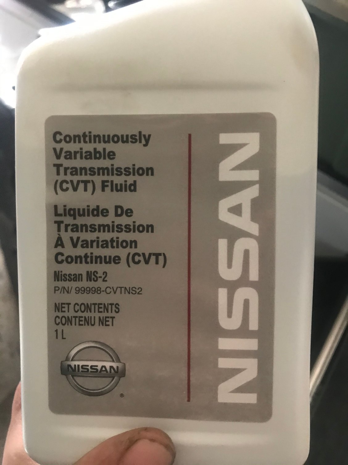

Are you sure the fluid is Nissan fluid? Did you use 999mp-cv0NS2?

I'll have to go check the bottle of CVT fluid, but the parts guy looked up my vin and got me Nissan ns2 fluid. I put the right amount in and now might of added a bit too much as I thought adding a bit more would help. The gasket was stuck onto the car and before I reused it I keep researching if I could and found a article saying the metal types are reusable if they are in good condition and this one was. I didn't touch the valve body at all and I did use the Napa screen cuz the one i took off had a bit of metal in it and didn't want that to get mixed back into the tranny. Didn't drop anything down the tube and No codes on the car.

I just checked the bottle and they sold me P/N/ 99998-CVTNS2

Also just found out the CVT fluid i used is the correct kind for that car, the only difference in why the bottles may look different to some is mine is in liters since im from canada and the other bottles are in quarts (american)
That's what the parts service said at the dealership. That's why they are package differently but both are the same stuff. Round 2 here i come.

The bottles seem legit.

I bought a 2009 maxima 3 weeks ago with 209,000kms. i did the brakes, changed the oil and today went to try and change the tranny fluid since i have no idea when the last time the owner did any of those.
I read a lot on here about how to do it and seemed just as simple as a oil change. After doing the drain and fill my car is now whining and wont go past 10km/hr.
Here are my steps in what i did.
Bought 6 Liters of tranny fluid from a nissan dealership.
Drove the car for 10-15min before doing the change to warm it up.
Put the car on ramps, and shifted through the gears. P to R for 5 plus secs then into N for 5 plus secs then D for 5 plus secs and back down to park doing the same thing. (read and seen ppl do that before the change)
Turned the car off
Removed the drain plug and waited 15-20 min
Hand screwed the drain plug back in so it would stop dripping while i remove the pan. Since i didn't know when this was last done i figured I'd remove the pan see whats inside and clean it.
Once the pan was off it was dirty, had gunk all over the magnets and light gunk around the side of the pan
I cleaned the pan and magnets, used some brake clean and wiped it dry with a shop rag making sure no lint or anything was left behind.
Next i removed the mesh filter had a couple small pieces of metal and replaced it with a new one i had bought from napa
I then bolted back the new mesh filter
Then i was going to use the new gasket that came with my filter kit but the metal one that came off the car was in good shape and figure i would trust it as it seemed more oem, but couldn't find anything about it, if it was oem or not. but read that those types of gaskets are usually good till you notice something wrong with them.
Once everything was tight i thought i was at the last stretch and filled it up with 5 liters of nissan CVT NS2 tranny fluid since that's what came out.
Went to start the car and it started up fine, i read to let it run for 5 min, and about 2 min in it started to whine, so i put it in each gear thinking i missed a step but that didnt do anything.
I shut off the car and didn't know what to think, maybe since it was on ramps it needed to be level. So i start it up again and the same whine happened but i rolled it off the ramps and checked the level.
The level was at the 2nd notch so i let it run for 2 more min thinking it needed to circulate, but it kept doing it.
Turned the car off and thought maybe add just a bit more in case it needed it, so i did that and started it up same thing, went through the gears again and it kept doing it.
Maybe it needed to drive a bit so i drove it from the garage to the end of the ally and once i turned onto the main road i had no power and started to head back
Almost didn't make it back the car lost all power and i stopped the car put it into drive and it didn't want to move i put it into reverse and it moved, again into drive and very slowly made it back into the garage.
What is going on? What did i do wrong? Did i just wreak my new car?
