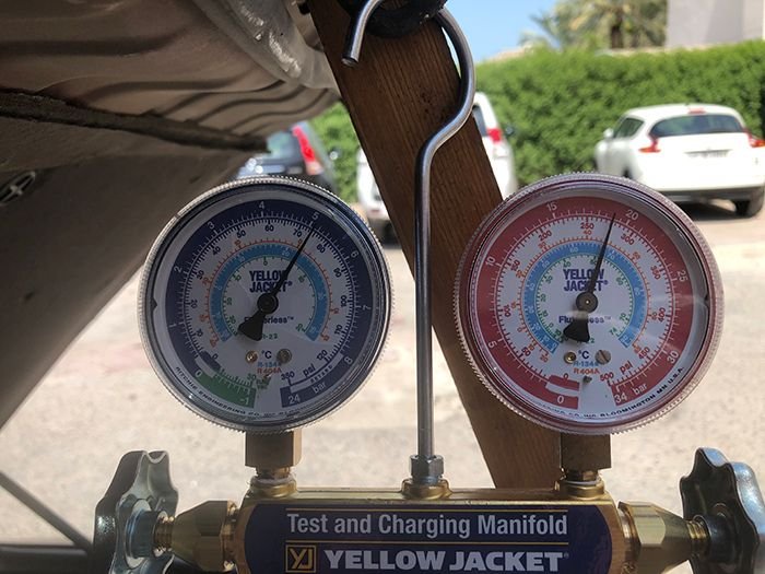

Hello everyone as the title says i need help with troubleshooting my ac problem , the ambient temperature is 53 Deg Celsius which is equal to 127 Fahrenheit , i checked the pressure on low and high side and found the following :
operating pressure :
High side pressure : 280 PSI
Low side pressure : 75 PSI
Static pressure :
150 PSI on both sides ( the pressure not matching with ambient temperature of 127 F ) Does that mean I'm low in charge ?
as per the Ambient Air Temperature-to-operating Pressure Table in Nissan service manual the readings for 104 Fahrenheit shall be as the following
high side : 176.9 - 265.4
Low side : 45.0 - 54.4
the max Ambient temp in the above table is 104 however the ambient temperature where I live is 127 Fahrenheit , the cooling from the ac is very minor and earlier i got better cooling till i got a leak recently , and replaced the evaporator along with the expansion valve .
kindly advise what could be the issue .
update 20th july 2020 :
i own another nissan altima 2015 model i took the reading today at 45 Deg Celsius ambient and compared it to my maxima readings and found the following :
Nissan altima :
high pressure :250 PSI
Low pressure : 31 PSI
Nissan maxima :
high pressure :240 PSI
Low pressure : 52 PSI
from the above results the low pressure of the maxima is 20 PSI higher , and the cooling is perfect when the car rpm is at 2000 rpm .
can this be due to over charge , or bad Expansion valve
i think the compressor is fine as the high pressure looks identical on both cars .

Pressure is too high, is your compressor coming on did you recently recharge it?

in addition the ac was doing well till the recent evaporator replacement along with exp. valve done at the mechanic i took the car back to him and hes claiming that i have a bad compressor :/ ( i doubt that i have a bad compressor as the high pressure side seems fine to me only the low side seems high )

yes due to refrigerant leak i recently replaced the evap along with the expansion valve and recharged the system at the mechanic .
with regards to the compressor ill confirm if it engage by inspecting it visually , however i think its engaging as the high pressure side is increasing from the static pressure of 150 PSI to operating pressure of 275 PSI mentioned above .
in addition i noted today that as the engine revs up to 2000 rpm the cooling is perfectly fine , when ever rpm drops cooling decreases .
further i own another nissan altima 2015 model it took the reading today at 45 Deg and compared it to my maxima readings and found the following :
Nissan altima :
Nissan maxima :
i think the compressor is fine as the high pressure is ok .

The correct refrigerant charge should be verified. 150 psi static sounds a little high.
And there is really no way to determine the charge accurately other than by weight.

I agree with MaximusN8. You seem overcharged! Too much of a good thing 74psi on the low side is too high (according to your gauges)

you were correct guys I vacuumed the refrigerant and refilled with the correct quantity, its way better now . Thanks for your support .
