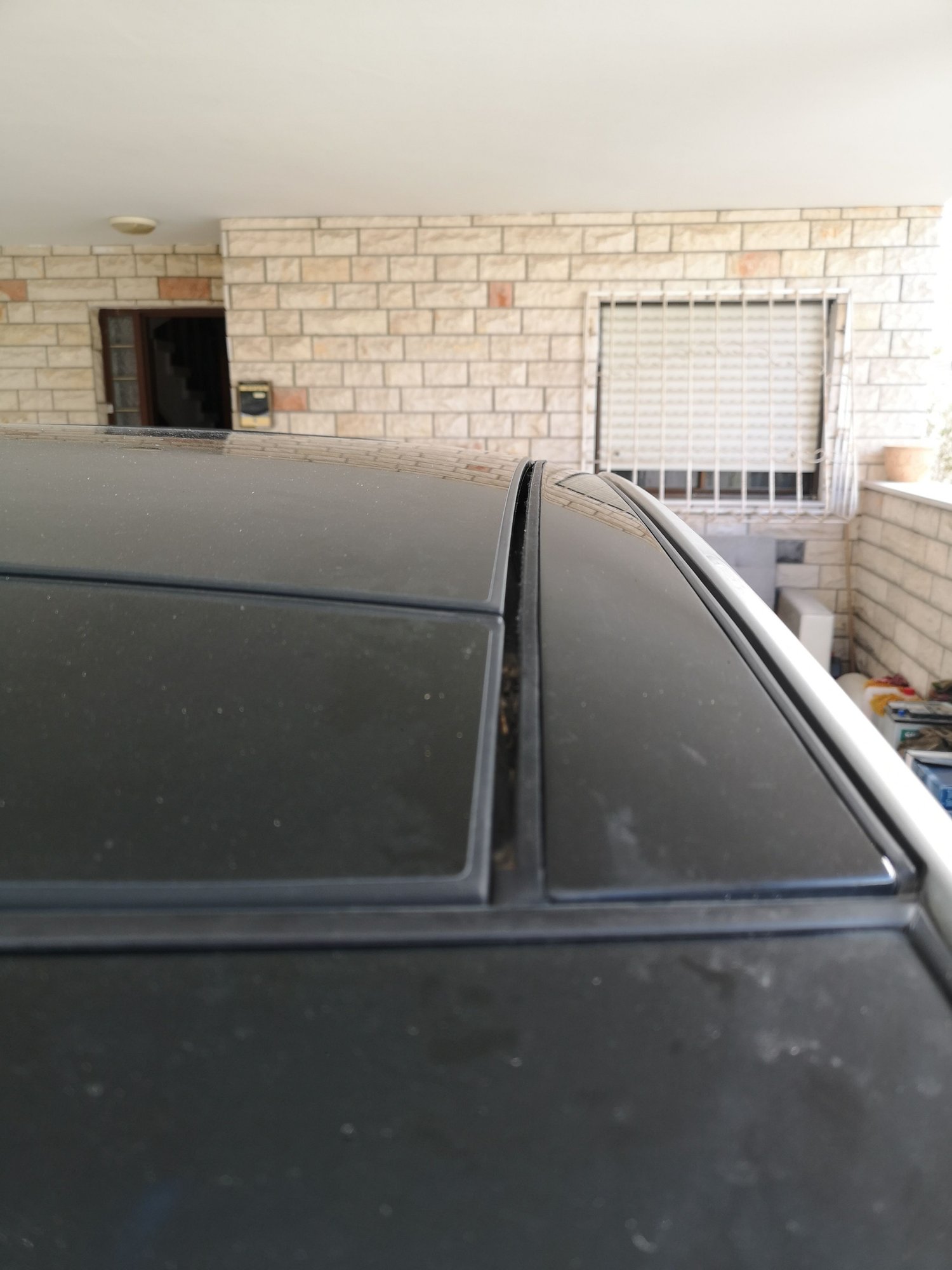

Wanted to share my recent mini project on my 2014 max (premium).
I just bought my max and I'm second owner. The car has 50,000 mi.
I don't know what the previous owner did or what he used for washing the car, but when I bought it the rubber trim on the glass roof was like this:
The rubber was very sticky - much like the butyl used to seal headlights..
After a short investigation I realized you can't replace only the rubber - it is connected to the black plastic trim...
Searched ebay to order the complete trim but to no avail.
Here in Israel they cost 1,100$ each side!!!
So I decided to preform a transplant surjery with a D shape rubber strip I bought from amazon:
I removed the dried/melted rubber and cleaned as much as i could...
After that I glued the D strip (wich had to be modified to accommodate the roof sliding mechanism) in place.
This is the result:
Total cost 25$ and for that price I'm happy with it.
Did any of you had the same problem?
Thanks for reading!

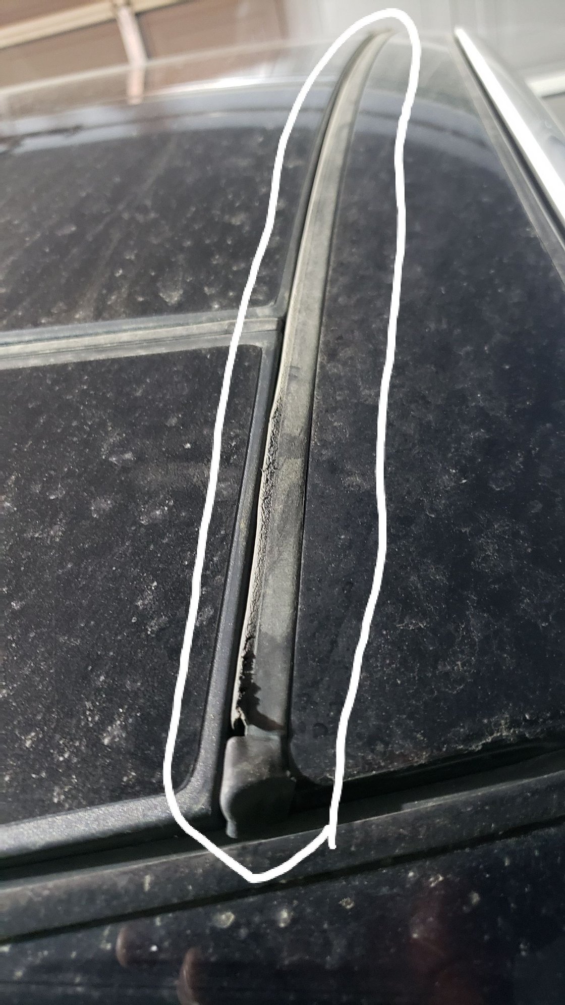

So I have the same problem(pics). I've tried and tried to find a replacement but no luck.. finally I ended up getting a set from a junkyard from Maryland. But when I received it, the weatherstripping was too stretched out this useless.. which D Shape seal did you use and what was the monitor had to do to have it fit. ??

Dual Panel Sunroof Weather Seal
I meant to say Modify.. but I think I found a solution to the problem.. rather easy one. "Flex seal"

Originally Posted by sivilyar
Please let me know how it worked out with the flex seal...
So the flex seal worked pretty well so far no leaks.. and it rain nonstop for 2 days here. Just remember to tape the edges really neat and peel the tape towards the seal as soon as possible.. but overall its good. Ill post pics soon.

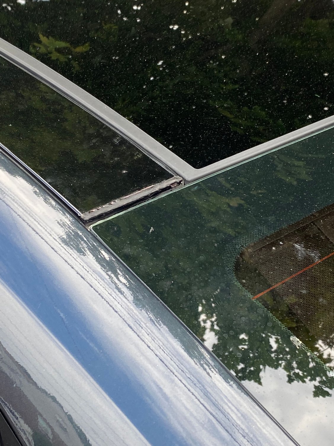

I woke up this morning and found that because of the excessive heat this summer the molding around my roof is starting to deteriorate. I went to 2 different dealerships and my mechanic and I was told that all they could do was replace the trim. $$$$$$$. I went to autozone and picked up some J B plastic bonder. I will let you know how it turned out.
Old Jul 28, 2022 | 06:04 PM
Maxcar's Avatar
Joined: Jun 2019
Posts: 80
From: NYS
So the J B plastic bonder worked well. It coated the trim and now its a solid piece. My only regret is that I applied it with the stick applicator and not a small paint brush. I think if I had painted it on instead I would have been able to get a thin layer. Over all its not too bad. Definitely better than the dealer replacing part at their price.It does not look to bad. I can live with it until I have to replace. I will upload pic tomorrow.
Old Jul 29, 2022 | 07:47 AM
Maxcar's Avatar
Joined: Jun 2019
Posts: 80
From: NYS
I have to repaint the fix. I initially used a black marker that left a really weird copper brown hue when you looked at an angle. I repainted it with non gloss model paint and its looking alot better. I will apply 1 more coat.
