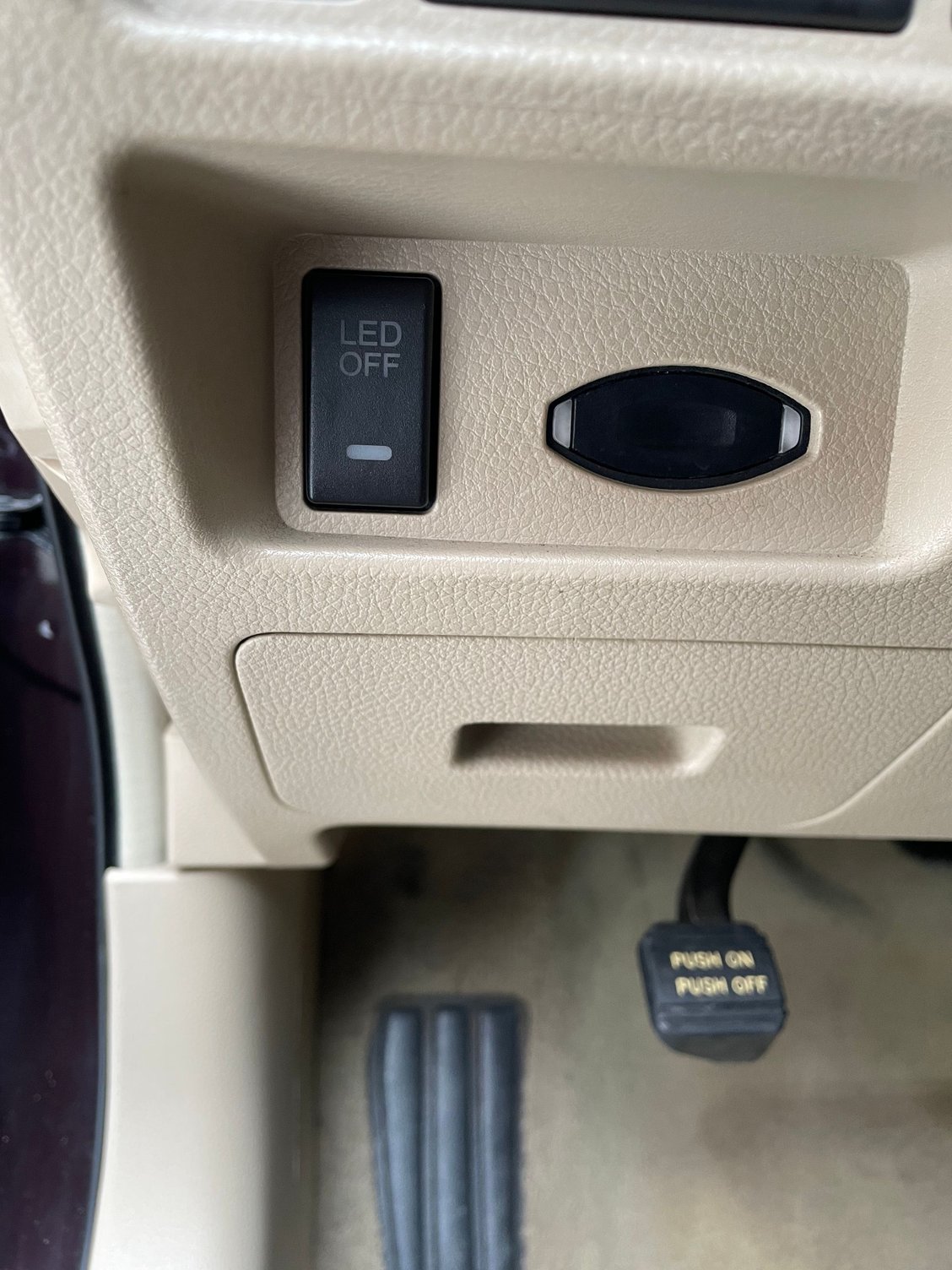

Hello everyone,
I am new here. Do you have pics to show how to install fog lights on a 2014 Nissan Max S?
Whats is completed already
1. Fog lights installed in the bumper and already connected to pre-wired harnesses.
2. Fog light switch inserted in the slot below steering wheel only.
I need help figuring out how to connect the switch that is under the steering wheel to turn off and on the fog lights already installed. My steering wheel turn signal does not have the fog light option on it. Can anyone help on how to hook this up, please?

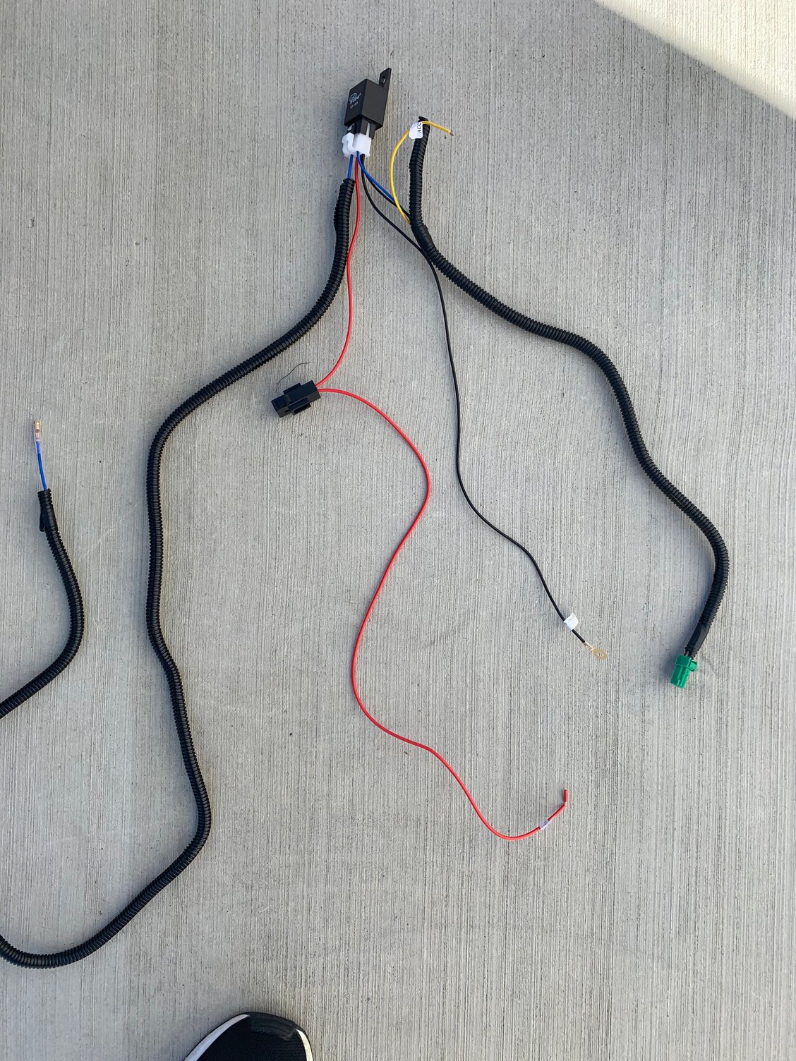

Wires I have
Ok this is what I have. Sorry not a electrical guy here.
Can't tell what your wires are from the pic, but basically follow the diagram nopike posted. The relay should have numbers on it like in the diagram.
1) Connect the foglights to 87
2) Connect a ground wire to 86 and ground it on a screw somewhere with an unpainted surface or to the negative battery terminal
3) Connect 30 to positive battery terminal (with an in-line fuse) or get a fuse tap and tap into the fog lamp slot
4) Connect a wire to 85, run the wire into the interior, connect one end of the switch to it, then tap the other end of the switch into a fuse in the interior fuse box. I'd tap into something that's only on in the ACC On position, like heated seats.
Basically what's happening is the relay switches on when it gets power, so it'll get power from the interior fusebox if the switch is closed. When it gets power from the switch, the relay connects your lights (87) to your battery (30) so your lights get power. When you open the switch, it'll cut power to the relay and the disconnect the power to your lights.
The interior fuse box is by the OBD2 port, just pull this door off and you'll see it. My guess is the kit didn't come with fuse taps so you might need to get some.
