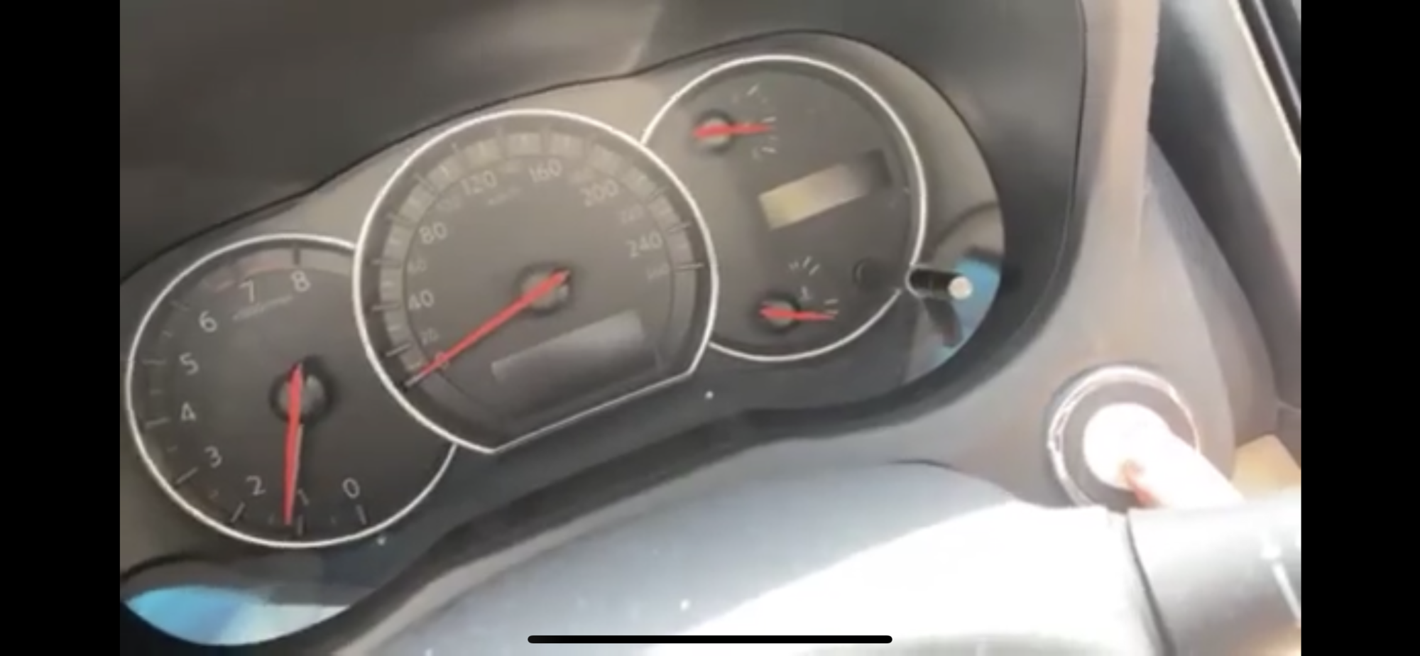

i have 2014 Maxima and when I switch off the car the fuel needle and rpm is staying at the same level when the car switch on, also the odometer turn to zero each time I turn off the car,
these problem started with me when I wash the engine via steams
The car is switched off but the rpm and fuel is up
