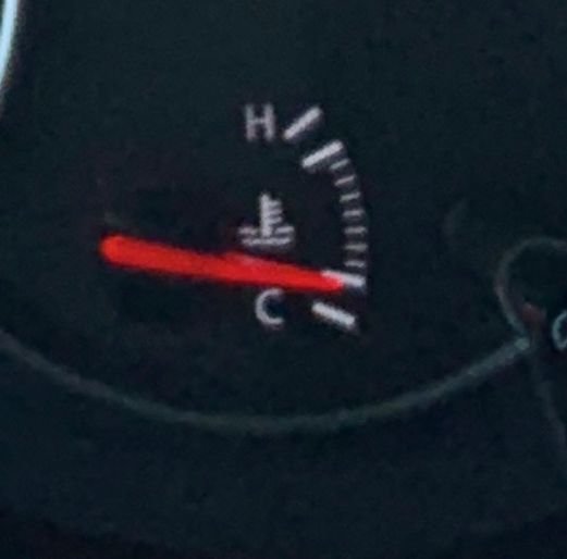

Hi all.
I have a 2014 Maxima and my coolant gauge is always stuck at C. Whether it's a cold start or I've driven it for a couple of hours straight it's only stuck on this position. Is this normal? If not, what can I do to fix it? Thanks!
edit: to add, I bought this used a couple years ago and it's been like that since I bought it. The fans do turn on when the engine gets hotter.
Coolant gauge stuck on C
Old Nov 8, 2021 | 12:29 AM
I35GEEK's Avatar
Joined: May 2019
Posts: 258
Driving our cars for a few minutes will raise coolant temperature. My guess is a faulty coolant temperature sensor. Should be cheap and easy swap out with a new one.
