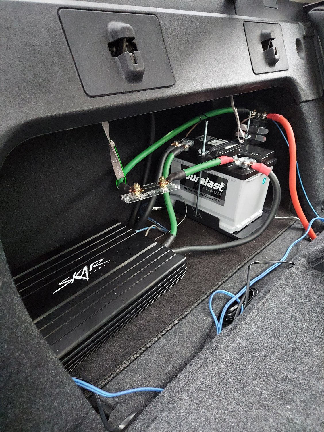

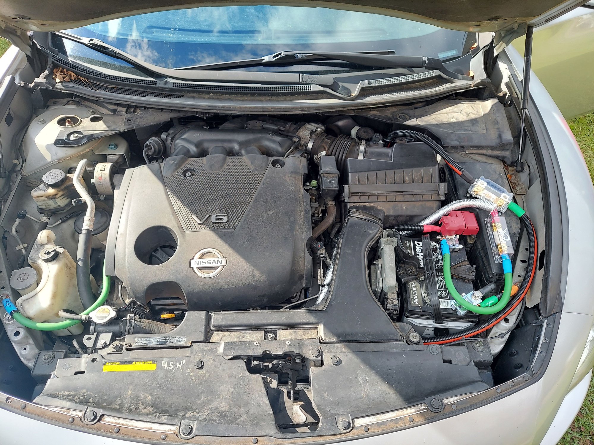

. Hope you had a safe and fun new years eve. I didn't do ****. I leave for Florida today. So I checked my batteries with my new multimeter. So that digital gauge is spot on. With the car off they were around 12.65. With the car running the front one stays above 14 for a few minutes than sits around 13.1 and 13.5. sometimes sits higher with everything off. The back one concerns me too. It wasn't even at 13 volts with the car running. I'm assuming my isolator is working and the back battery is constantly getting cut off from the alternator due to the front battery being low. Also I tested all my grounds. Spot on. The amp ground is 0.01 ohm and the engine and battery ground to chassis stayed at 0.00. I did it 5 times to be sure. Lol. When I get back in town I'm doing the JS alternator. Nissan said they'd install it. Also put new control arms couple days ago. I'm hoping this 400 mile drive charges my batteries. Oh yeah, I installed the equalizer yesterday. Dude, it's hitting so hard it gave me anxiety. Lol. Sounds so much better. I wasn't even sending half the 6 volts the amp can take back to the amp before. Sorry this was so long.

Nice job with the EQ! I was hoping to get a report back from you about that. You were right on about using it as a line driver. As for your alternator, it's on it's way out., With the car running, the entire system should be energized to alternator set point voltage, which should be around 14.7V. You're ok for now as long as you're above 13V. You can test the alternator output voltage at the B+ terminal, which you can reach with your multimeter, then ground the meter anywhere. I would check that as well. I'm in Tampa, and it's nice but humid. I worked last night, so you're not the only one who had an uneventful evening. That multimeter is pretty nice. I wonder what kind of current you draw to the rear battery if you ran a 40hz sine wave full tilt? You can clamp now...

. You're in Tampa? So am I. That's where I came on vacation. I'm from here. I'm staying in carrolwood, but at my sister's now for the day . Off Hillsborough and Florida. Small world. Yeah I've already committed to the JS alternator when I get back. Can't decide if I should just get the 390 amp. The 320 amp is $400. The 390 amp is $470. Would you just get the bigger one? I'm thinking to go 390. Like always thanks for the input. I will test the alternator. It only has about 700 miles on it. 440 were from this trip alone. It's pretty new. It's a WAI Global alternator. Best one rock auto had. 130 amp. I thought for sure it could handle 1500 watt amp. There's a lot of electrical **** on this car though. That's what I read. That's why the 130 amp. Anyway. Also you don't think having the 1 awg power wire from alternator to battery on top of the factory one is maybe part to blame. It's supposed to go on the alternator first ,then the factory. I know we talked about this already, I'm just surprised my alternator is struggling like this.

130 amps isn't a lot, I would get the 390. I don't know exactly what's going on, but with your batteries charged up you should see around 14.5 volts or so. 13 is too low. I would check the voltage at the alternator with the batteries charged. The 1/0 wire connection on the B+ post makes no difference how it's stacked with the factory cable. I forgot your alternator is new. I would send it back if it wasn't putting out 14.7-ish.
