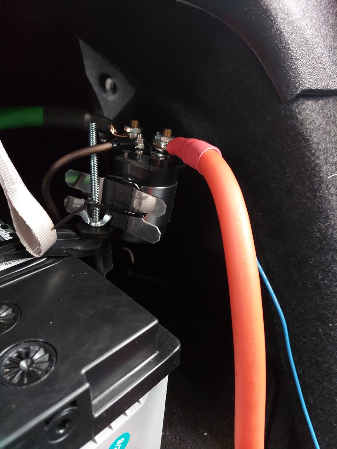

Yep. Just do the same thing you did with the switched lead for the isolator. I would even use the same lead, just tap into it somewhere. Whatever's convenient.
Old Dec 17, 2021 | 03:06 AM
Grady09SV's Avatar
Joined: May 2021
Posts: 92
From: South Carolina
Great idea! I'll just tap into the wire. Didn't think of that Well I have to unfortunately get ready for work. Ttyl

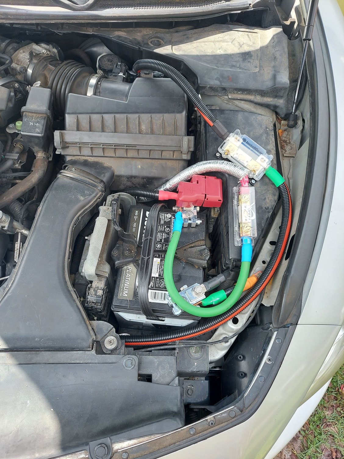

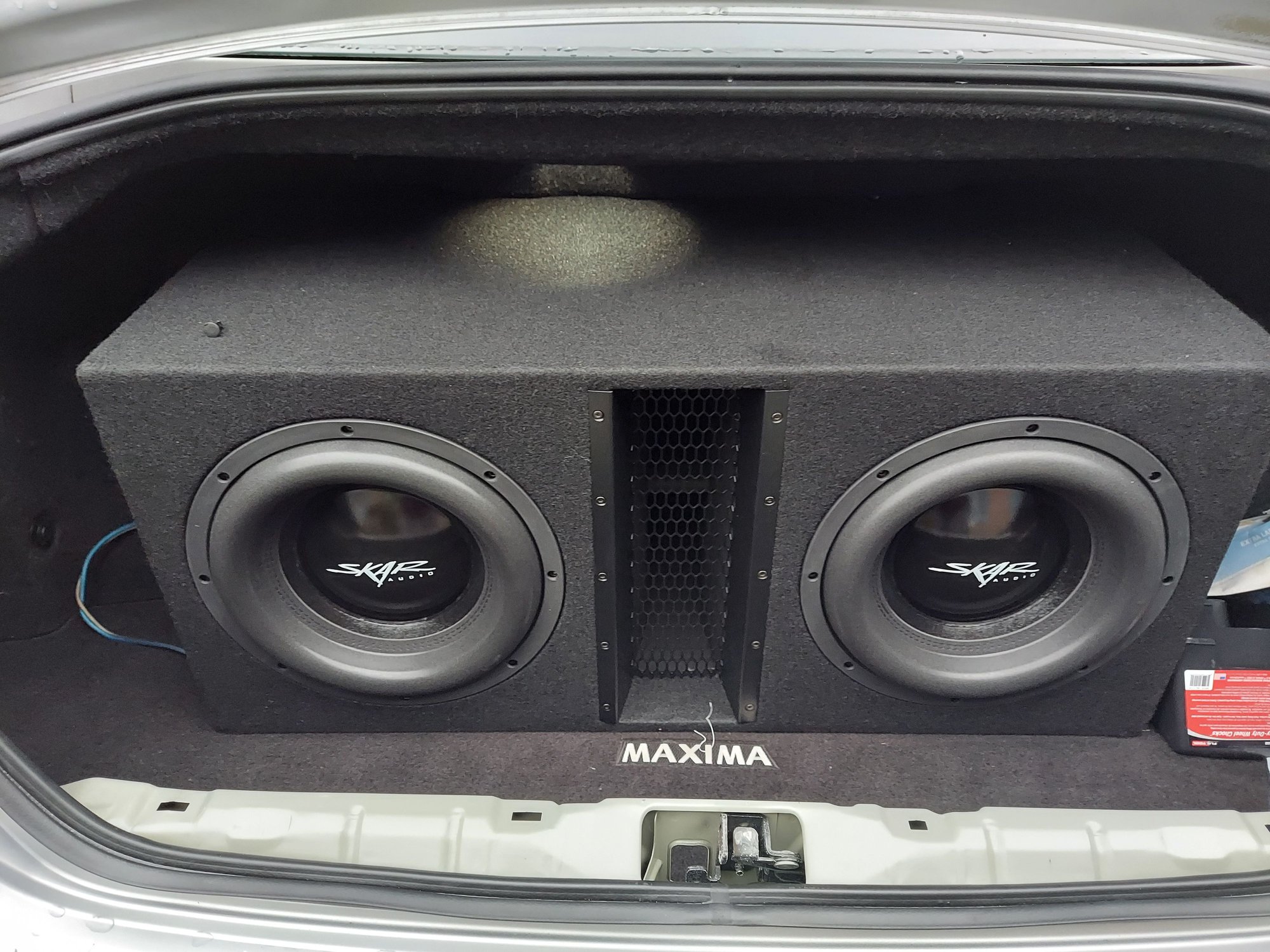

I accidentally sent some twice but that's what I got. Hits pretty hard. Tuned it today with an O- scope. The $50 one on Amazon. Lol. Works great. I need to wipe down the engine bay. Figured I'd throw in all the LED upgrades and a pic of the outside.
Old Dec 19, 2021 | 02:30 PM
User1's Avatar
Joined: Jun 2018
Posts: 2,493
Looks good! Is the rest of the stereo stock? If so, how well does it keep up with the subs? Nice work with the O-scope, which one did you use? I have this one
Amazon Amazon
Good job with the grounds. Should keep noise down. May as well pull your rear-view now, it's going to fall off anyway Lol
Looks good! Is the rest of the stereo stock? If so, how well does it keep up with the subs? Nice work with the O-scope, which one did you use? I have this one https://www.amazon.com/dp/B074QBQNB7...v_ov_lig_dp_it
Yea it aims at the back seat. Lol. Won't stay up. I used this one. It works great. The Bose speakers are pretty impressive. The volume maxes out at 50. Bose speakers didn't clip till volume 46. They don't drown out. It's definitely sounding better. I only have about 3 hours on the subs. Only gonna get better. I figure next summer I'll get a high output alternator and a bigger amp. Already asked Nissan if they'd install it for me. Said yes.

Right on! Lots of fun! Where does that voltage gauge to the left of the steering wheel tie in to? What is your voltage at the battery terminals?
Old Dec 19, 2021 | 04:49 PM
Grady09SV's Avatar
Joined: May 2021
Posts: 92
Not sure at the terminals. I have another one of those voltmeters. Maybe I'll hook it into the battery. Maybe just to check. The multimeter I have sucks. I need a better one.
The one by the steering wheel is tapped into the wire coming out of the fuse box going to the isolator in back. Ground under the kick panel ran up through the steering wheel column. I also think I'm getting low voltage from my preamp outputs. The head unit manual says 4 volts but I'm having to turn the gain way up compared to when the factory unit was in. I bought a line driver but I'm still on the fence. Any suggestions?
