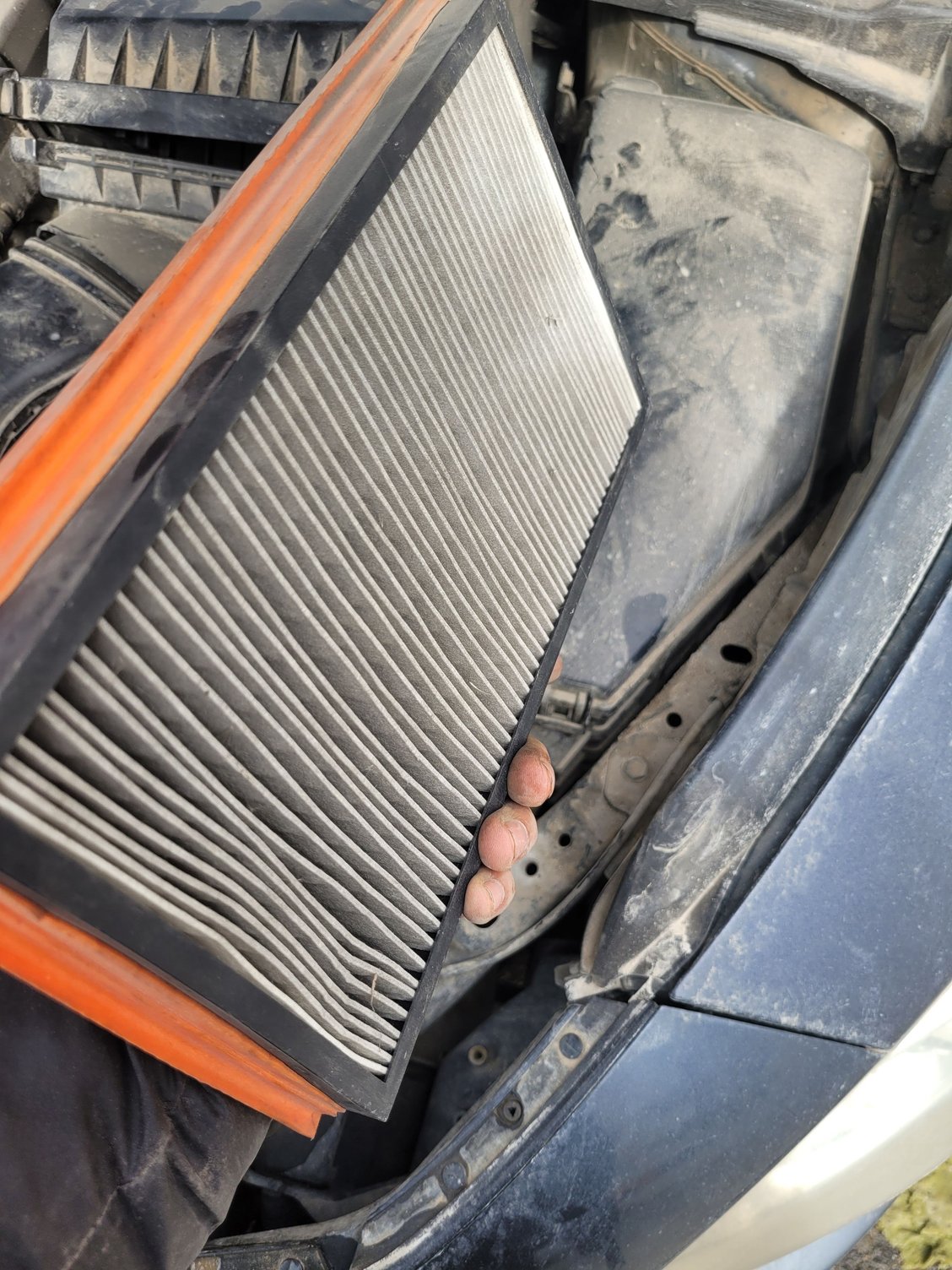

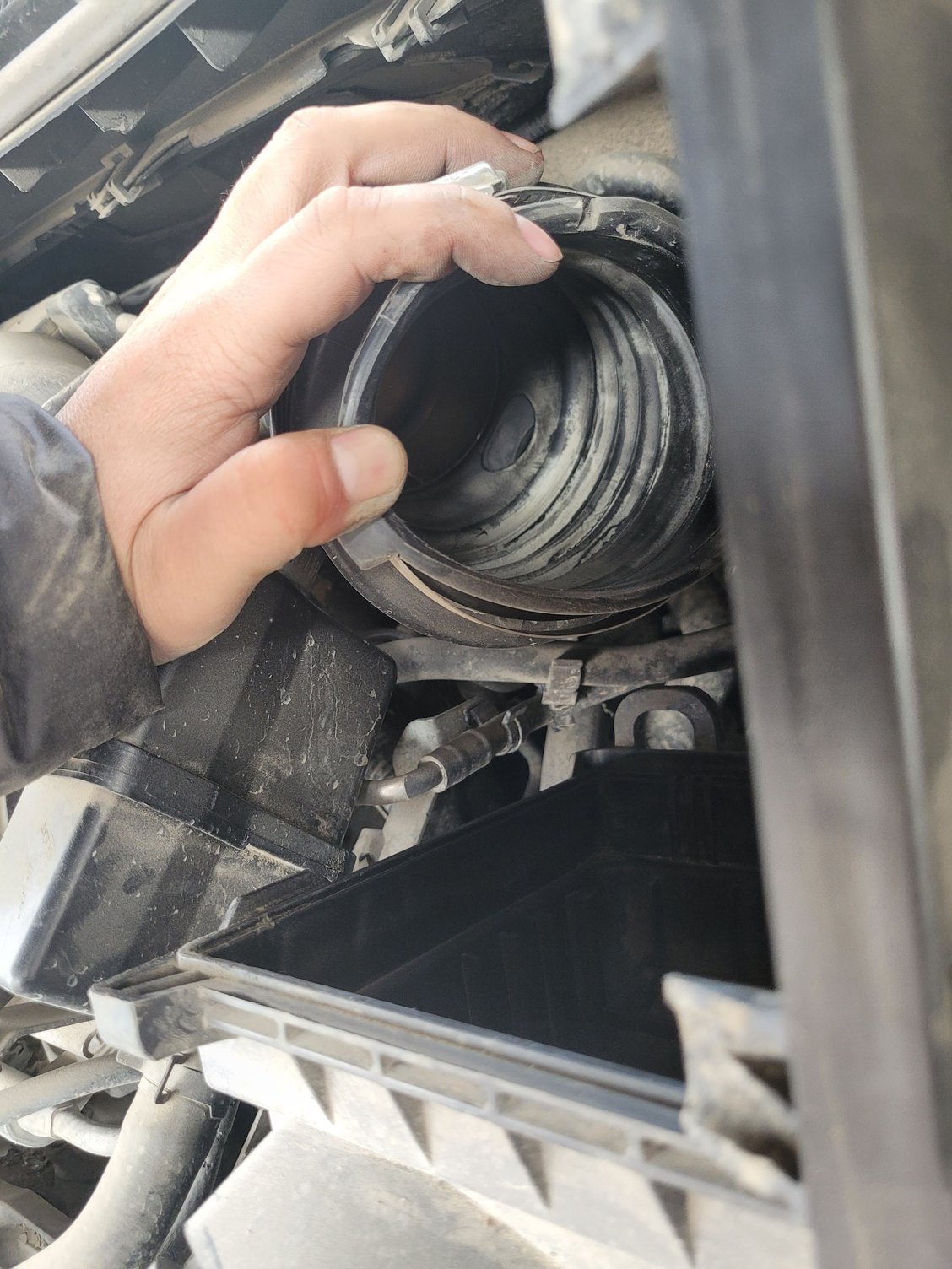

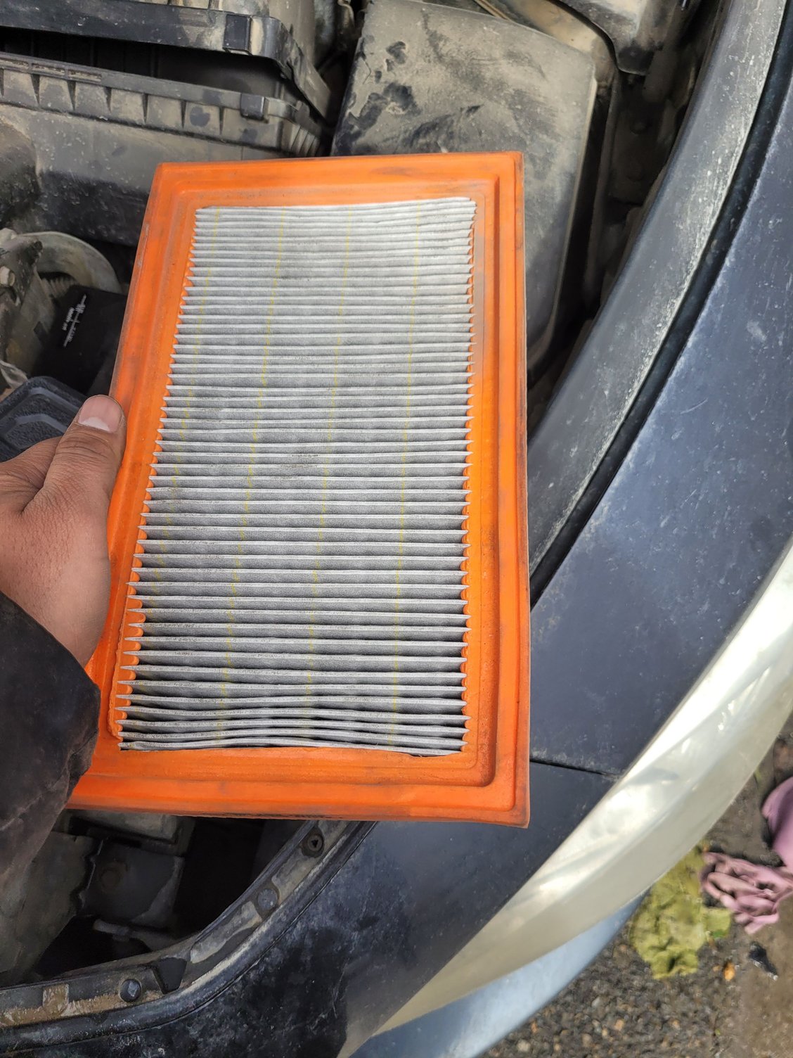

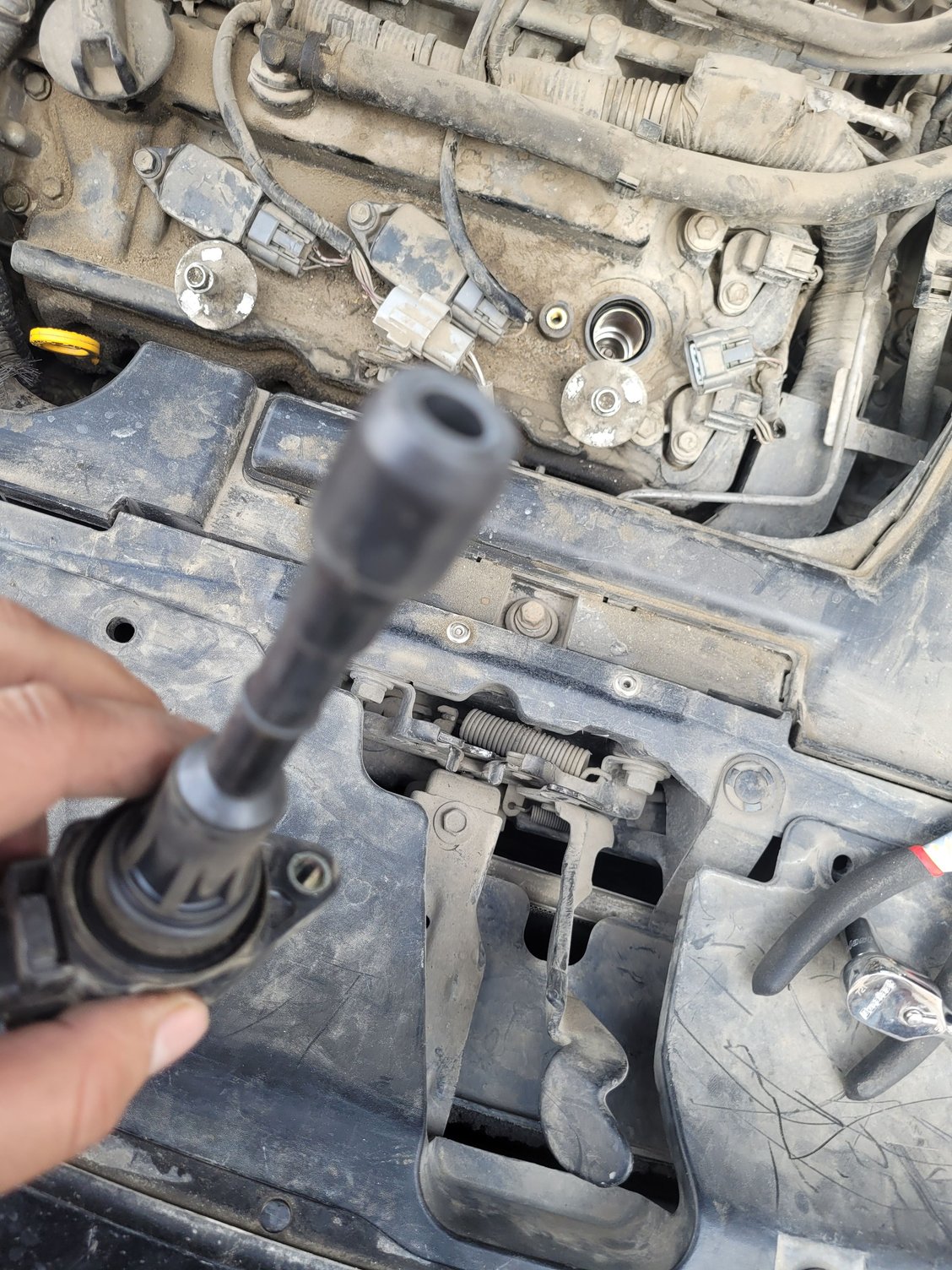

2009 Nissan Maxima. Hello Guys I really need your help. Yesterday morning on my way to work I went over a large puddle ( at a high speed) and engine was running fine until I stopped to make a left turn at a traffict light. My engine shut off and would not start. ​​​​​I have checked air filter ( it is completely dry) same goes for the 3 front sparkplugs, maf sensor and throttle area( completely dry) . Now as far as the oil I have checked it 3 times and the level seemed to be higher than normal. I have not started since yesterday morning waiting for it to dry. Any suggestions would be greatly appreciated 👍
Old Feb 24, 2023 | 09:30 AM
LtLeary's Avatar
Posts: 1,847
From: Central Florida
Sorry to hear of your issues, but can you clarify a few things?
When refering to "car won't start" issues it helps if you say something like "it cranks but doesn't start" or "it wont turnover."
Did you check for codes? Are there any?
A quick down and dirty test for fuel is to put a squirt of starting fluid in the throttle body. Does it start and die?
If not we check for spark. Pull a plug and see if you have spark while cranking. My father thought the best test was for me to hold it while he cranked...i dont recommend testing like that!!
By the way, that is one nasty air filter and that engine looks like it lives in the dusty clay of Missouri! We are a sensitive bunch here

Thank you I will try that! If it helps it was reading this code p1800 before I went over the puddle.

I dont see a p1800 (a problem with a vias control solenoid/circuit) causing a no start (crappy idle/running maybe) according to Alldata that is!
P0300 is a generic code for misfire so fuel/spark/cam timing is suspect. If it was limited to a specfic cylinder you would see the cylinder listed as P0301 for #1 cylinder, P0302 for #2 and so on
Please let us know how you fare.
