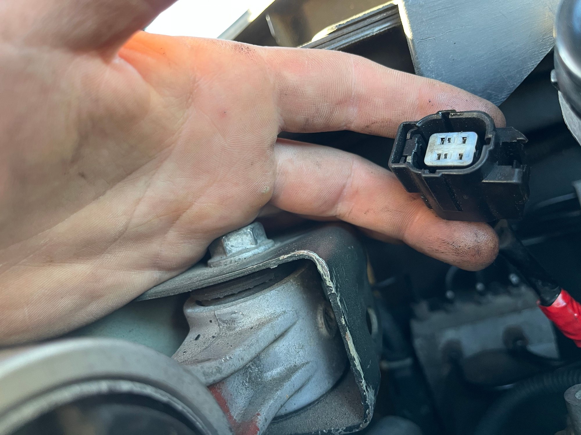

Where does this plug go
I have this plug on my 2010 maxima that is unplugged is this an extra or where does it go it is on the pulley side of the engine behind the intake

I am guessing here but upstream O2 sensor?

Any code shown? Am always in that area and don’t recognize that plug…. Will check

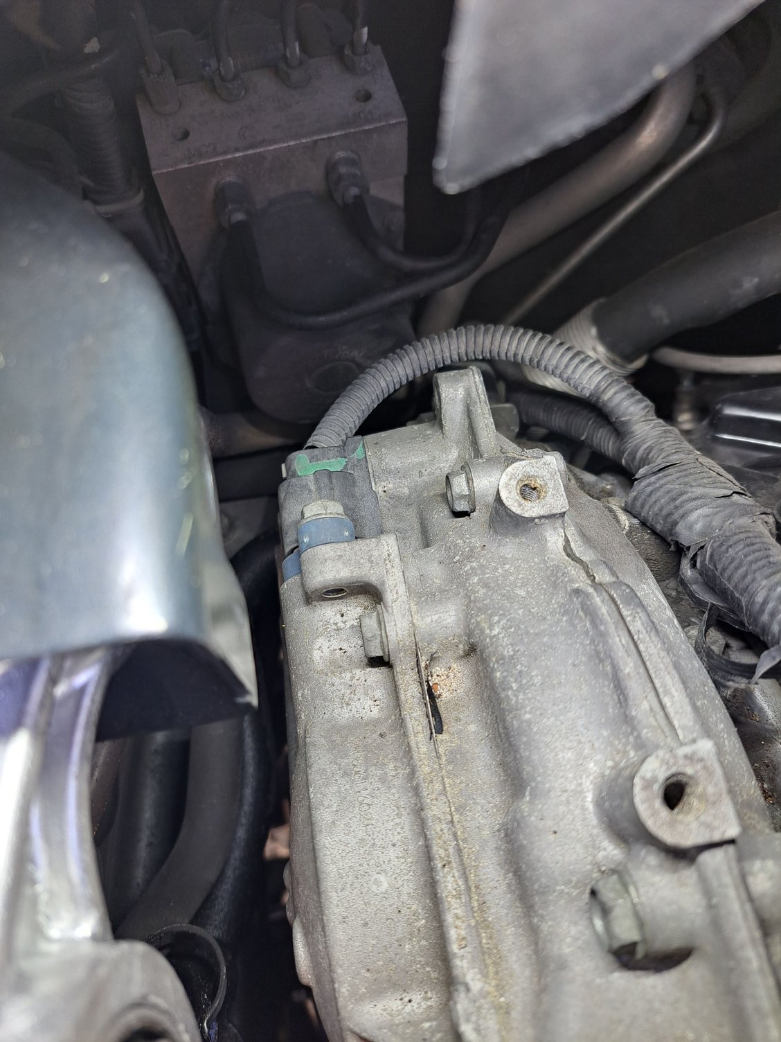

About the only plug I see down there is going to the intake Valve Controller for bank 1.
By the green paint

X2 @LtLeary also behind the silver band on the hose, another plug back there. The style of your harness plug looks the same in his picture
