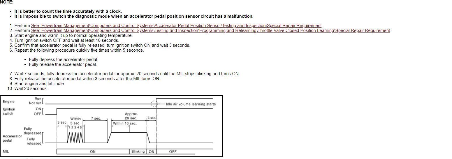

Sorry, sometimes I forget that folks don't know what I mean!!! The easiest way is with your scan tool. Most that I have used can show MAF response/voltage. If not, a pico scope is a great tool too. You have 4 connections. 12Vdc, Ground, 5vdc and Signal. Now here is the part I don't like...you have to use piercing probes to connect to the wires. Not a big fan but hey, needs must. Your voltage at Idle should be around 1 to 1.5 vdc. At 2500 rpm you should see it go up to around 2.5vdc. The key here is the more air moving across the sensor the more voltage is put out. If all looks good (particularly after cleaning the MAF) perform the idle relearn.

I'm not so good at diagnostics but FWIW I recently did the idle relearn when I had a slightly rough idle and it helped.
