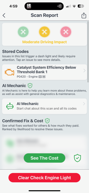

I have the FIXD car code reader. Stopped the car and let it run to read the codes, It came back with the code "P0420" with the description "Your catalyst system reduces the amount of pollutants in your exhaust gas. This error means your car may be polluting more, but it poses no direct drivability issues. However, this can be a very expensive repair (`$2000) if the catalytic converter goes bad because of this.
Screenshot :
Of course I'm worried about it now, drive it right back and he was asking what code was it? I showed him the screenshots from the App and he was like oh don't even worry about it. It's just a senor that needs cleaning, I'll get it sorted out for you, I'll let you know when you can bring it back in and I'll handle it out for you, Totally safe for you to continue driving now. Plus seeing the description on the app saying "but it poses no direct drivability issues" I was like alright, He'll take care of it later so I just let it slide to come back later a day when he's able to look into it.
Fast forwarding 2-3 weeks ahead and driven about 600-700 miles since. I've started to notice a few things, Like the mpg won't go up anymore it's constantly only on 19.5 mpg - Usually I can see it go up when I'm driving calm and steady with slow acceleration and cruising it goes up to 20.5 or so. Lately it's been stuck on 19.5 no matter how I drive. Furthermore, I noticed the burst of acceleration is no longer there, the feeling of being pushed against your seat when you push the gas pedal? It was more slower with the acceleration in comparison. All of this started to make me wonder what's really happening.
What tripped me off was now when I'm parked on 'P' the idling needle would no longer be constant but it would keep shuffling between 850 - 1100. Just going down or reving a bit higher and kind of lingering in between. The 'Service Engine Soon' light has been on this whole time though. I decided to plug in the FIXD scanner one more time to see if the code is the same, To my surprise I do have 2 codes now. Screenshot below :
The initial "P0420" and now the "P0101" Which has to do with the 'Mass Airflow Circuit / Performance" When i read into the details it basically says the sensor does not know how much fuel to put into the engine and this may cause the engine to run poorly. Which perfectly makes sense with the dropped mpg, the rough idling and low acceleration. Alarmed, I drove back to the guy and he was just like Oh don't worry everything is good friend. We will get it all sorted out for you next week, Bring the car in and give it to me for 2 days and I'll fix everything up looks like just some sensors need to be cleaned. I'll clear everything up.

Your story was long, but easy to follow. to the Org. What you're dealing with is a snake. He intentionally reset the codes so it would drive well and pass inspection, knowing full well that the check engine would come back on. He sounds like a real smooth talker.
I doubt cleaning the MAF will do the trick. Cleaning the MAF usually only buys you a short time like a month of better acceleration. If I was in your shoes, I'd ask him to replace it on his dime with a good used OEM MAF (I'd pass on a New aftermarket MAF, you want OEM).
And he needs to sort out the other code too, on his dime. You either have a clogged cat, or a bad O2 sensor. Both will cause sluggishness that you described, mostly a clogged cat will though.

You made a deal with a snake, Wiz is absolutely right. He reset the codes to get the car off his hands. A lot of these snakes get away with this because you sign the bill of sale purchasing the vehicle as is, which protects the seller. I hope he repairs the issues your having, but something tells me he's not going to honor this as he didn't invest to make those repairs before selling the vehicle. My parents dealt with a serpent like that a few years back and it never amounted to anything. They lost out in the end because the seller had on the bill of sale sold as is. It sickens me that this happens.

From Reading your original post, my inside the shop opinion is that with 145k from what I read, he seemed like a motivated seller. Either way you like it and it's at a point where maintenance is needed, fix It and roll on. I stress this to my customers always. I see people buy all kinds of piles of trash after the fact sometimes. Without having A used car inspection done first at a shop of your choice, not the seller. Your car appears in great condition however you just need some maintenance items and its to be expected. These are somewhat normal things I see on a daily basis. If he is willing to repair the car roll with it and let him. Have Nissan check behind him though. What needs to understood is that you bought a used car, not a perfect car or New car. A Nicer used One that can be repaired and needs to be maintained as well.
Reading further down at what Nissan said. Often times I find the air boot busted just under the TB. If you don't pull on the boot you wont see it and with a broken torque strut often times as the engine rocks back under accel it pulls the boot open, causing drive ability issues, meanwhile the car idles just fine sitting still. It's a inexpensive part these days and are cheap to install. Have that checked. If the air boot is not broken then I would suggest replacing the MAF first. It need's to be OEM Nissan and flashed. Clear the codes and roll on and if you continue with the P0420 codes the Cats are next. I use the OEM Nissan cats, They have come down in price substantially over the years. I have done several and what I'm truly seeing these days is a high cat failure rate on all cars and red spark plugs on everything. The Ethanol is killing cats and cars it seems. Have the plugs pulled and checked as well. The engine running poorly is the Main Concern, first .
Doing the OEM cats will run you about 1900 if they are determined stopped up which can also be checked. In the shop I use an exhaust back pressure tester which I use to determine the flow rate of the cat at a sustained rpm. Inlet and out let. A converter's threshold for a failure is only 5%. My biggest suggestion to you however is if you cant do the work yourself or you don't trust he will do it correctly. Take it an Independent shop in your area that does Nissan. For a 2nd look.
The Oil leaks are normal. This is something you'll need to keep checked often as well on your end.
The parts list you listed can all be sourced for fractions and installed.
Get pep boys to install the outter tie rods Only and sign up for lifetime alignments. It pays for it self. Normal Stuff somewhat. Nice Car, Enjoy it.

Back to the main point, Since I cleared the codes the 'Service Engine Soon' light went away immediately. Here's where it's a bit confusing. I've been gentle with the car knowing the issues and codes it's given me before.
- I've driven about 56 miles since I reset the codes.
- The acceleration is back and efficient, Really picking up and pushing me against the seat again
- Idling isn't jumping around too much, It's just a slight movement based on the AC motor working maybe 900-1000 rpm in between.
Makes me wonder maybe the Cat is okay? Just the sensors are bad? Resetting the codes have set everything in order again. Usually I thought after 50 miles the codes would come back, But I'll keep driving to see when the codes come back and see if there's a drop in performance after the codes appear.
What's your thoughts on that? Thank you again for your time and help!

I think it's too soon to tell. 56 miles isn't much. There's so set in stone rule about 50 miles to reset the monitors etc. While I hope that the codes stay away and your idle and acceleration stays strong, something tells me you'll report in the next day or so that your codes and issues are back. Now that you reset your codes again and driven 56 miles, check to see if it says that all your monitors are ready.
Still going strong - But I'm not sure if the idling is supposed to shuffle around a little (is that usually normal?) I can't seem to remember if that's how it was usually, I've never cared to notice the idling ever before in a car haha Can't believe I'm super keen on it now since the codes ever came on etc. Acceleration is still pretty good so far, mpg Is changing based on the way I drive 19 - 20.5 mpg etc Will wait for the codes to show up!
I don't know if the FIXD app can check if the monitors are up and ready? I'll give it a shot and see what other info it shows on the app. I'll keep you guys posted! Yet again, thank you so much for being active and responsive with helping me out. Really appreciate that!
Hey Wiz! I've driven about close to 200 miles now. No engine codes yet, Acceleration is up and ready to push me against the seat. However, the idling RPM is a bit shuffling at times. Cold start does kick up to 2000 RPM for a bit until it calms down to 1000 RPM - But then, keeps shuffling a little between 950 - 1000 rpm and drops a little when the AC motor kicks in and out. Is that Normal? I've read a lot about it - Everyone's like clean out your MAF sensor that should fix it, I haven't cleaned it up yet - Waiting for the day the guy wants the car back to fix all the issues together (He postponed to next Monday now) So let's see how that goes.
Overall, still going strong with the acceleration and no codes back - What's your thoughts on that? I've read somewhere Nissan takes 200 miles to reset? I'll have to see if codes come on after 200 - Let's see!

If the MAF dose not fix it then i would say its the CAT. i had p0420 on another car alone and it was the cat causing it. Good luck!

Hey OP, just skimmed the thread and hopefully 2 months later you've resolved your issues, but if not, 2 things:
1) Not sure if anyone mentioned this, but usually after disconnecting your battery, the MPG will fluctuate for some time until the car "learns" your driving pattern and settles on a baseline MPG. This could be why you saw it improve with more gas efficient drives and then later it stopped changing.
2) There is actually a service bulletin for that specific MAF code, P0101. It is an issue that needs a procedure that will have to be done by Nissan service. I had the same code with similar symptoms, and after cleaning the MAF and replacing it with it still coming back clear after clear, I went to the dealer and they fixed it. That was 2 years ago now I believe, and it never came back. Hope this is helpful!
