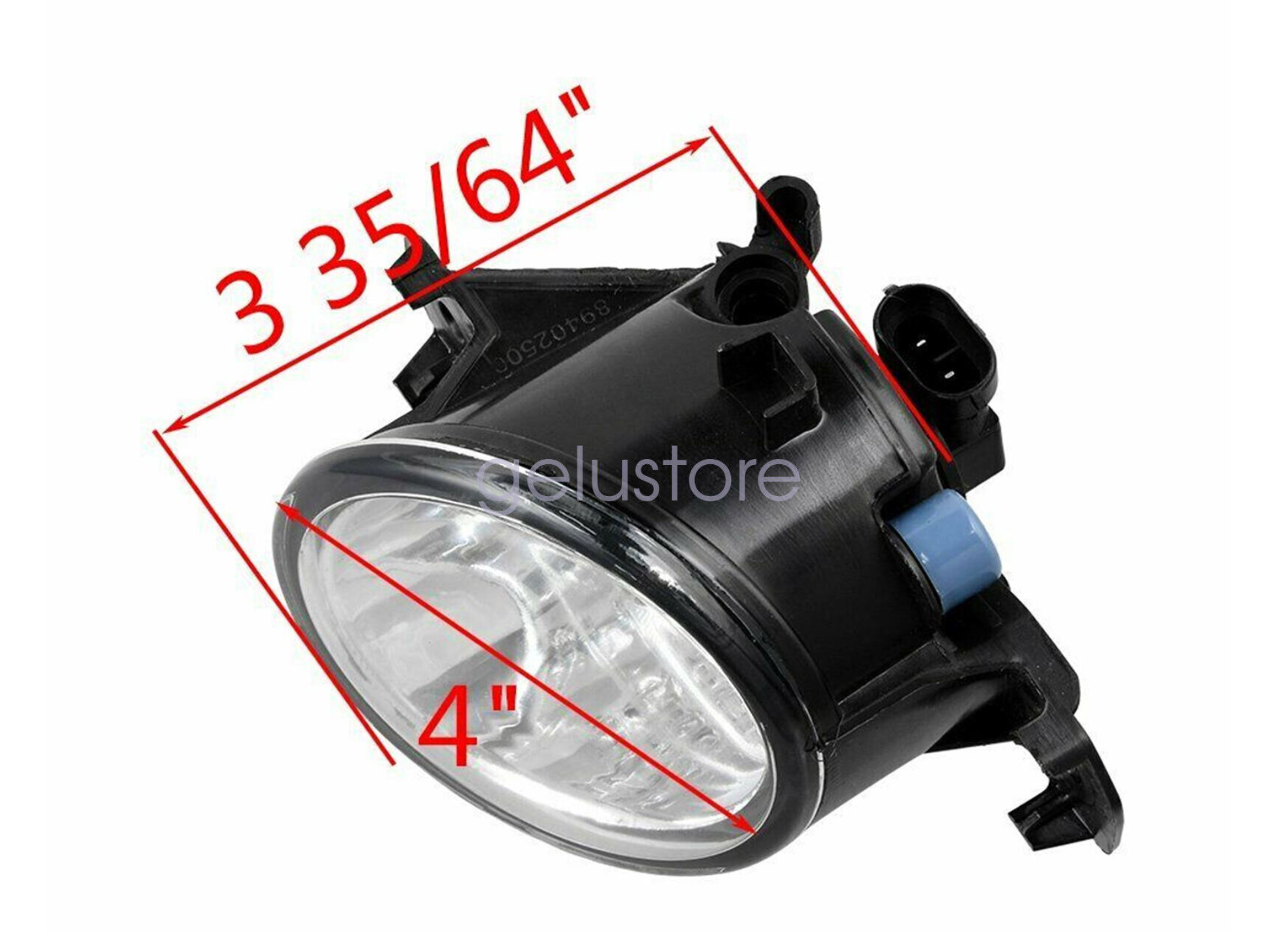

I own a 2010 Maxima SV that did not come with factory fog lights. While changing out the headlights, I noticed I had the plugs to connect the fog lights and seen the screws to take off the grill to place the fog lights in.
I just purchased LED fog lights but when I went to plug them in, they won't turn on with the low beam or high beam lights. I thought it could be a burnt fuse but that was not the case as the fuse was fine.
To rule out the LED lights being faulty I plugged an H11 bulb into the fog light socket and that also did not turn on. I was in a rush so I didn't have time to check for voltage from the socket but is there anything else I need to do or am missing to get the fog lights to turn on?
I saw online that if your Max came with the sockets, it was as easy as plug and play but that is not the case for mine. Anything else I need to do? Do the fog lights I purchased need something else to connect to for more power? Is there any reason the sockets are not working given the fact that nothing was ever plugged in there?
