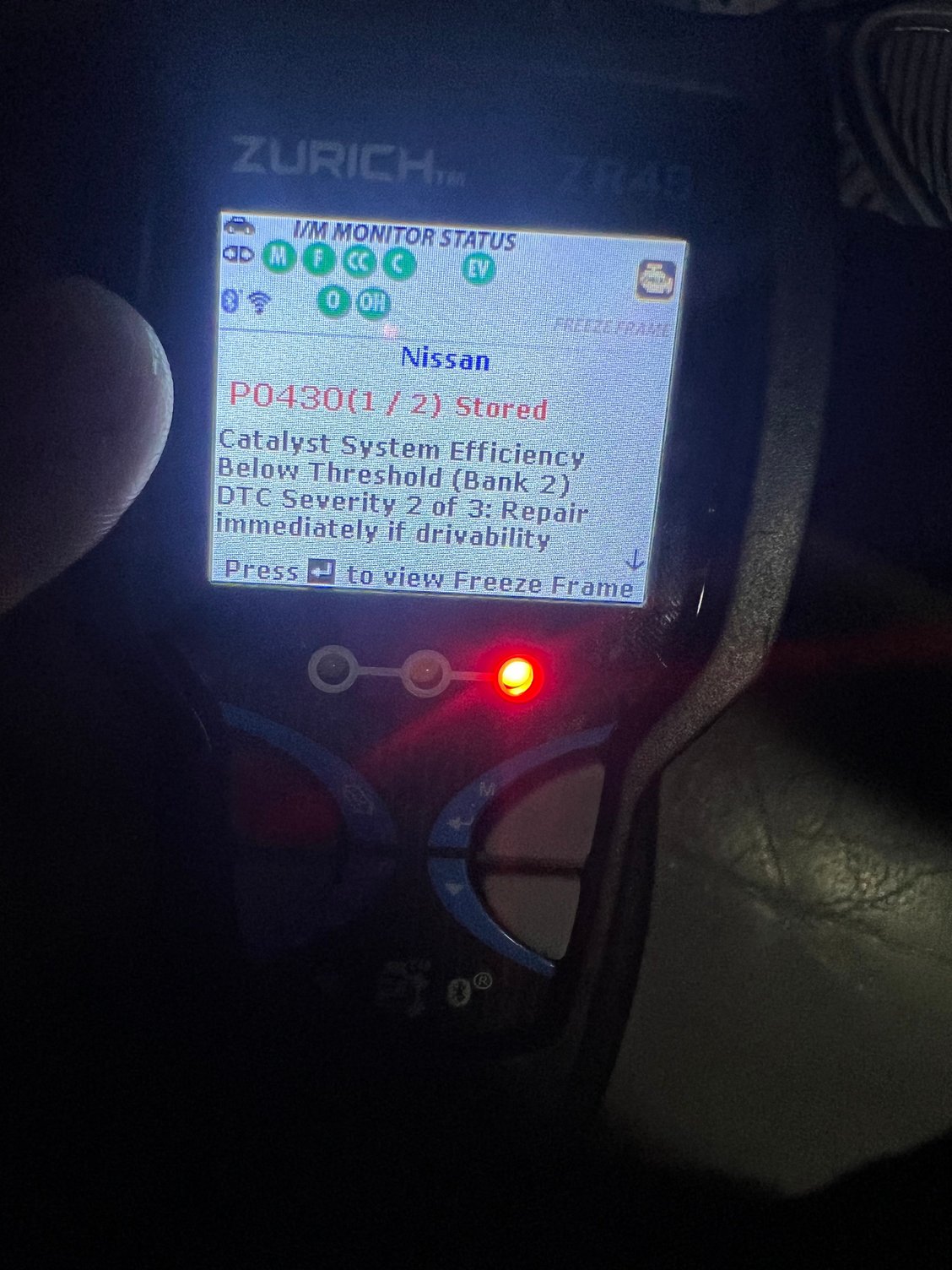

09 maxima 275k on the clock. Recently this code came up and I’m due for an inspection this month so I need to get this fixed. I believe this is a bad 02 sensor. If I am correct which one? Any help is appreciated. New to this.

I had to replace the cat (the one up front by the radiator) to get rid of this as I had replaced both upstream and down sensors to no avail.

No, but those are the one's YOU say you wish to change. I believe the Cat needs to be replaced . But it is your car and if you wish to replace those sensors, they are the ones for bank two! Pay attention to the part numbers!

Sad to say but that code is a bad CAT no sensor...
