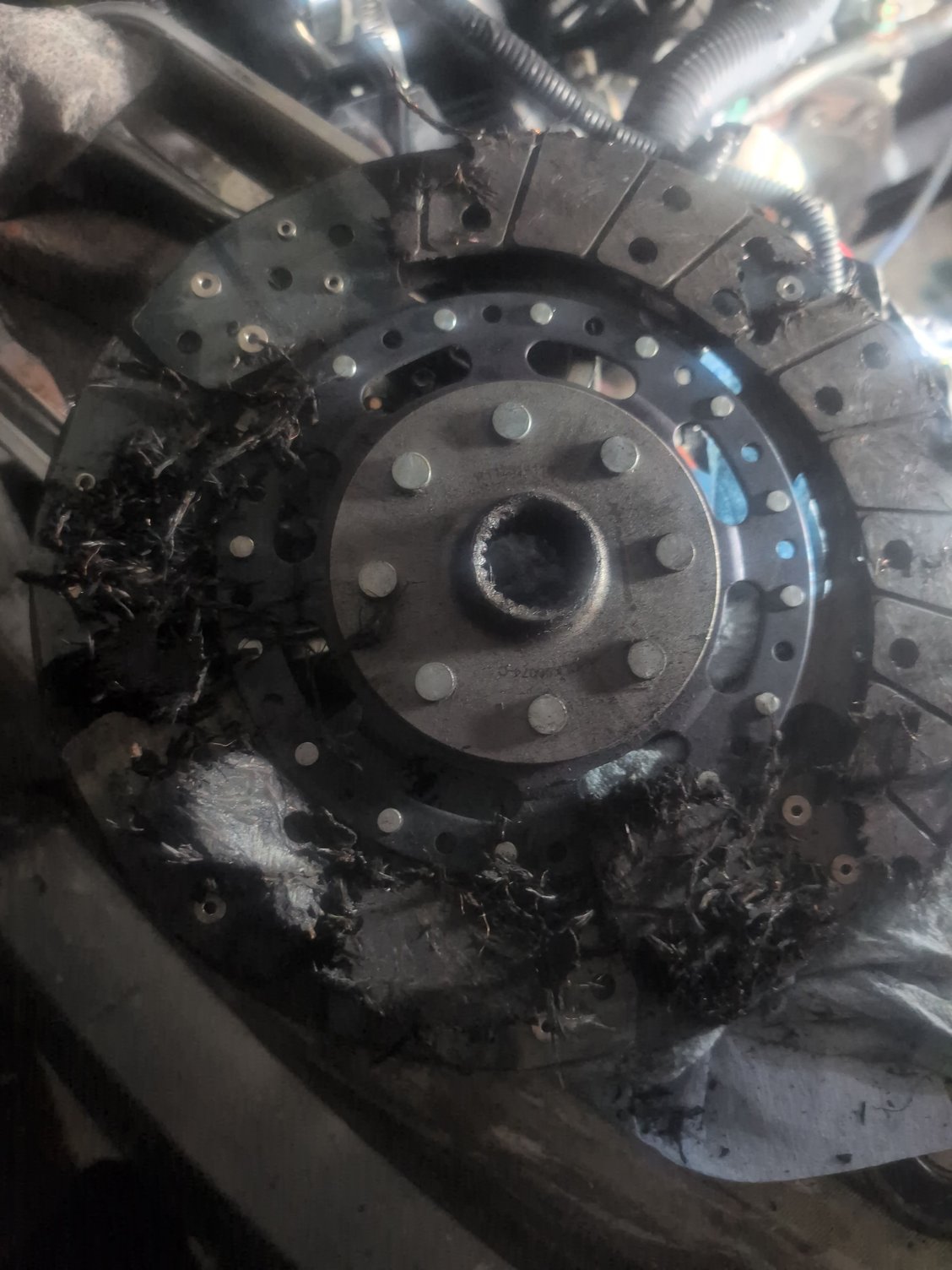

My car is a 2002 Sentra Spec-V swapped with a 2010 Maxima VQ35DE. Our clutch, which was bought for the original 2002 Maxima motor, lasted 5 hours on day 1 and 2 hours on day 2 in 24 hours of lemons. After the second hour, the clutch decided it would exit the building. We race again in a few weeks. Any suggestions on a clutch? I see a ton of options for 2000-06, but I don't see any options for 2010? The transmission is a 2002 6-speed. Should we be looking at a clutch for 02-06 or 2010? I assume we have to use the older ones because of the clutch fork.

This section won't help much. The last manual trans in a Max is 2006. 02-06 are the same.
A couple options
https://www.nisformance.com/category-s/125.htm
https://www.competitionclutch.com/si...clutch-kits/c1
