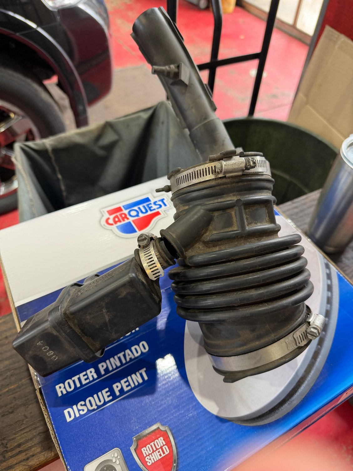

Ok, so a couple things…
I got my leaky valve cover gaskets replaced. While doing so and putting it back together they noticed a torn Air Intake Hose Assembly (pic beliw). They surmised the leak of air after the MAF sensor could be causing the lean CEL.
Replaced it for $280 for the part from Nissan! 😏
Today, I drove it 50 miles on the freeway. First, let me correct what I said previously. While my car runs great, my MPG is down 4.5 mpg from my past normal. Guess I haven’t really had it on the freeway in a bit to notice.
secondly, my CEL came right back on after about 30 miles. So it’s not either 02 sensor, not oil getting into the sensor. Not the torn air intake assembly 😏
i think I’m just going to sell it. Not happy because I love the car but it’s evident after 4 shops no one has a damn
clue
