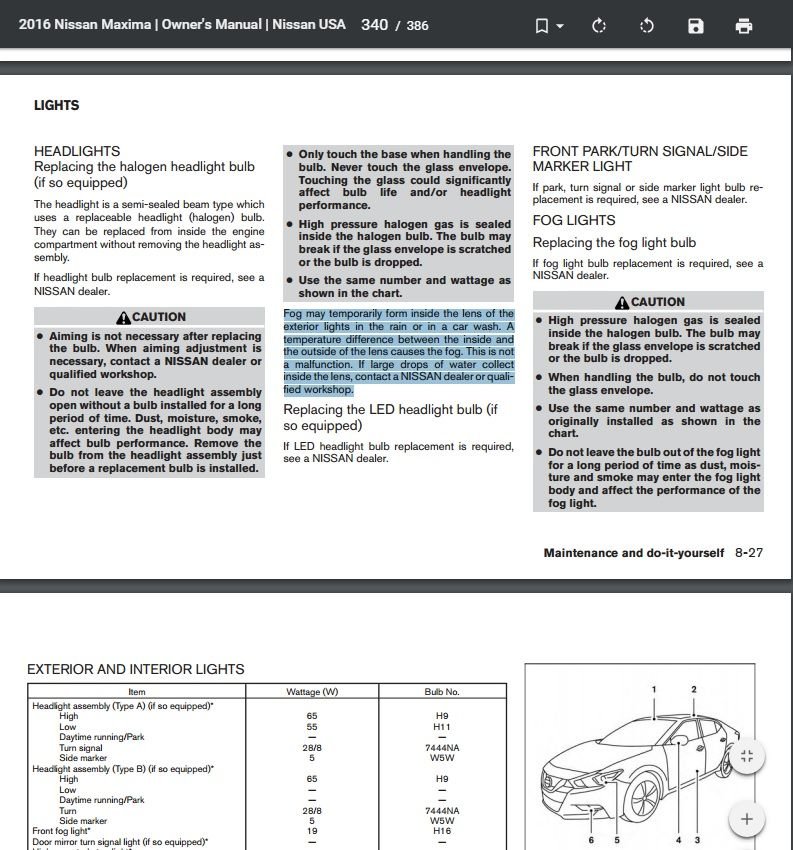

Just found this (highlighted) in the manual, page 8-27:

The owner's manual states a little moisture in the fog lights is normal.

I'm beginning to believe that an occasional small amount of thin mist in these fog lights might truly be considered normal. They are designed with vents for exactly that reason. I was looking at the manual for my wife's 2012 Explorer the other day because I'm going to install new bulbs in her fog lights, and it specifically states in her manual that an occasional "fog" of condensation is normal depending on the temperature, humidity, etc. and that it will burn off when the lights are activated. It then states that the housings are vented to allow for evaporation. It did point out that if there is enough condensation that it runs down the lens or pools in the housing, then there is an issue.
There are many reports on the forum of people changing their fog light bulbs and then having condensation issues, but I'm thinking that they would have had condensation anyway. I changed mine right after I got the car. In retrospect, I wish I had waited to see if there would have been condensation before I replaced the bulbs. After I replaced them, I had some condensation in one housing that eventually cleared itself. I have driven the car in all sorts of weather in all temperature and humidity levels and have not had any further condensation. The real question is why are fog lights more prone to condensation than headlights. If the headlights can be designed to not experience condensation, you would think the fog lights could be designed that way as well.
If you are having enough condensation that it is running down the lens or pooling in the housing, I would definitely make the dealer do something because that amount of condensation is not normal.
