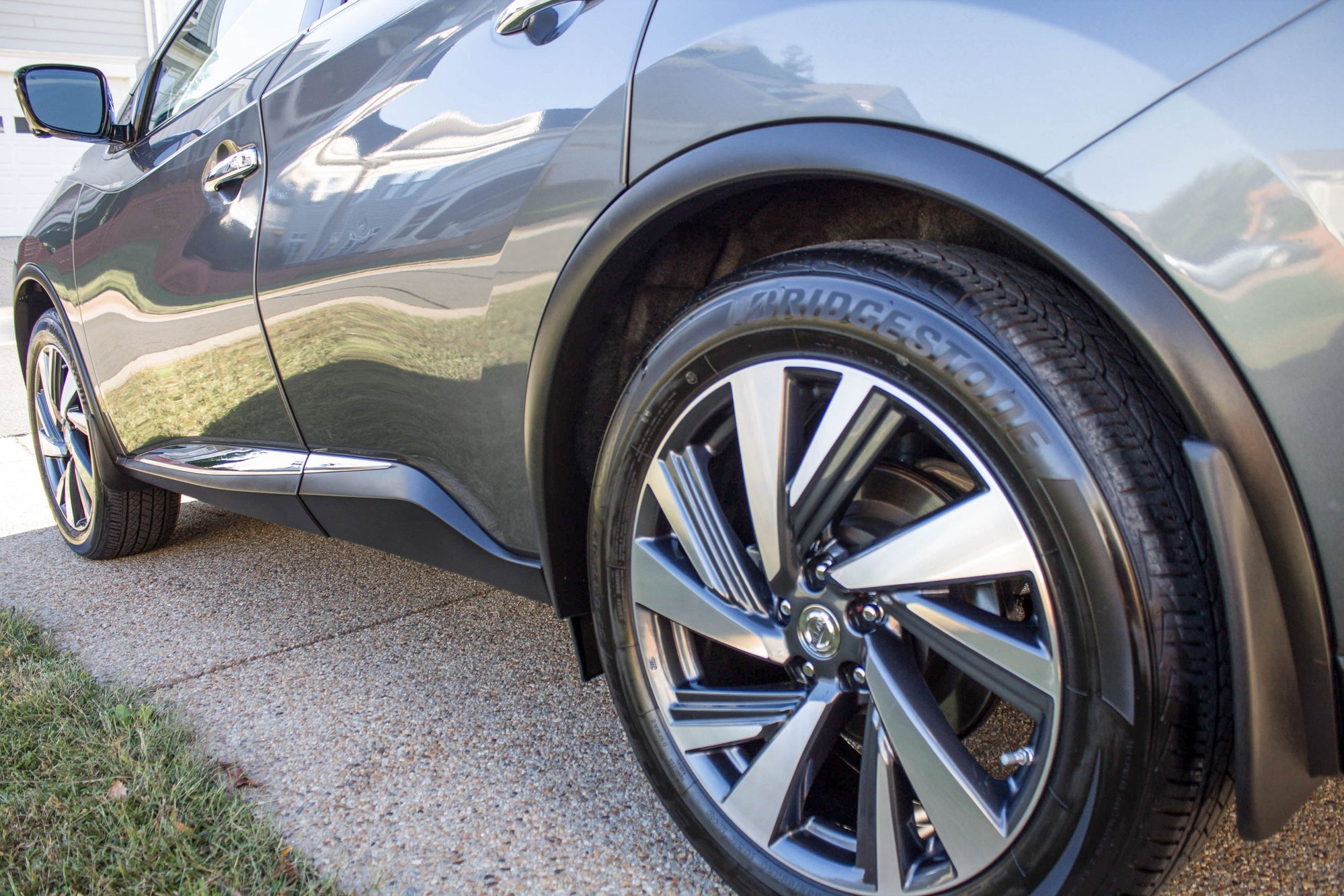

2. Wheels/Tires - removed wheels from vehicle (one at a time). Used Black Magic (formerly known as Wesley’s) Bleche-wite. There’s been some criticism of Bleche-wite since Black Magic took over from Wesley’s. Black Magic claims to have recently adjusted their formula. To me it’s still a really effective and low cost tire cleaner. Sprayed liberally on a dry tire and let sit for 2 minutes then agitated with a paint-safe wheel well brush. Sprayed off Bleche-wite and applied Griot’s wheel cleaner. Follow their directions to a T which is to say don’t let it dry on the wheel surface. Using a clean MF wash mitt and bucket of Mr Pink car wash suds, removed the wheel cleaner and dirt from wheels. It’s so nice to be able to completely access/clean the barrel of the wheels! Used combination of compressed air/clean MF towel to dry wheels. Applied Chemical Guys Wheel Guard Rim & Wheel Sealant to clean, polish, shine & protect rims. Applied Hybrid V07 as top layer. Instead of using my go-to Stoner More Shine, used the Chemical Guys G6 hypercoat as a tire dressing. Really like it as it leaves a deep shine with absolutely ZERO sling. Again, it’s so nice to have access to the barrel/inside sidewall. Inside sidewall got a coat of G6 too! Check out the before/after shots of the Z06 rims. Corrected the best I could by using EasyOff Over Cleaner, Griot's wheel cleaner and 0000 steel wool. If the barrels had clear coat from the factory it wasn't apparent. Any one have the Green Caps on their Maxima? Mine was apparently factory filled w/Nitrogen. Two months later notiuced that I lost one of the caps. Went to the Nissan dealer to see if I could "borrow" one. Walked around the lot looking for a replacement cap and there wasn't one Nissan model - including a 8-9 Maximas - that the Nitrogen caps.

A couple of more Pics...
2016 Maxima
2015 Murano
