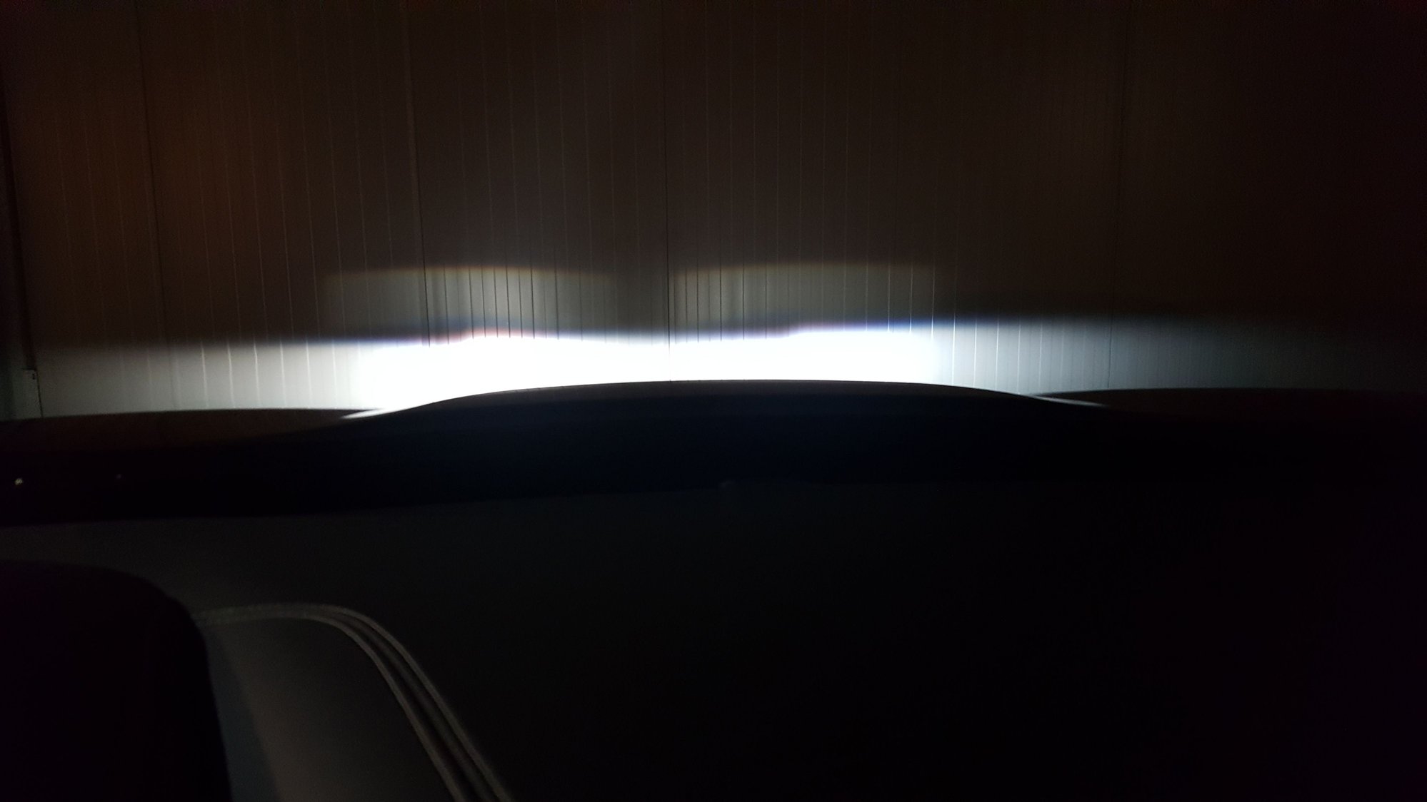

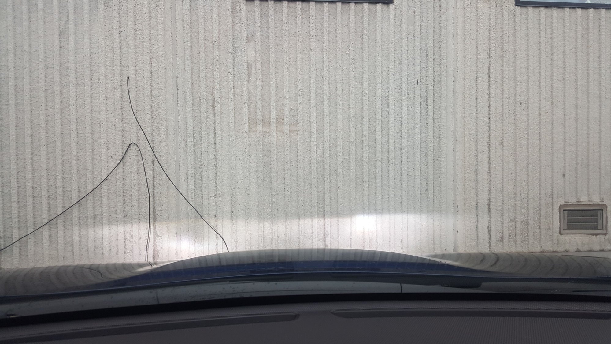

Let's try this again... since my phone decided to delete the whole.last post with pics haha
I tried aiming the 8000k bulbs/beams.. but still didn't like the beam pattern.. it was all over..even tried swapping sides.. noticed that the bulbs were labeled 35w (my ballasts and previous 6000k bulbs are 55w) I then replaced with my previous 6000k again and realigned... and they are much nicer as far as beam pattern so stayed with them for now.. not sure if the combo of 55w ballasts and 35w 8000k bulbs was part of the problem.. but I couldnt take it..
Here are some pics.. the lighter day pic is of the 8000k pattern before attempting to adjust alignment. . The night is of the 6000k reinstalled and re-aligned ..
They look more white-ish-blue in the pic (like they did when new) however, the reason I tried replacing them with the 8000k was because I felt they were getting dim and un-inspiring...
Kensun 8000k beam pattern. Factory alignment (unadjusted)

Bulb seating on the driver side was way off in that first pic. Looks corrected in the second but you really need to be further back from the wall to tell.
Also try to click on directly on the light when taking the pic to focus on the beam so that it's clear.
