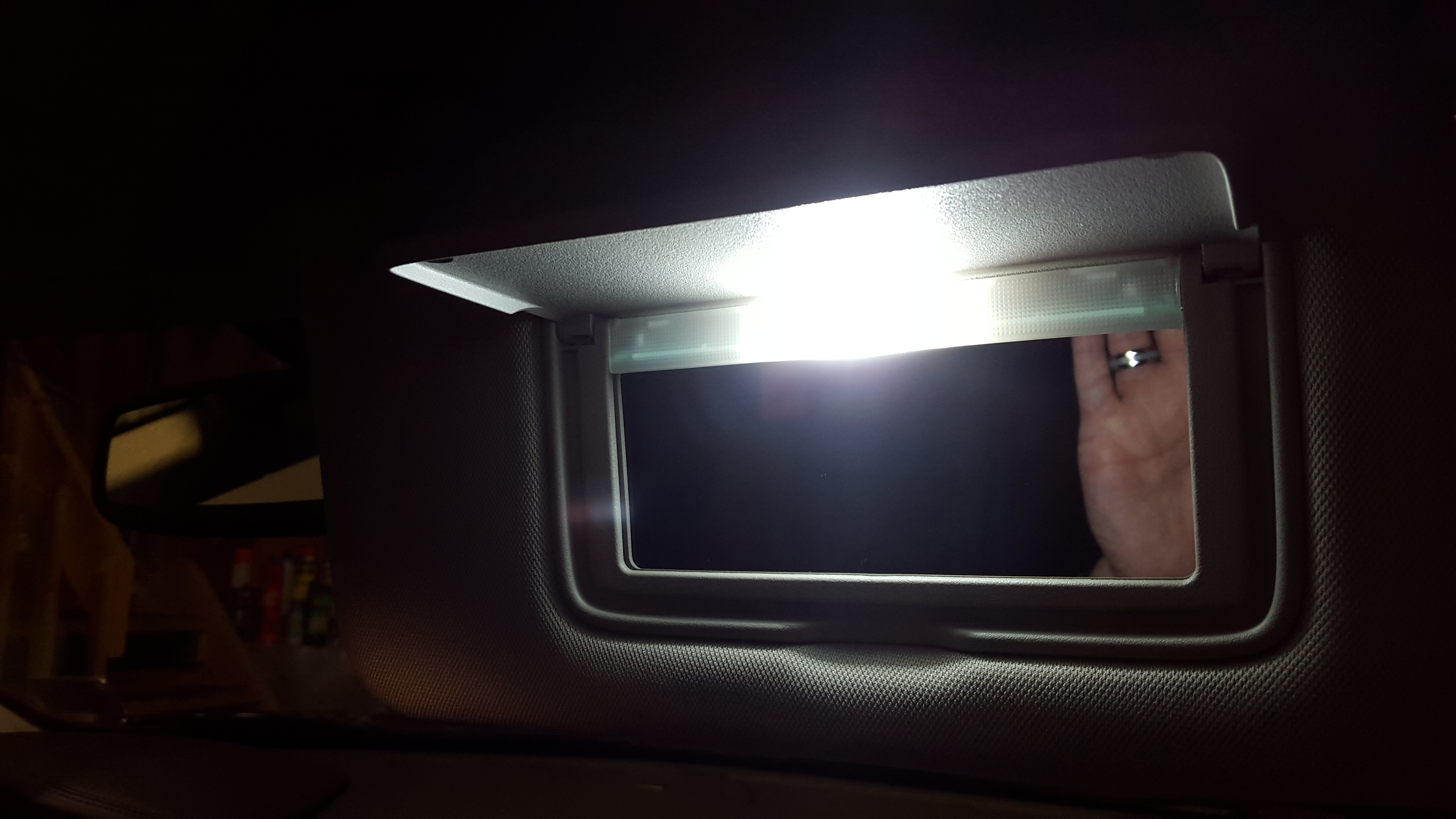

Light freaks! Heres a new one...
Fantastic upgrade!!!
Amazon.com: iJDMTOY 3-SMD 29mm 6614F LED Bulbs For Car Sun Visor Vanity Mirror Lights, Xenon White: Automotive Amazon.com: iJDMTOY 3-SMD 29mm 6614F LED Bulbs For Car Sun Visor Vanity Mirror Lights, Xenon White: Automotive

The vanity mirror light is very yellow. The Amazon link shows the bulb looks like an old school glass fuze. The new bulb is ultra white. It's whiter than the led map lights. These things are ridiculously bright.
The install is real easy. You need to pry up on one side of the plastic cover, it just snaps off. On the right side of each bulb, you will notice a small plastic nub. Place a small flat blade screwdriver between the nub and metal end cap of the light and pry it up. It'll just pop out.
