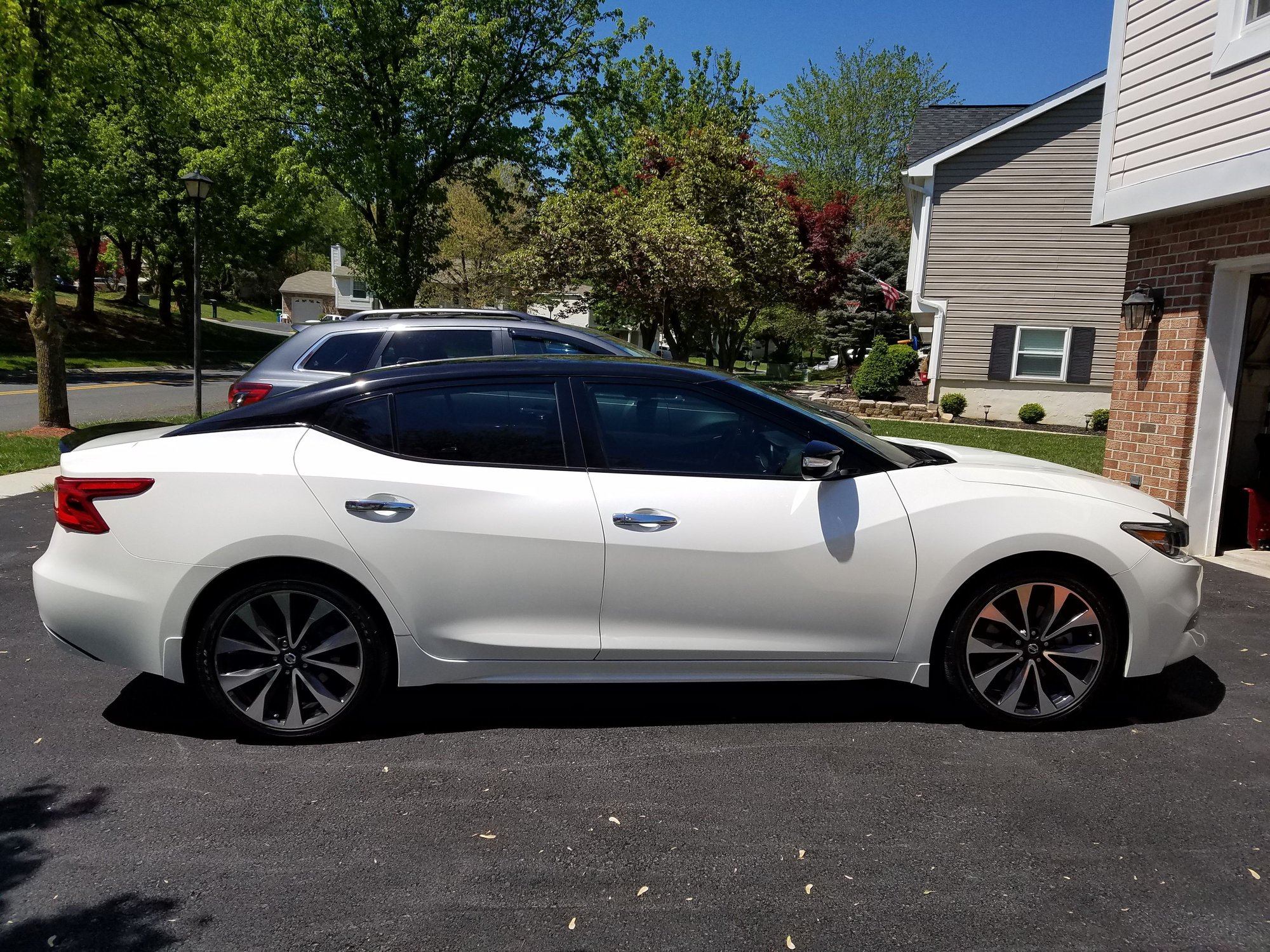

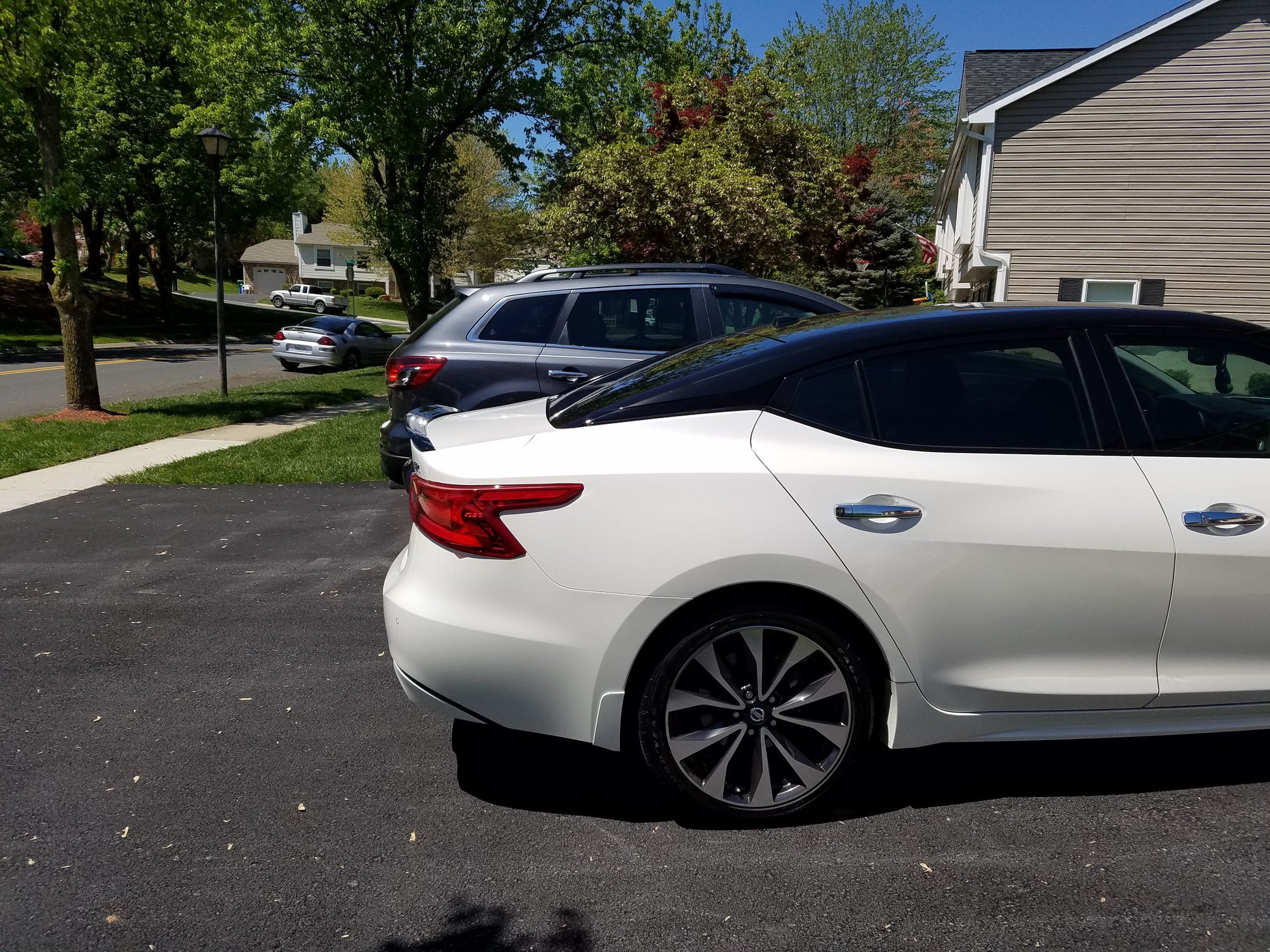

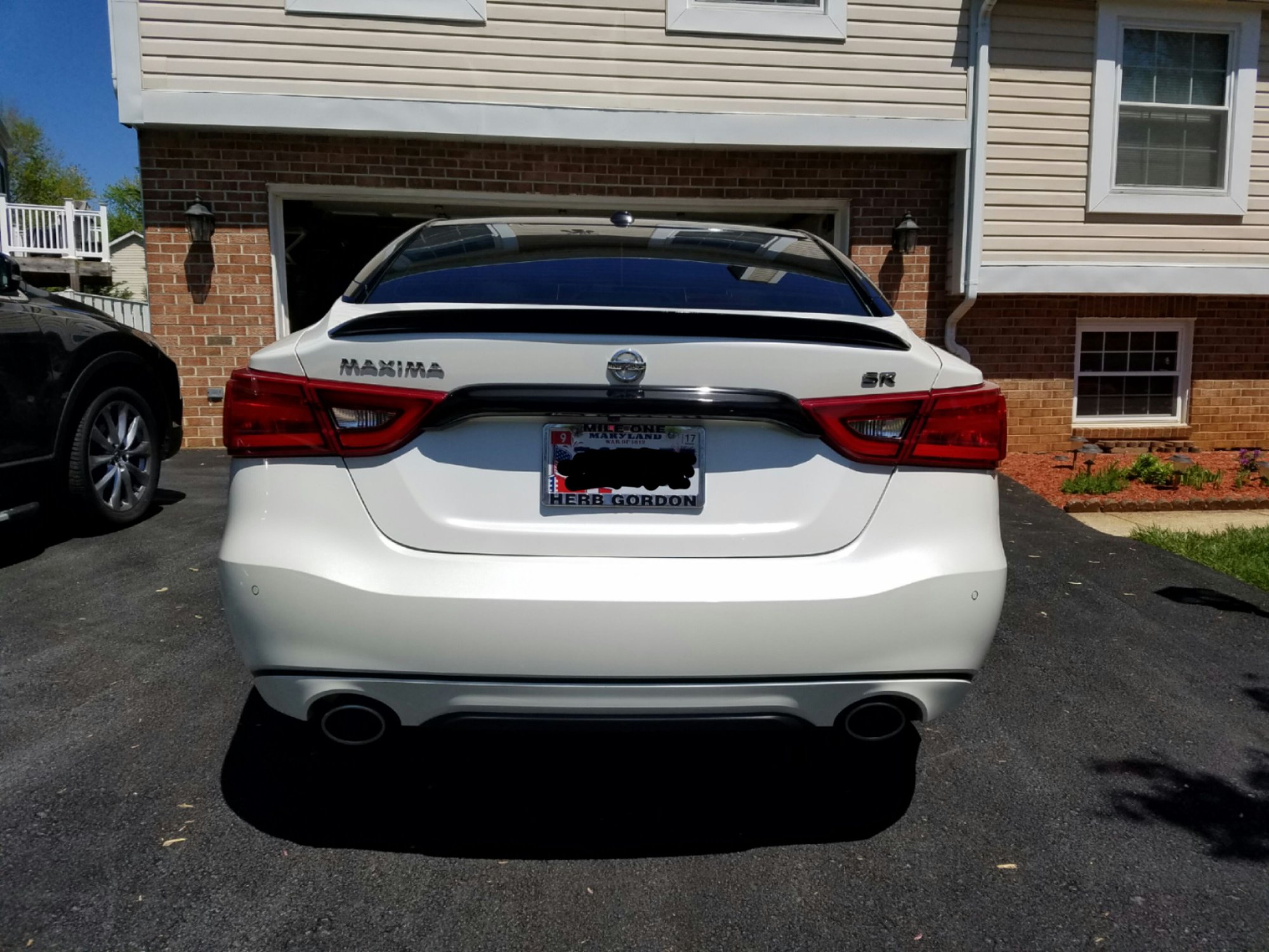

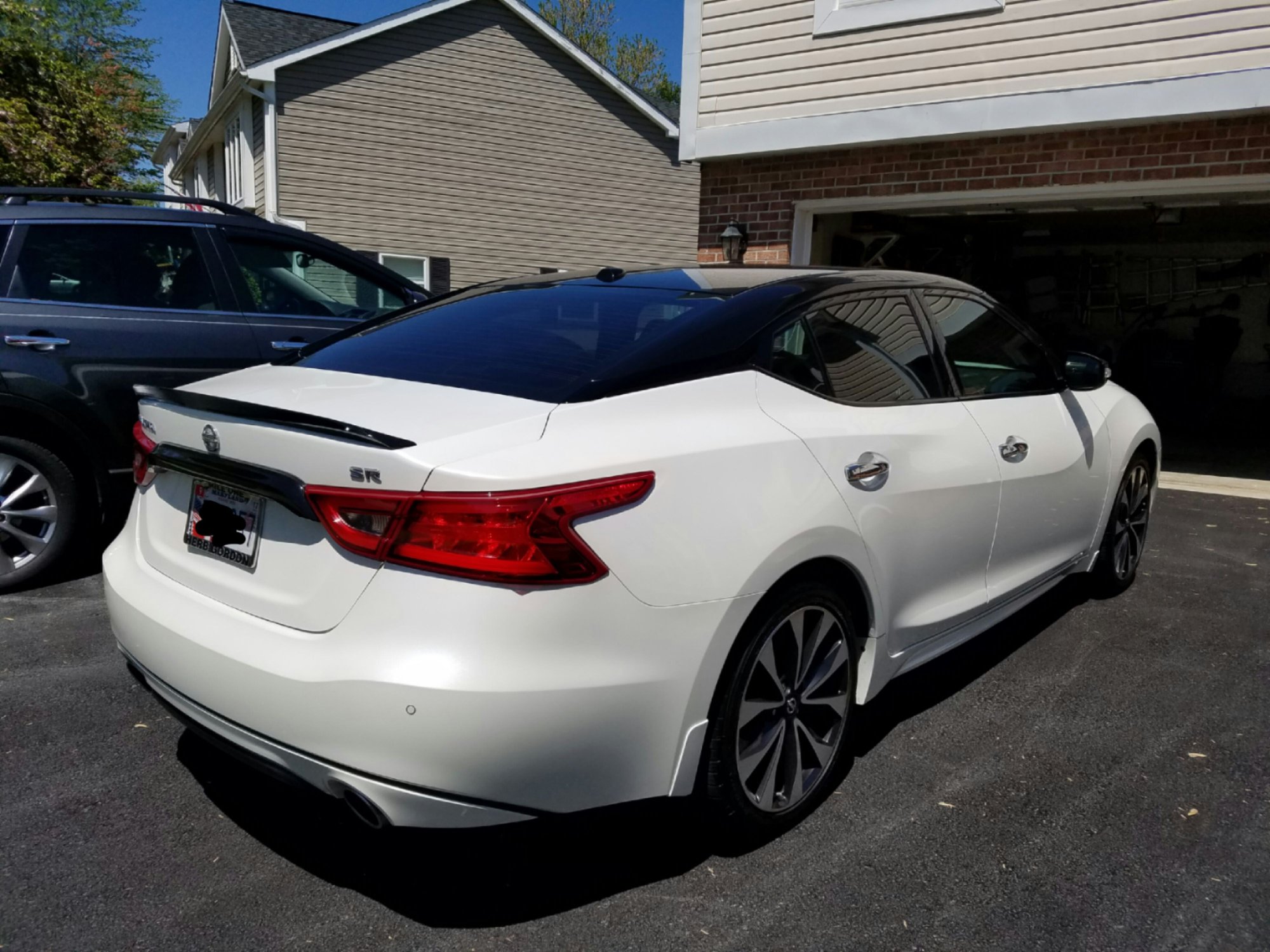

Just installed mine today. It's actually a big piece of rubber that needs to be painted with flex paint and bent to be installed. Was a pain. I'll post some pics tomorrow after I take the tape holing it in place off. I like it better then oem. But hate the paint job the shop did so now that it has paint on it will get it wrapped in gloss black.

Here are some pics

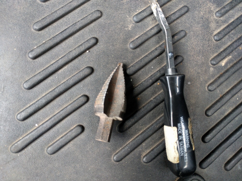

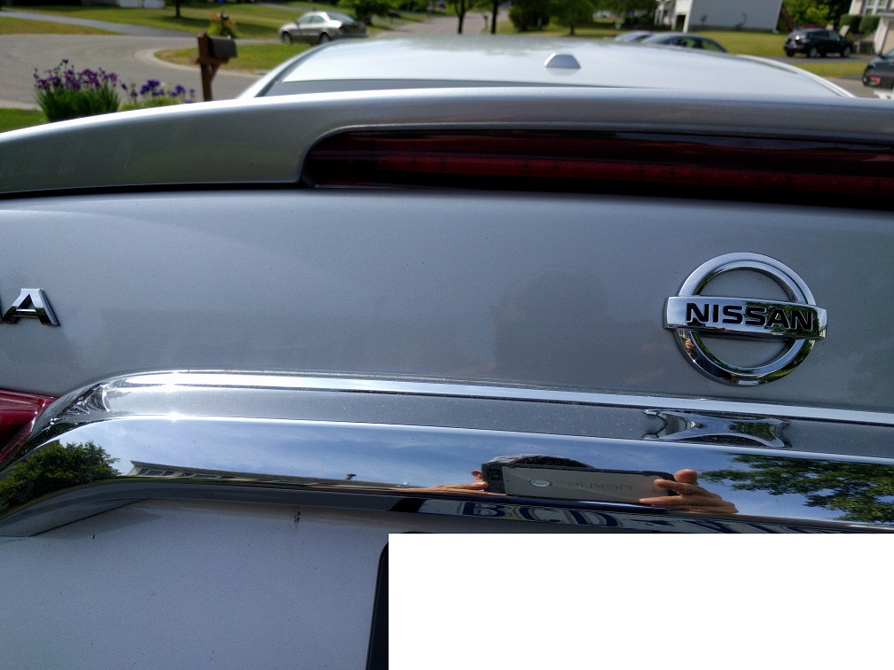

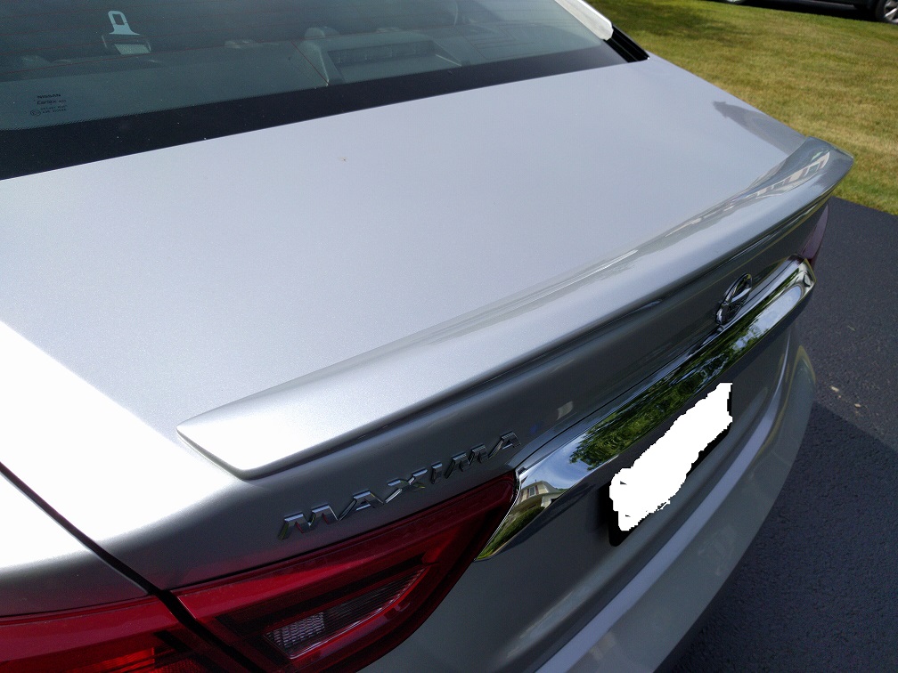

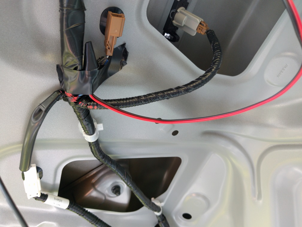

I installed a generic one off ebay. Looks like the wing king one pictured above. Color match was excellent and installation was similar to ones Ive done before. Mine came with 4 plastic guiding strips for hole line up and drilling. Needed 5 so I made flat one out of card stock. I always surround the hole electrical tape as an added measure to reduce damaging the surrounding area before drilling. Once all holes are drilled (5), I used touch up paint and clear nail polish to reduce any rusting. For wiring I clipped the led connector that is normally used for the oem spoiler and connected the blue to the red and gray to the black wires. Beware, the nuts on either end of the wing are always a pain in the you know what to get in. You may have to drill 2 larger holes if you have difficulty using your hands or rachet. I alway have a 1" metal drill bit handy just in case I need an opening. If you get any random metal bits stuck in between the lid, cover the bottom holes with tape leaving one of the larger ones open. Take a vacuum and suck out any metal flakes from drilling. Do the same to the other side.

Thank you so much. Does it connect directly to the existing plug or does it need to be modified like yours?

The generic spoiler comes with two bare wires you have to connect. I cut the wires from the led connector that was connected to the interface in the picture. If you buy an oem spoiler there is no cutting as both connectors would fit together as intended. The wiring is the easiest part. Drilling and getting the corner bolts are what takes time.
