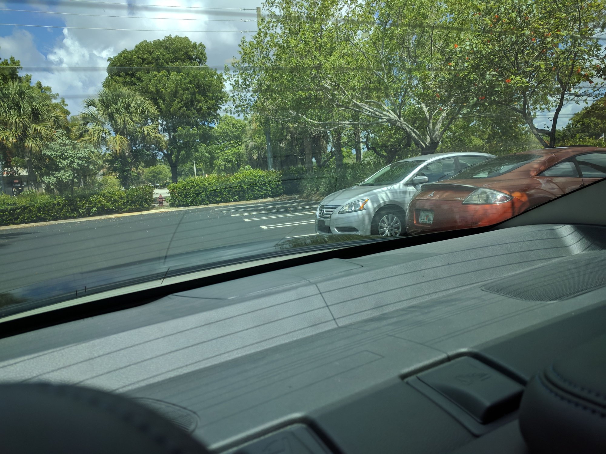

No, factory spoiler still has 3rd brake light on the shelf. 2016 was the first year they did this (annoying imo). I, personally, just popped open the shelf brake light disconnected it.

When I got my sport spoiler installed, I told the dealer to unplug the 3rd brake light. But when they did that, it was disconnecting the rear sun blind and therefore you can't use the sun blind anymore.
Is it true that both the sun blind and the 3rd brake light use the same connection??
