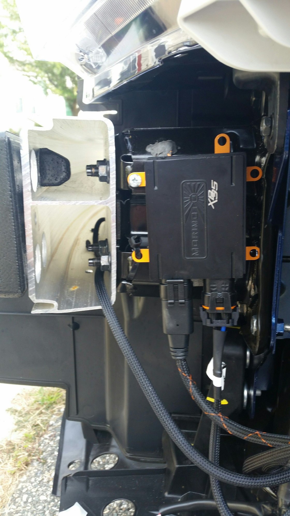

I'm thinking about getting the 35w 5500K kit and I was wondering if H11b is the correct bulb to get and if I need to get a HD relay and will this still work with the auto feature on the car
Old Aug 1, 2016 | 02:46 PM
Blackedoutmaxedout's Avatar
Joined: Jan 2016
Posts: 18
Yea but I got the L shape bulb for easy install u don't need a relay harness and they will still work on auto I put 10000k in my 16 2 weeks ago and working perfectly just gotta do my fog lights next

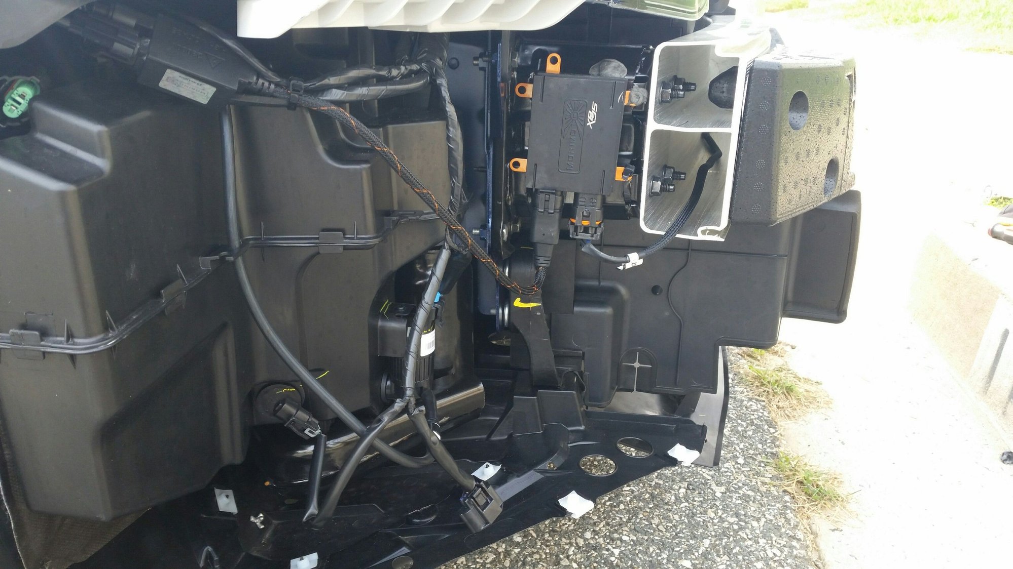

How does the visibility look and how much did the opt7 kit cost you
It's not so bright but the visibility is good when in a very dark road.
I got it on sale for $35.95 and just checked now and still on sale.
For installation,
I removed the front wheels to get a better access to the bulb and open the inner fender liner a little bir from the front as shown in the pic
This is the only pic I got and it shows you how to get access to the bulb.
So easy and it took me around 30 mins for the first bulb as it's my first time installing a HID myself
Second bulb took me 15 mins or less.

I took the front bumper off. Made it easier for me. I am OCD about things being nice and neat.

U really didn't need to do all that but I always say people have their own way at doing things still clean I chose double sided 3m and zip ties under the felt cover on both sides I didn't want drill holes I guess that's my ocd
