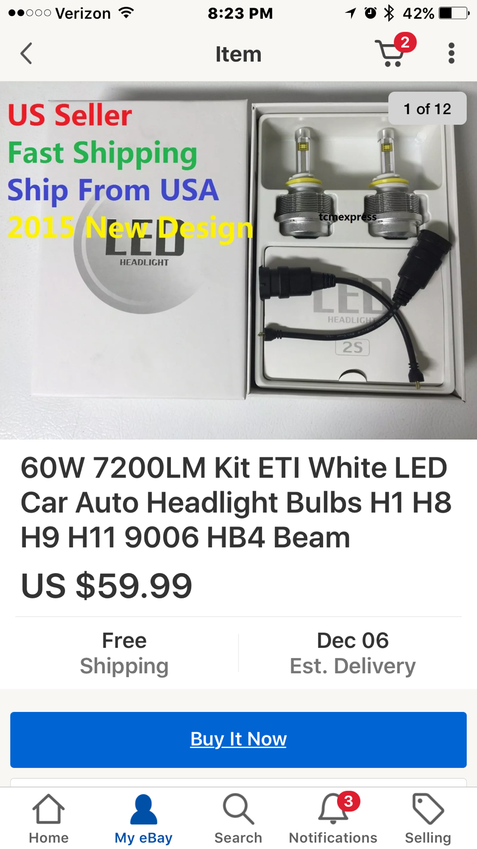

I don't know why everyone is worry, i did my since day one i wash my car truth a carwash at list 2 to 3 times a week,never had issues and i did only one seal.Condensation in Fog-lights-photo432.jpg

That's kind of an ignorant statement to make. Obviously others have had issues. You're not the only one that has a Maxima. We're glad you have had no issues, but there are those that have had issues. Ambient temps and humidity in a geographical region will play into this to some degree.
