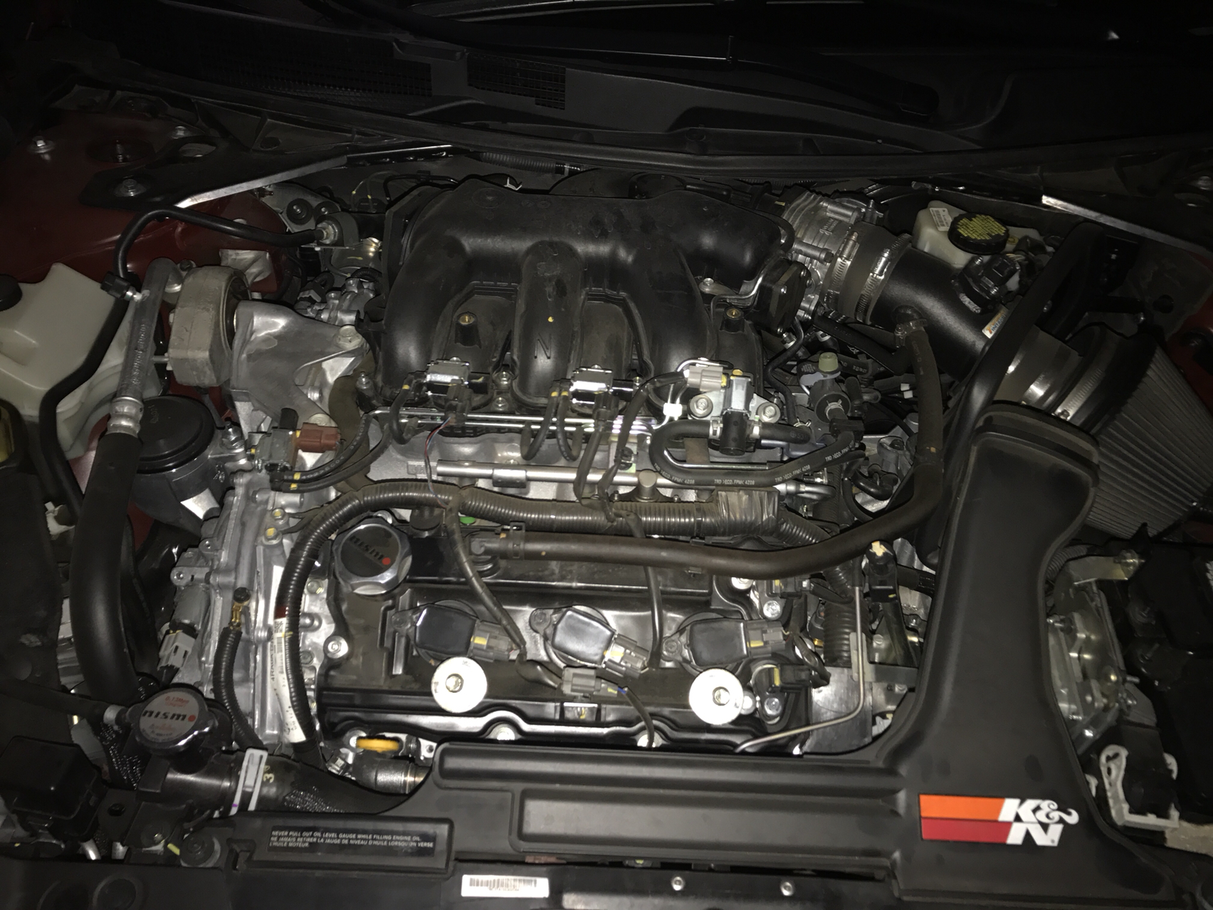

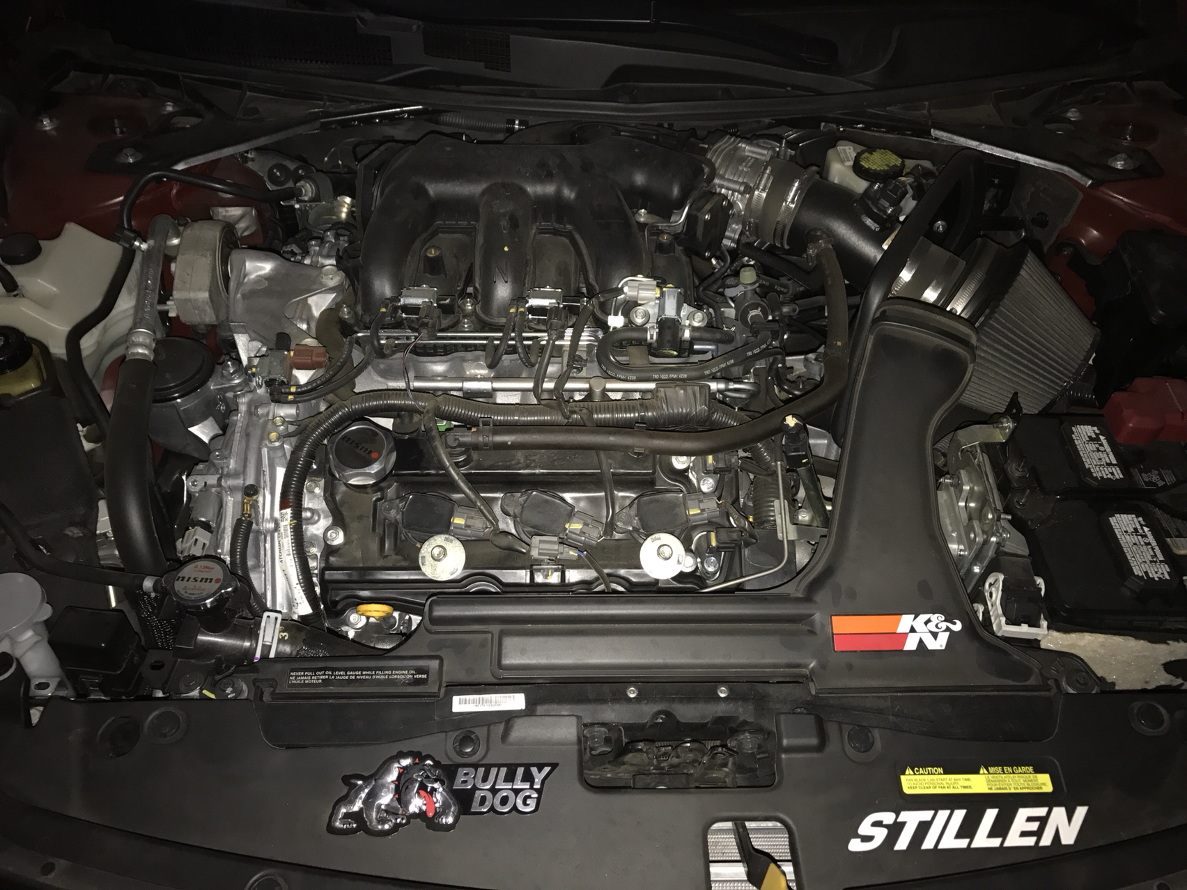

Had a rat make a nest in my 2016 Maxima Platinum engine and it chewed the tubing(hoses) off of the right solenoid valve (there are 2 solenoids under the black engine cover that says V6 Nissan). Easily picked up new tubing from auto parts store but since they were completely chewed off, not sure if the two tubes criss-cross or connect directly to the inlet below. I have searched countless images but they all show the engine with the cover, and on such a new model cannot find videos of the solenoid. Would appreciate an image of the 2016 Maxima engine close up under the cover.

Thanks certainly appreciate a picture, the car is not running smooth and need to know if it is properly hooked up.

Need picture of 2016 engine without the cover-photo702.jpgNeed picture of 2016 engine without the cover-photo323.jpg i have a few mods like i remove the vaccum valves on the side of the intake and put a cover so i can have a full open intake all the time.
