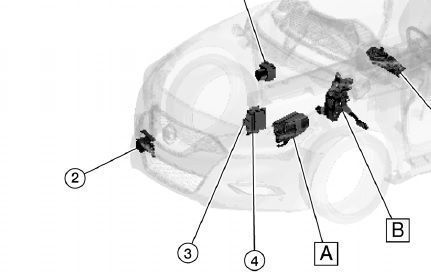

It can happen in heavy rain. Anything that blocks the sensor or interrupts the field for a good scan i.e. sheet of rain, snow, ice, will automatically disengage the system. Wax, I'm not sure but I don't think that would have a detrimental impact. If others have resprayed their bumpers or plasti-dipped then I can't see that causing the error. Rain you just have to wait out, but snow you can clean off the area: it's item number 2 in the diagram below. Typically I have to restart the vehicle after to reset the FEB. Hope this helps.
