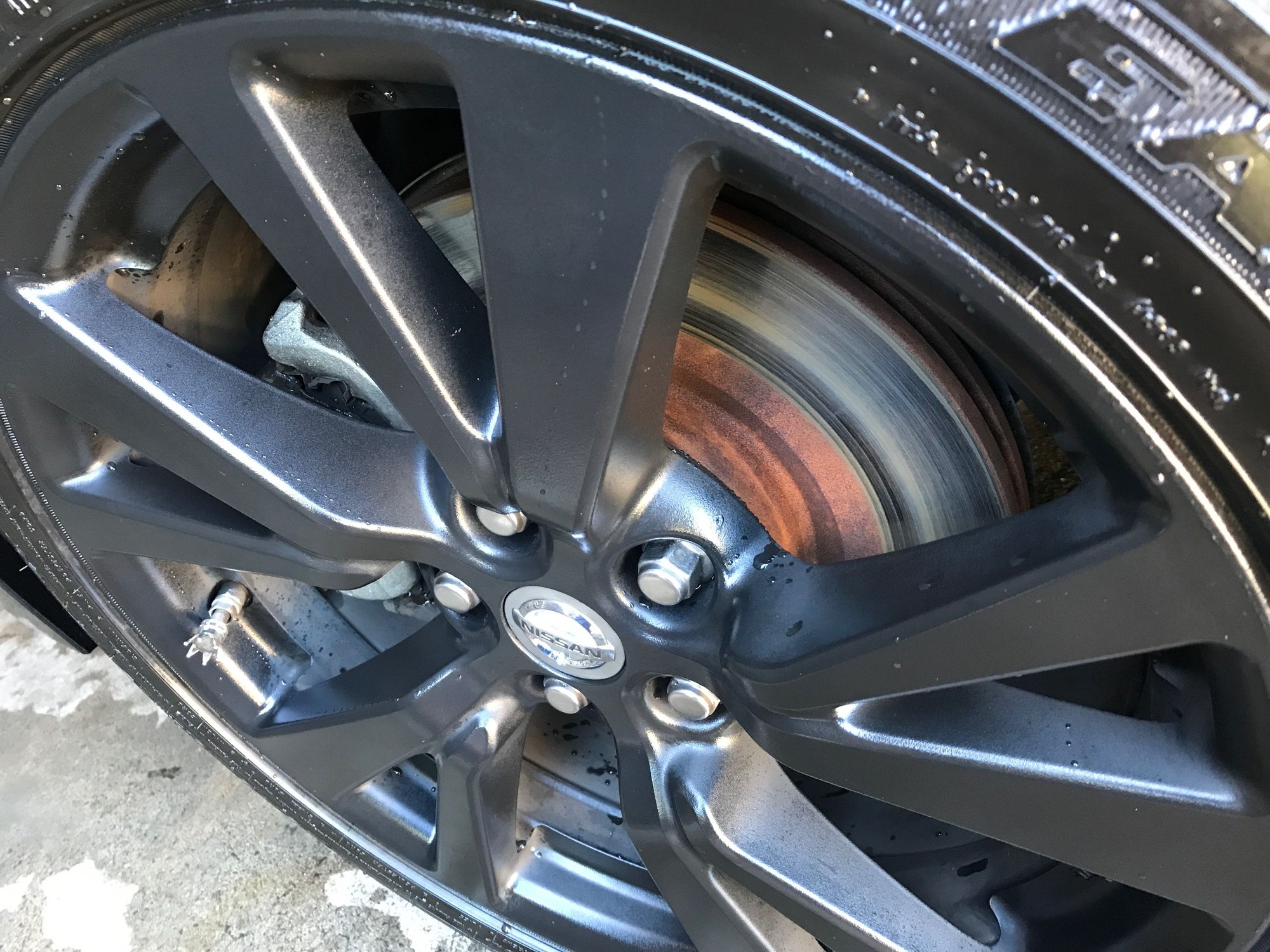

Old Nov 22, 2017 | 08:02 PM
punkfs's Avatar
Joined: Aug 2016
Posts: 298
Originally Posted by unreal2k1
I will call the local dealer and explain what is happening and see what can be done before I change out to any after market parts. Will update with how this plays out. Thanks
They replaced my front rotors and pads twice and the noise never went away. They never resurfaced since the machine was broken both times. As the other guy said it only lasted for a few days. Hopefully you have better luck. The replacement rotors were not the same as the factory ones, both times... the ones from the factory had some special coating on it so the middle part did not rust. The centers of the new ones were just bare steel and obviously rusted within the first day. It's just really ugly, I'll probably go aftermarket..
first pic is 2nd day after replacing the rotor:
2nd pic is of the rear from factory still no rust.. maybe your dealer is different it's just cosmetic
