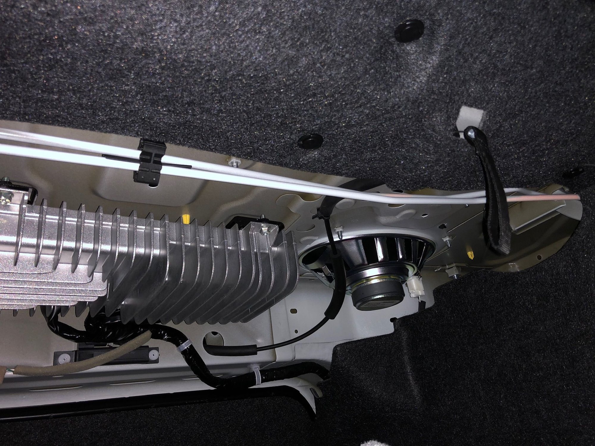

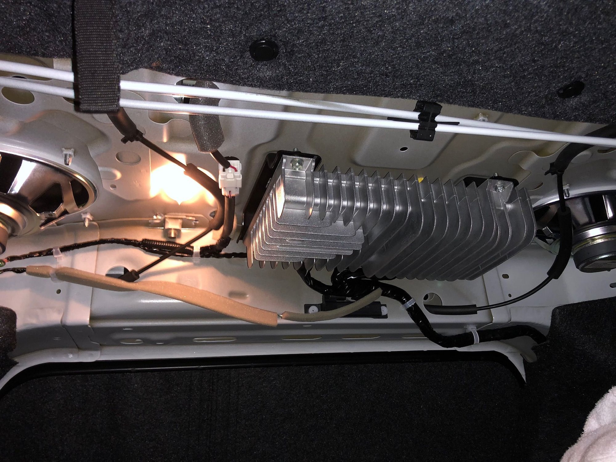

Got my car back last night. If anything the noise is worse than before. They replaced the left shock assembly. My work order doesn’t say anything about the body filler repair. So I don’t know if that was done. I imagine if they want to get paid for it they have to list it. Finally, the brake repair worked wonderfully. The brakes feel solid and no more squealing.
A quick question - is there supposed to be a cover over the speakers and amp in the trunk? There isn’t one now and I can’t remember for the life of me if there was before. The posted pic shows what it looks like now.
Thanks for any thoughts.
That is what my amp and speakers look like also. Did you get any information on the TSB for the brakes?

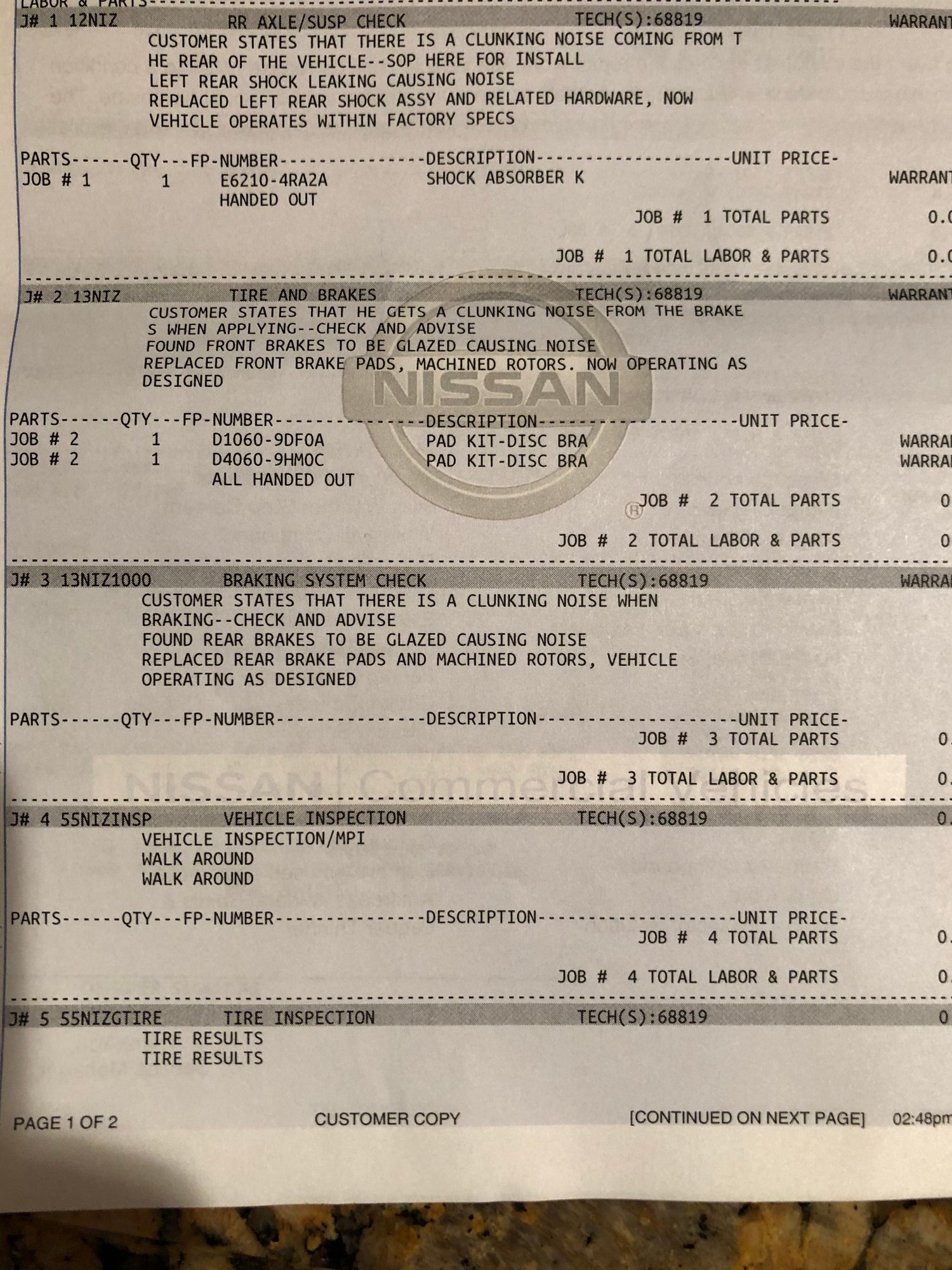

No. The service guy was gone but here is the service order. No TSB listed and the description listed isn’t exactly what I told him. But they got the brakes fixed. Maybe use the same complaints.

There is no cover for the speaker/amp.

My issue was and is that when I go over a bump (like a speed bump) or a pot hole, I hear a metallic sound. After the repair to the left shock and the filler from the TSB I posted earlier, the noise is still present. I’m going to get the other shock done.
I don’t have an issue with a grinding or other type of noise in reverse.
The brake issue was a constant squealing every time I used the brakes. They also felt really soft. After the repair to the brakes they feel better then they ever did.
Old Feb 3, 2020 | 06:33 PM

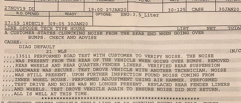

The noises/clunks over the bumps in my 2018 Maxima are now gone. The Dealer had the car for a week.
The Service Manager said that after contacting Nissan support, they were advised to take an air hammer to the welds in the inner wheel housing.
No parts of any kind were replaced.
All I know is that my car is quiet, and I am a happy man.
I hope this information can help someone else.

That actually makes a ton of sense. The noise I heard sounded like a metal pop. It’s odd that replacing parts alleviated mine; while a simple “bang on it” fixed yours. Well. If mine ever returns I know what to do. Glad you’re is now quiet too.
