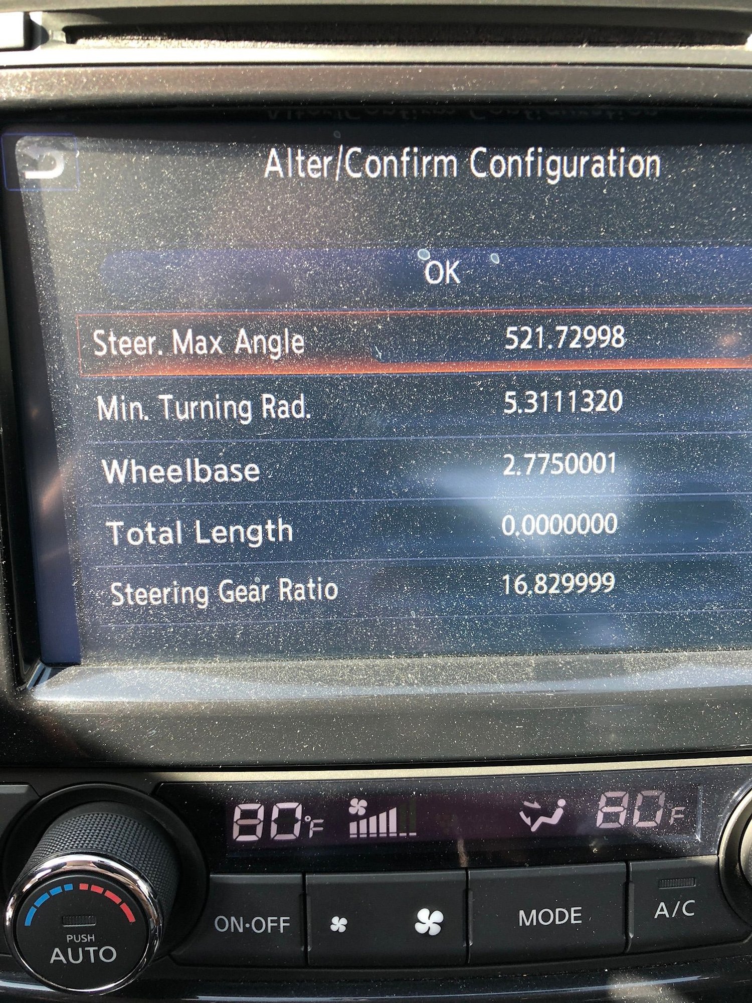

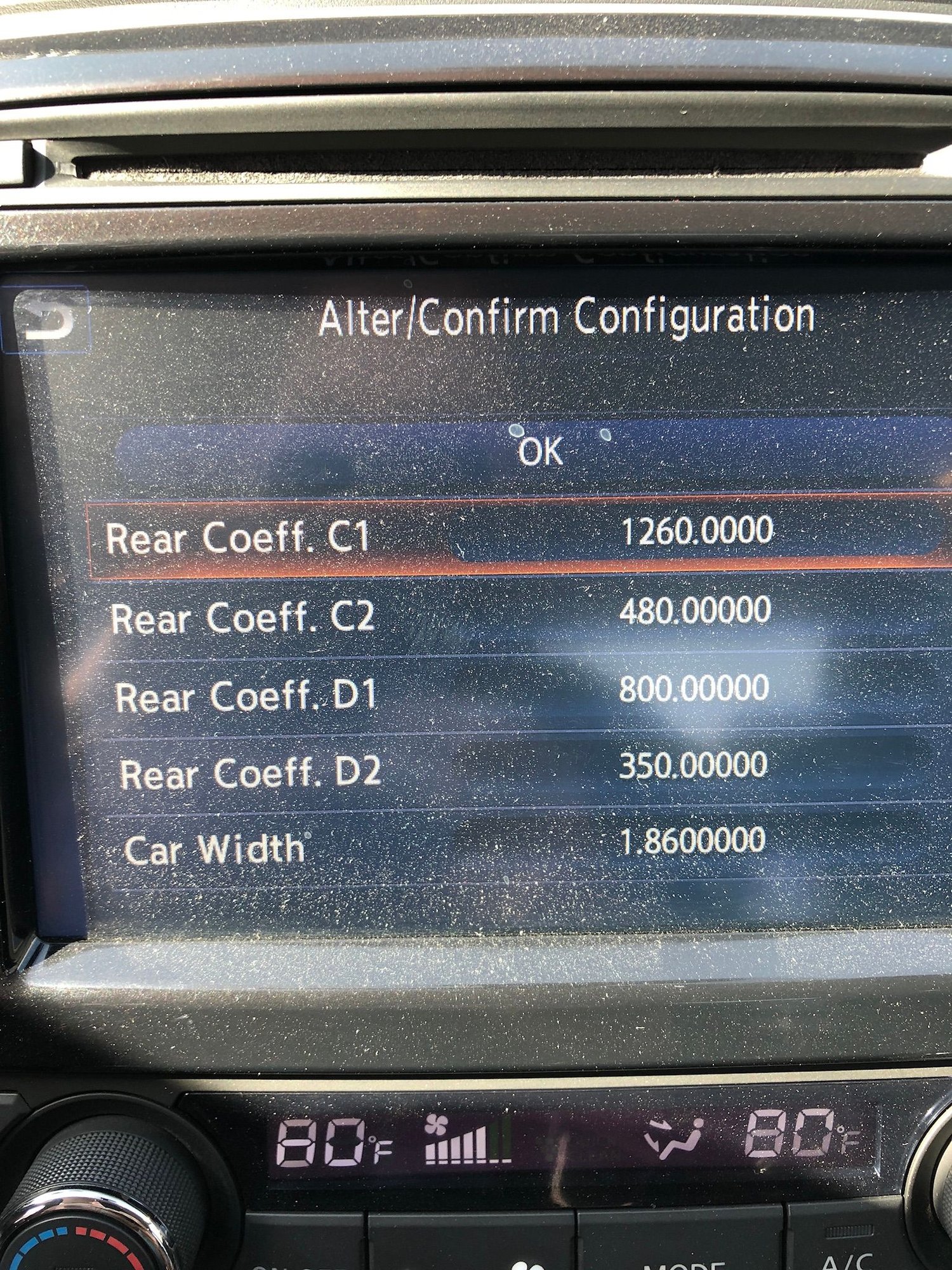

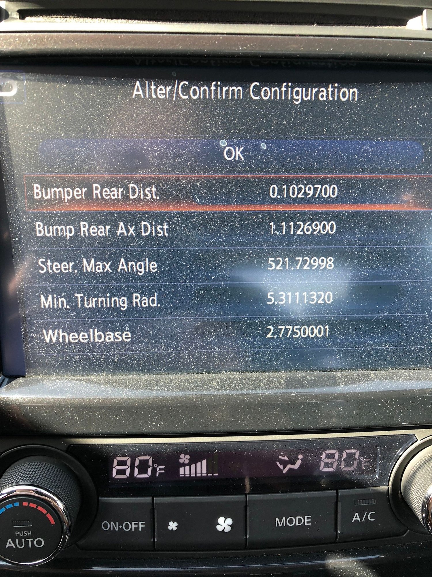

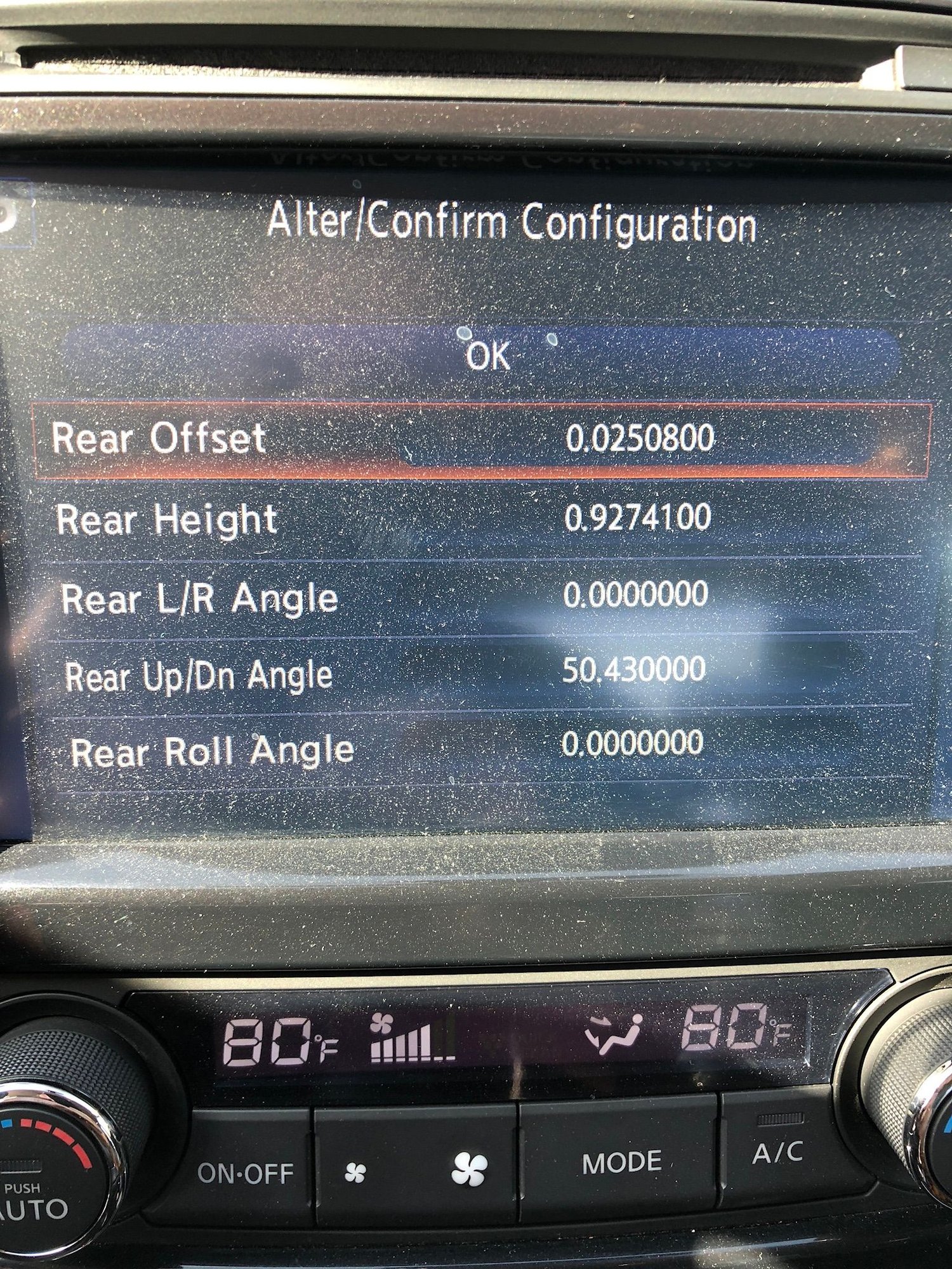

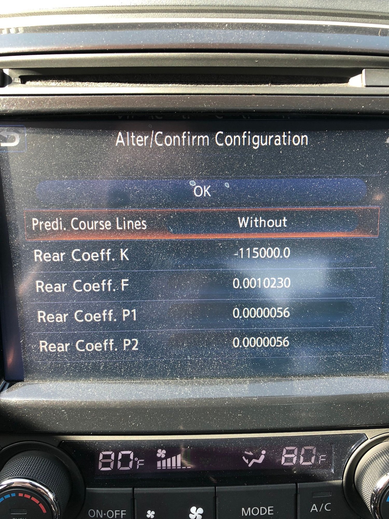

Old Jan 23, 2019 | 01:12 PM
adamharsma's Avatar
Joined: Sep 2017
Posts: 42
Old Jan 24, 2019 | 12:23 PM
megah's Avatar
Joined: Jan 2019
That worked, thanks!
