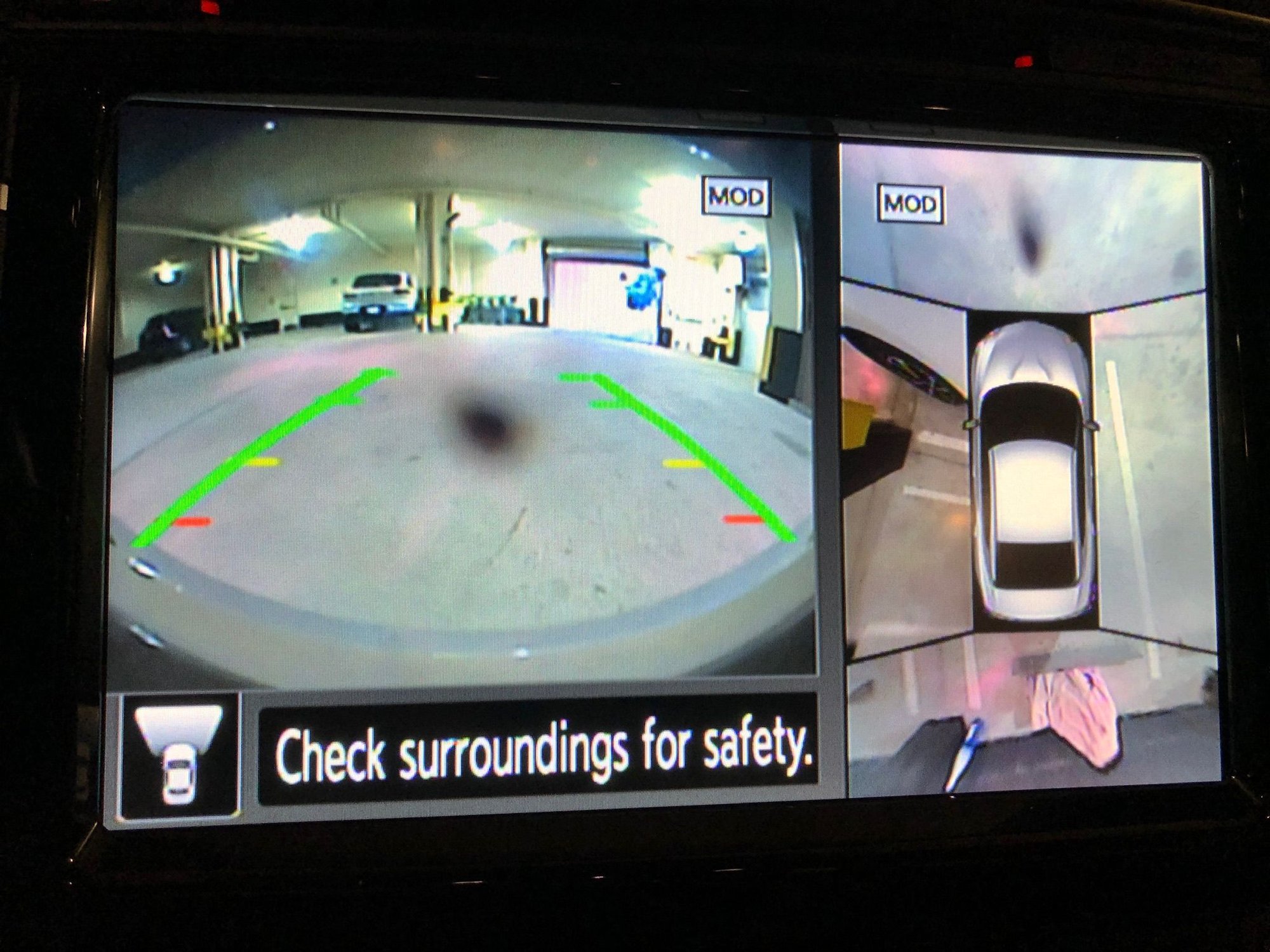

My rear camera just recently developed this black spot on it but I can’t figure out where the camera lens is so I can clean it. I know someone here will know how to clean it, or at least where it’s located.

It is located right above the license plate. (RTFM)

Looks to me that the spot is on your front-facing camera, which is located inside the lower half of the Nissan logo on the grille. Just a moist napkin or a bit of cotton and alcohol should clean it right out.

Wow, now I feel like an idiot. You’re absolutely right. It’s the front camera. Thanks.
