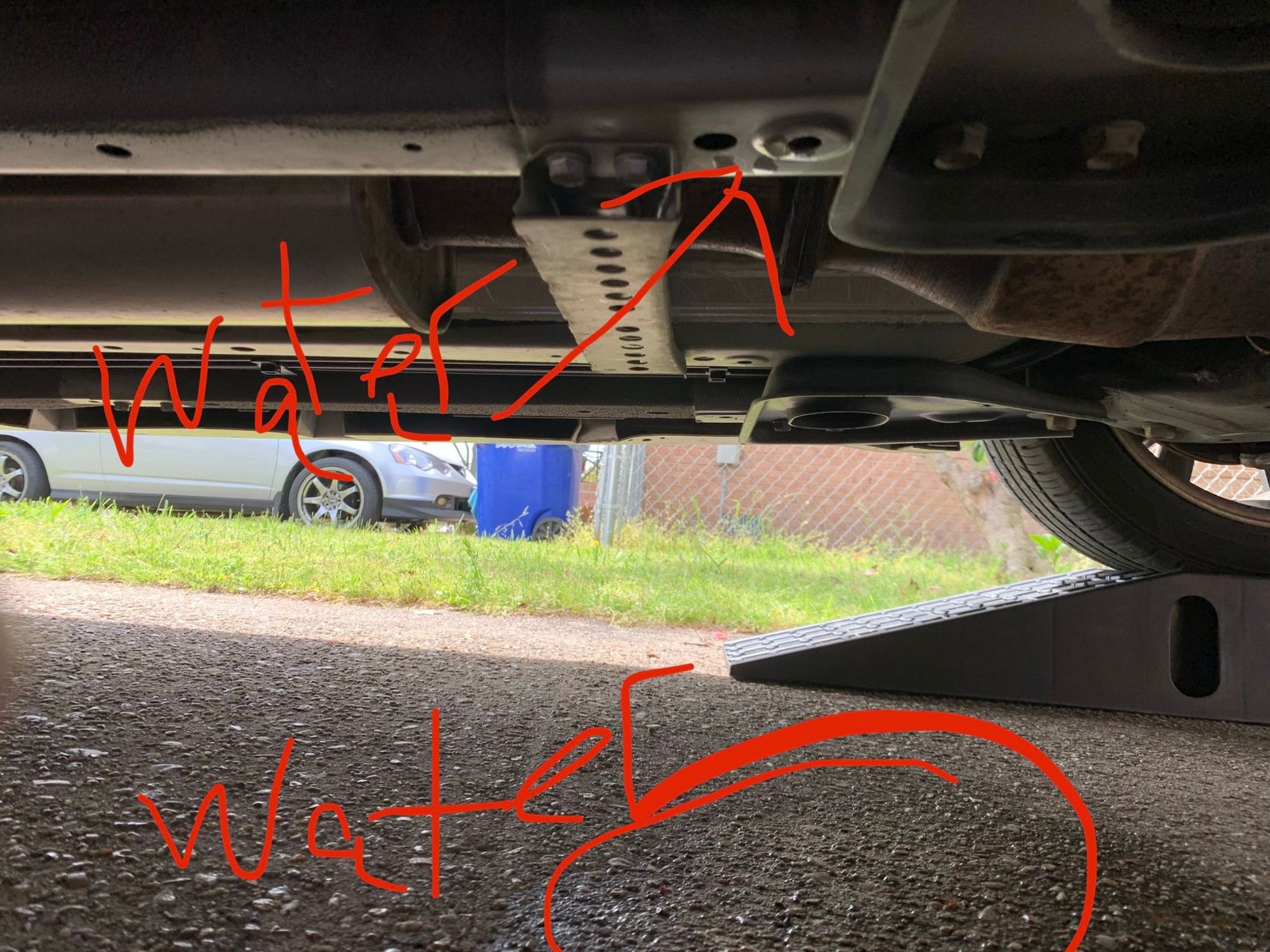

Hey so the reason I started this thread is to clean out that exact funk you’re speaking of. It’s crazy how nasty it smells after running the AC and what not. I actually was able to find the location of the hose by the floorboard from the inside last weekend exactly as you have shown. I was thinking I could just yank that tube out and spray the foam cleaner into the ac unit that way, but I was too afraid to do so lol. On the plus side, I was able to cause the evap hose to leak out water after running the AC for 30 minutes on a 80 degree day. I still couldn’t find the hose bc the water looked as if it were coming out of some holes in the frame. As in the hose was buried behind it? It’s hard to explain but here are some pics of where it came out of

Thanks. That helps. So here is what I know and don’t:
- musty smell on fresh air setting only, all modes.
- clean crisp smell on recycled setting
- cabin filter changed out.
- drain looks good, not clogged, and dripping from top of line to bottom under car and good volume. Almost a constant trickle with spurts at time
what is different about air draw and where recirculating flap is? I’m trying to find a mildew smell source upstream from or maybe on that flap from testing all of this. I see where intakes are under wipers under hood but no sure where that leads, if there are any right angles, flat spots, etc. I park in driveway with down hill tilt and wondering if some organic material has gotten in there and taken root. Thanks!
