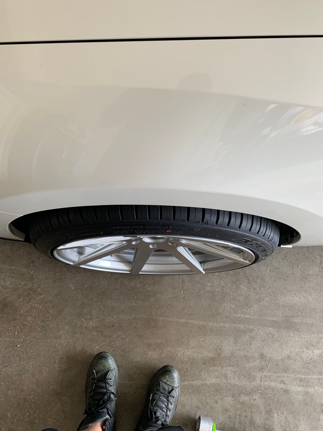

Looking for flush fitment. Car is not lowered yet. Running 20x10 ET25 square set up. Need advice for flush stance on 2016 maxima platinum

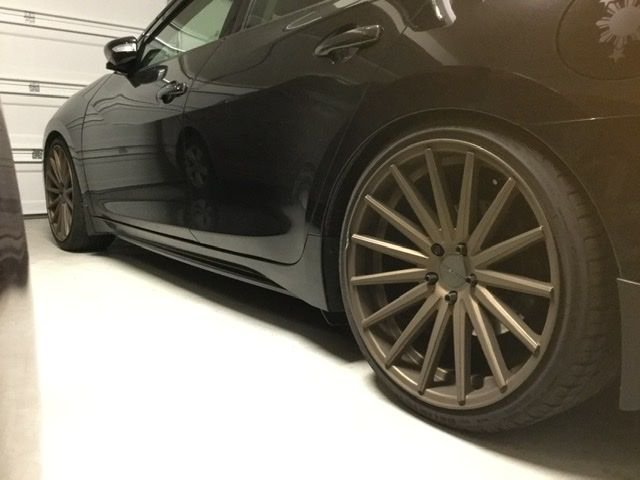

I run 20X9.5 40 offset and it's really flush. I'm also lowered.

Old May 28, 2020 | 05:07 AM
kasdepwel's Avatar
Joined: Dec 2016
Posts: 168
Originally Posted by Skiver
wrapped in Falken 255/35/20
I also run 255/35/20 since a few weeks and and they rubbed while my 245 did not. I had to put some camber to clear fenders until I have em rolled. With my 245 I was at factory specs with alignment and I was dead flush up front but could have used a 5 mm spacer on the back.

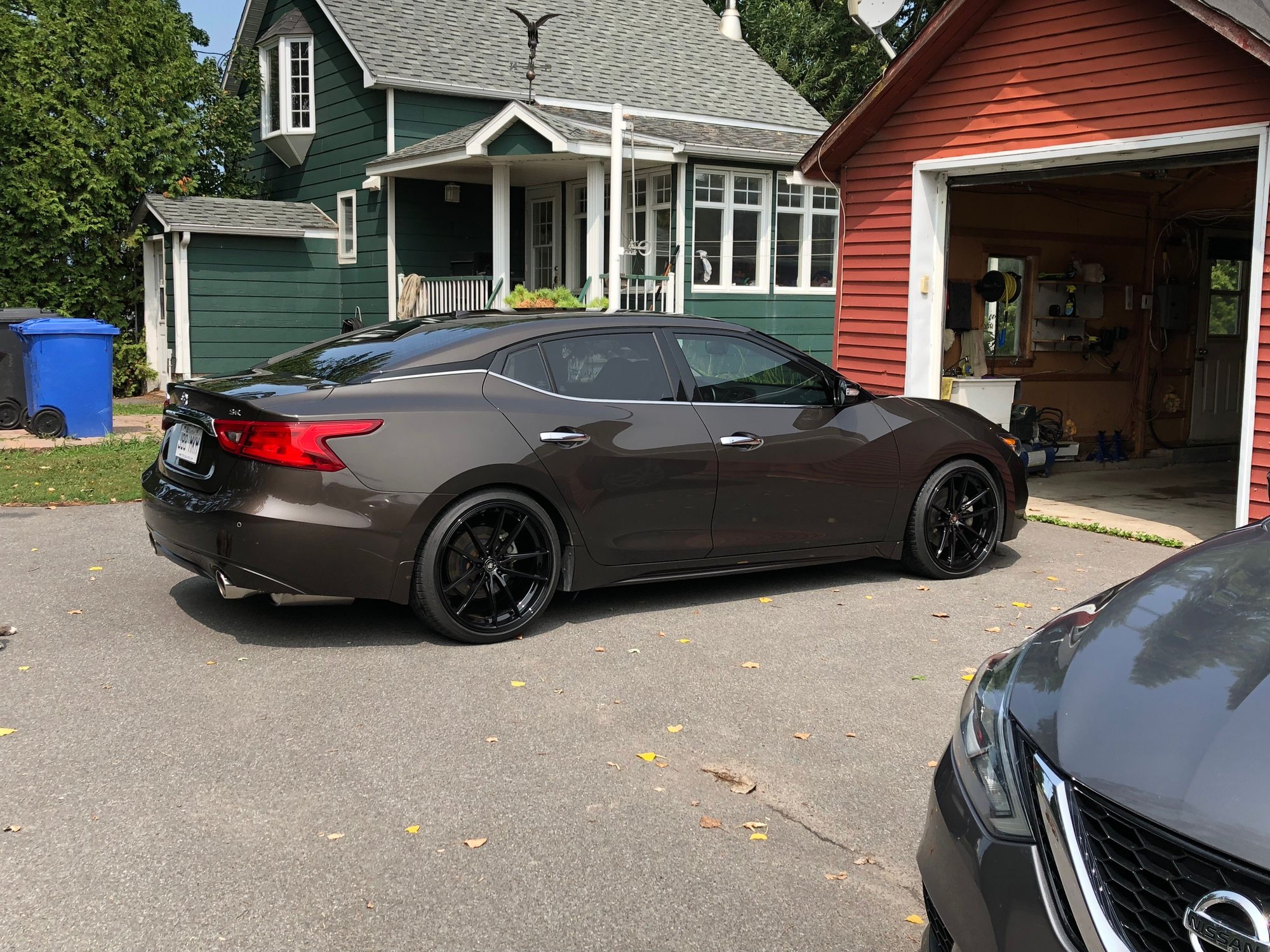

pretty clean fitment. I was looking for a deep concave look going with the Rohana RC7s but they poke too far out. So basically I am going to order new wheels again. I can probably keep the tires and just order wheels. Are you sitting on Eibach springs?
