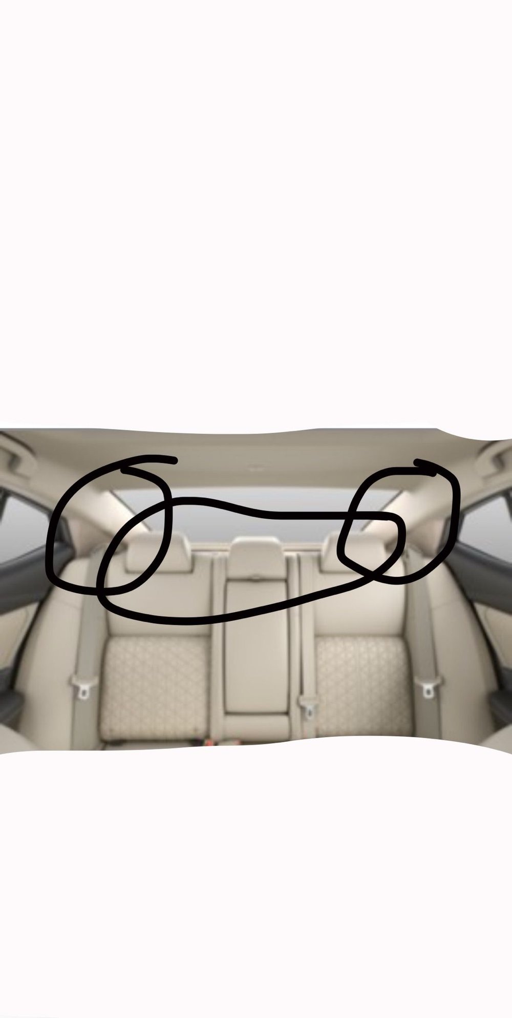

I’m not sure where on the sunshade. I just know that it is coming from there. I circled where the other noises are coming from. The rear deck lid itself, and those two side pieces where the airbags are. I feel like it’s a simple fix 🤷‍♂️

Rear rattle: stick two small pieces of foam (like home door/window insulation) on the inside of the lip of the sunshade housing.
https://maxima.org/forums/8th-genera...ml#post9168427
that video I posted is with the sunshade up. Not sure if it will help me with that or not. I’m sure it’s worth a try. Thank you!

Have you had someone else drive, and sit yourself in the back - you might luck out and isolate the noise YOU are hearing...

My noise in the back went away when I took it to the dealer and they changed the rear struts under warranty....Only occurred when going over bumps

That’s the issue it’s intermittent at times so I’ll never know when to have someone else drive it. It just happens. From what I can tell I know the area it is coming from.

I had this sunshade rattle as well, but my issue was easy to identify. The roller on pass side fell out, so when retracted it allowed enough slop that it rattled. I noticed the one side was missing a wheel, and subsequently looked/found on floor the actual wheel. So far it has remained, but will express concern to dealer when I go in if it falls out again.
