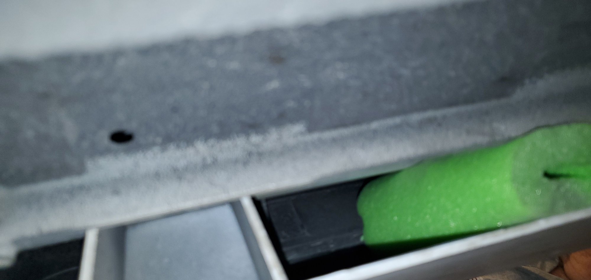

I had a rattle in my '17 Maxima that was driving me nuts. It, too, was speed and wind direction related. Found the issue being a slightly loose fit on the trim that is located below the doors. I put some small pieces of pool noodles tn the area to put some pressure on it, and no more rattles. This may not be the problem with your vehicle, but maybe someone else has the same problem. Remember, if it looks silly, but it works, it isn't silly.

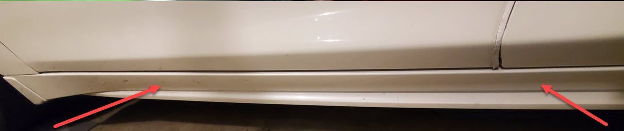

Rattle fix
Not sure if it is the same rattle I had, but it sure sounds like it is. Comes from the sides of the car and only at highway speeds. It was a muffled rattle so I suspected it was coming from outside the car. I discovered that it was the exactly the same location as discovered by 2young2retire above and one of his posts pointed me to the source of the rattle. He fixed his with foam pieces but I fixed mine by removing the three plastic button retainers that hold it in place underneath and along the sides one at a time and then sliding on two nylon washers from a local hardware store over the plastic button retainers to take up the slack. Before this fix, I could move the trim piece with my hands and it was loose. After the fix, it was nice and snug. As you may know, these plastic retainers can be removed with something like a screwdriver. I broke one of mine and had to replace it from pieces found at my local auto parts store. I used nylon washers but you could use poly or other synthetic materials as well. I believe I used a 3/8" size washer. My passenger's side was the worst but I ended up doing my driver's side as well as it would rattle at high speeds with a cross-wind coming from the right direction.
Picture credit to 2young2retire -- all I did was add arrows to point to the exact trim piece that rattles.
