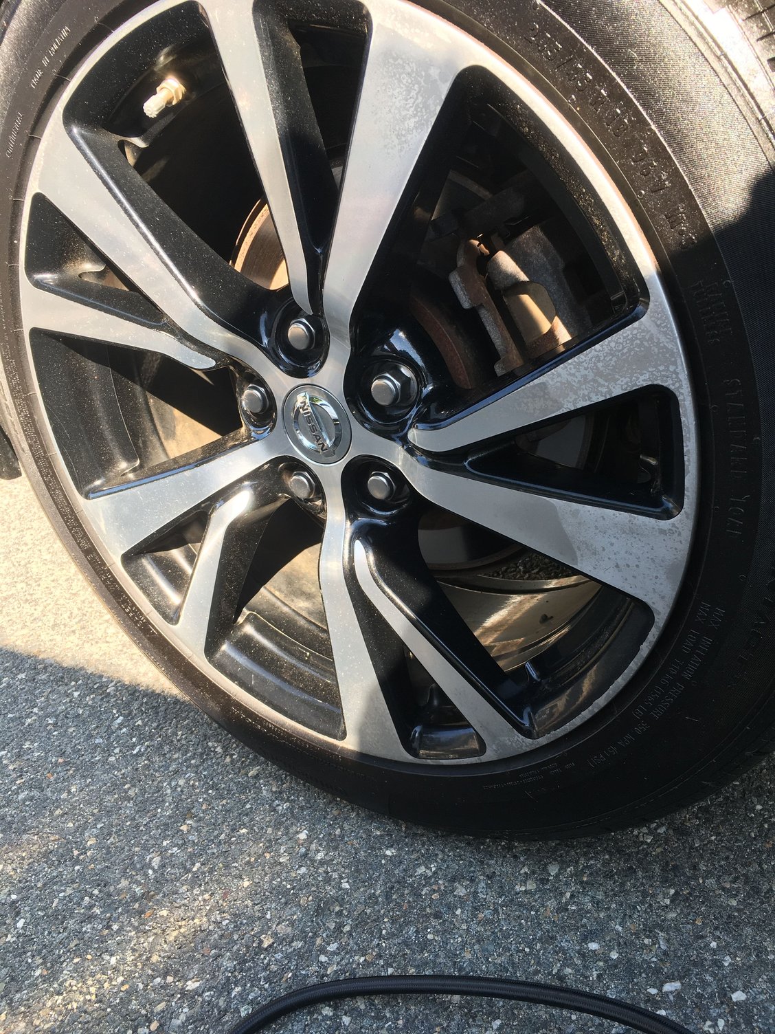

Hi Guys,
Just had my car detailed and when looking at the wheels, I wasn't thrilled how they came out. The detailer said that the laminate was coming off. I tried to rub the hazy area with my thumb and nothing changed. Just curious if anyone else experienced this. I'm wondering if it's something else. I was thinking of trying to polish them and see if it'd make a difference. Any recommendations on a wheel polish? Thanks in advance.
Right side of wheel is the haze

They may have accidentally used degreaser or similar.
It's not completely unheard of, but you can strip the finish off wheels.
You might have to get your wheels refinished. Not as bad as it sounds - I paid US$130 for one damaged wheel - they came to my house.

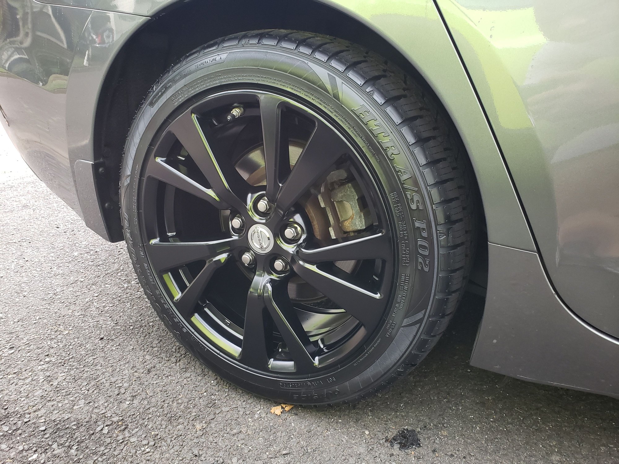

From: Philadelphia
I have the same rims didn't like the machined finish. I had them powder coated black for around $500 for all of them. They repaired all the curb rash also.

I ruined a wheel once, and it looked just like yours after spraying it with a caustic wheel cleaner, and letting it set too long. It looked very similar to yours, with the water-spotting look. I had to remove the clear coat, polish the aluminum, then reapply the clear coat. Patience and experience will bring that finish back like new. If you are not handy I would check with a local wheel shop to see if they can restore just the aluminum surfaces. Won't hurt to ask.

Once I used an abrasive wheel cleaner in a different car and forgot to take it out in a small area and it looked exactly like the picture here....
