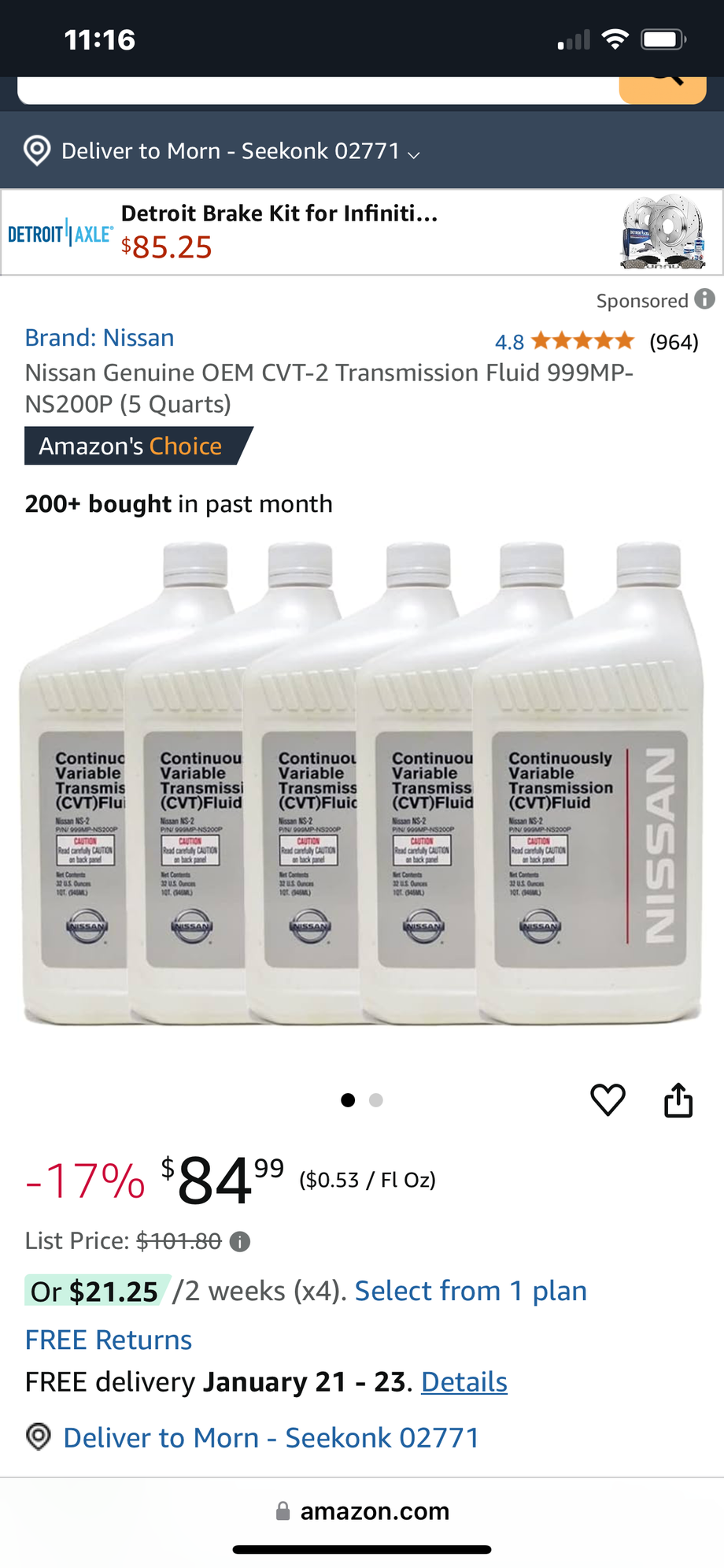

Ok, I’ll do that. Also, Is this the exact type of fluid I’m suppose to be using for the 7th gen? I’m not sure if all Nissan ns-2 are the same. I’ve attached a
Is this the correct ns-2 for a 2020 maxima sv?
Is this the correct ns-2 for a 2010 maxima sv?

Richard66's Avatar
Posts: 1,690
There is only one NS-2 CVT fluid. It is used in all Maxima from 2009 thru 2014 (7th generation).
You have the correct fluid.
Ok, thank god.. Just got 6qts for $111 total off Amazon now instead of having to spend around $170 at my local Nissan. Thank you!
