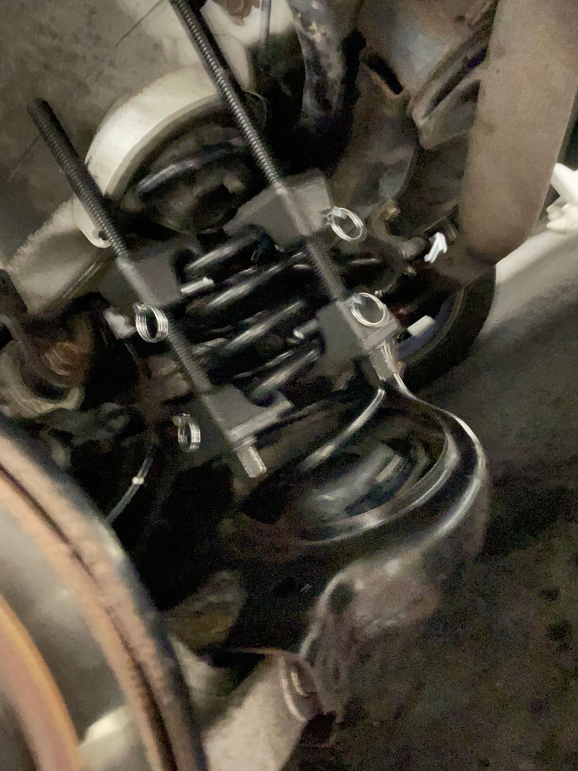

These are the clamps you don’t want to use

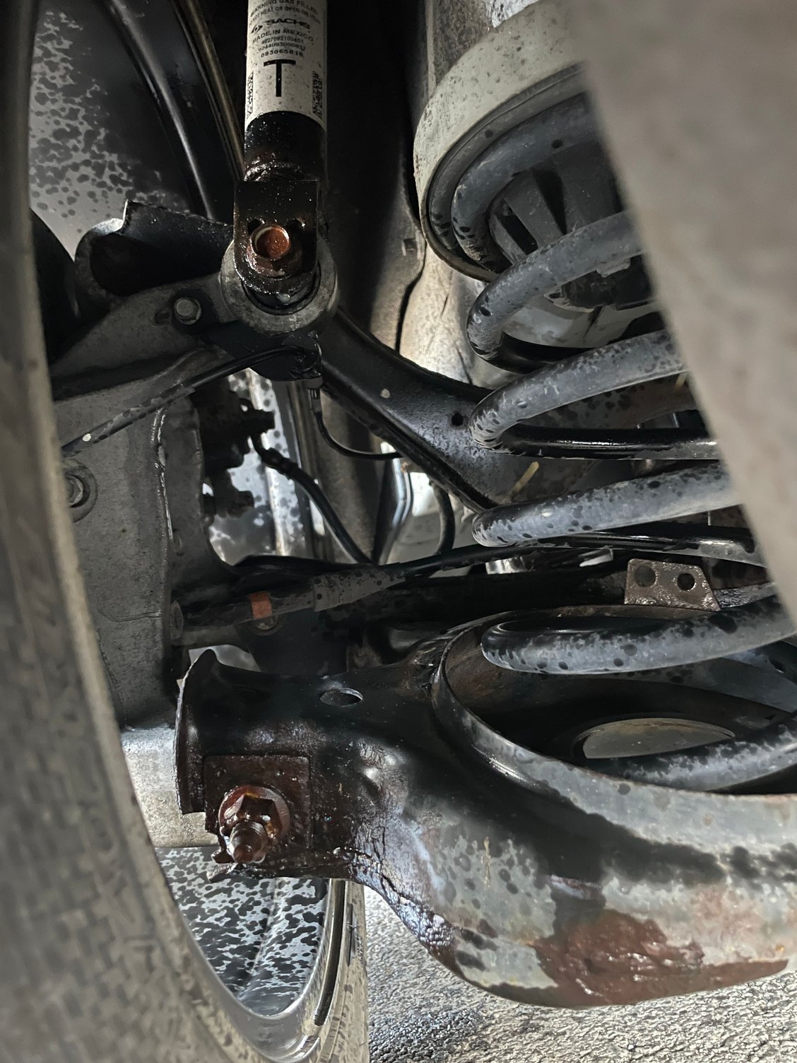

I had my right rear driver side lower control arm snap while I was driving on a highway in Albany Ny. Towed the car to my house and replaced it myself and it wasn’t that hard to do but I made the mistake of getting the crap spring compression toilet harbor freight (I highly recommend against using that) i ended renting one from autozone and made it much easier. 60$ for the lower control arm, 30$ for sway link and 300$ for the tow. I submitted all the proper paperwork and receipts. I didn’t send proof of ownership as it states only if over 1k. Big surprise they denied my claim.
