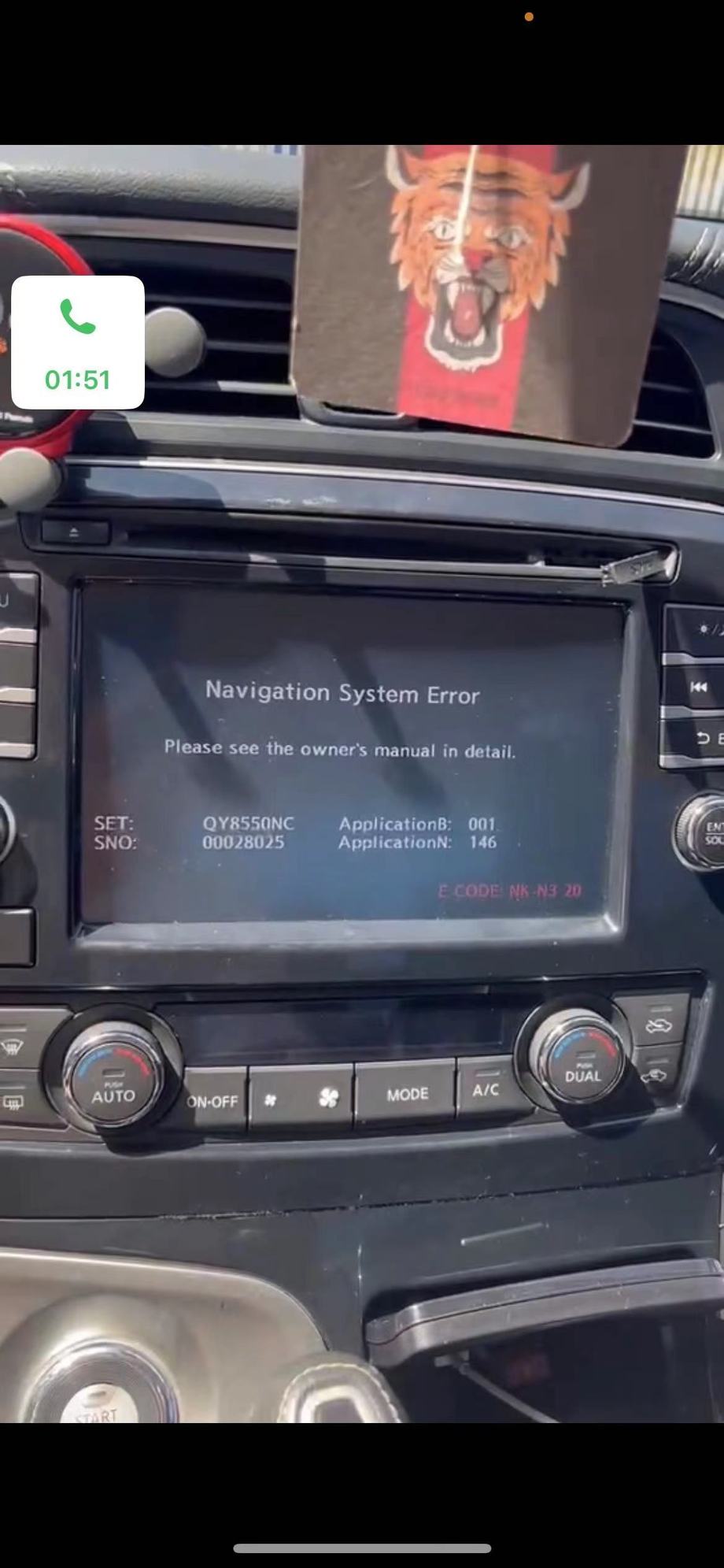

I am the owner of 16 . I bought 17 navigation and want to use Carplay, but an error will be displayed after inserting the SD card. Is there something wrong with SD? The seller said that this was the original SD card. How can I solve this problem?Thank you for your help
When I insert the SD card and turn it on

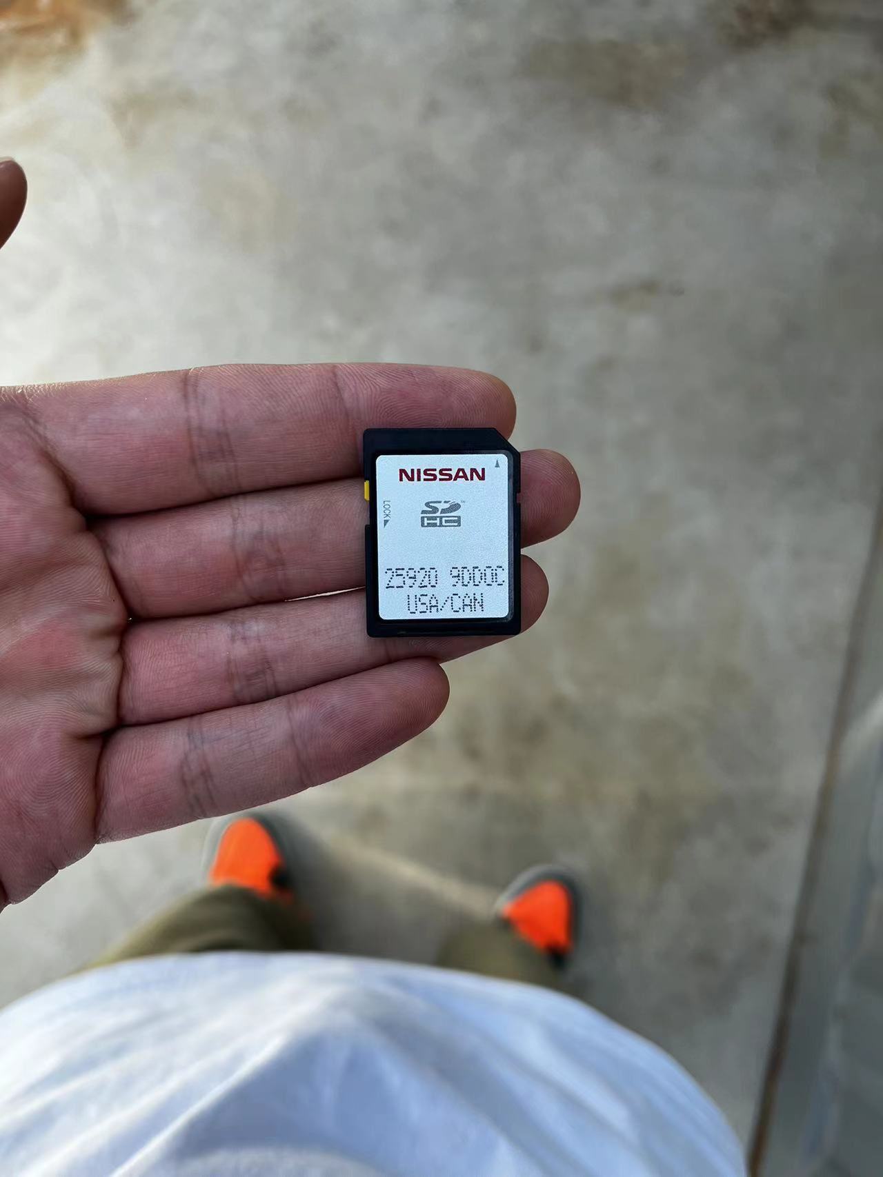

This is the SD card given to me by the seller

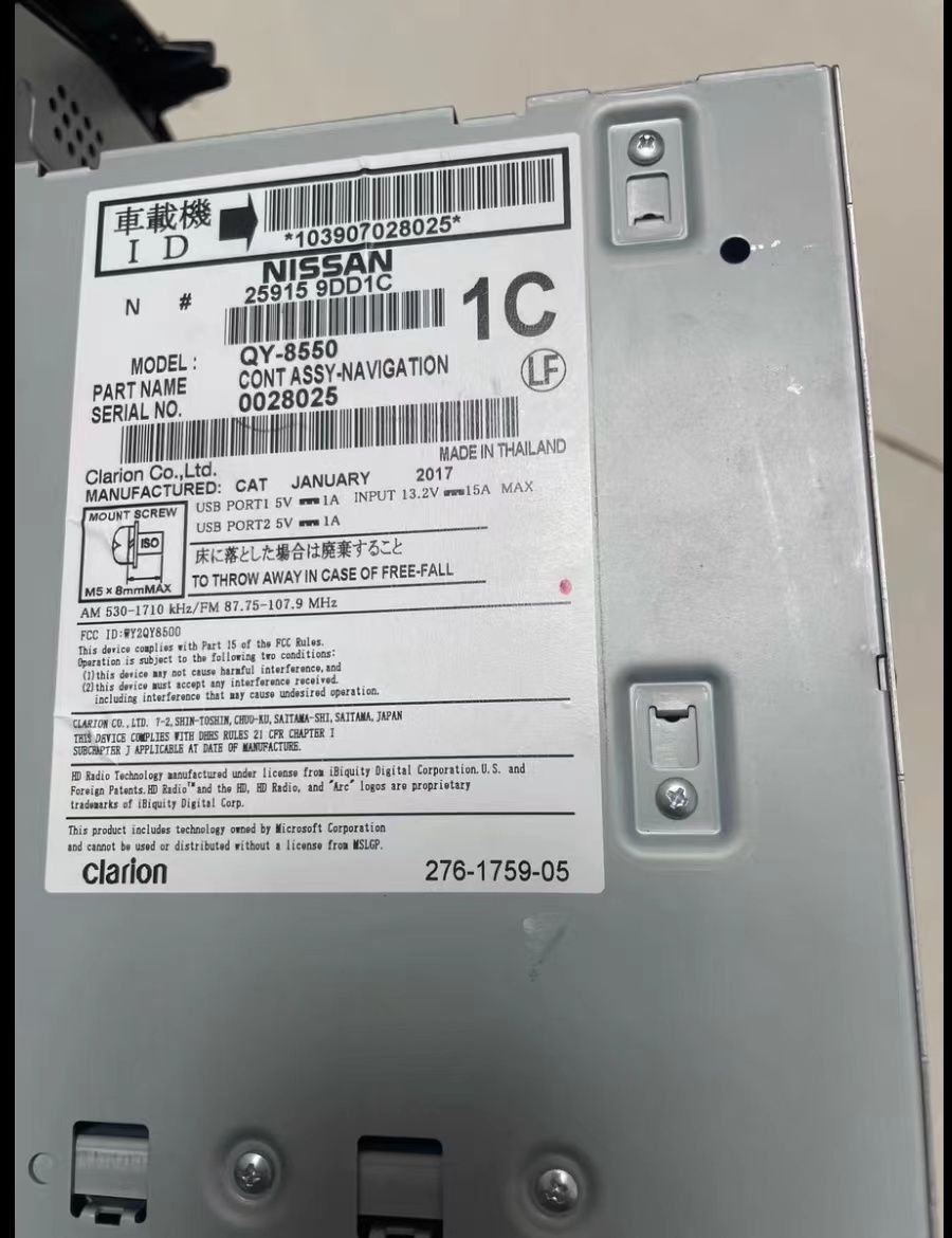

Check your head unit for the serial number. I believe it is on the top of the unit. I forget. But it will tell you if that is the original and correct card

Hello, buddy, this is my car ID. Can you check if there is anything wrong with me?

Look right under Nissan. The numbers don't match, that is not the original card.

Each heading and card are paired basically, you have to have a card with the exact same number. Your head unit is 25915 9DD1C. The card is 25920 9DD0C. They are not a match and won't work. I haven't had the issue but came across it when I was trying to update the firmware for the head unit

Thanks,i think i found the preoblem.this SD card does not have Bose machine
