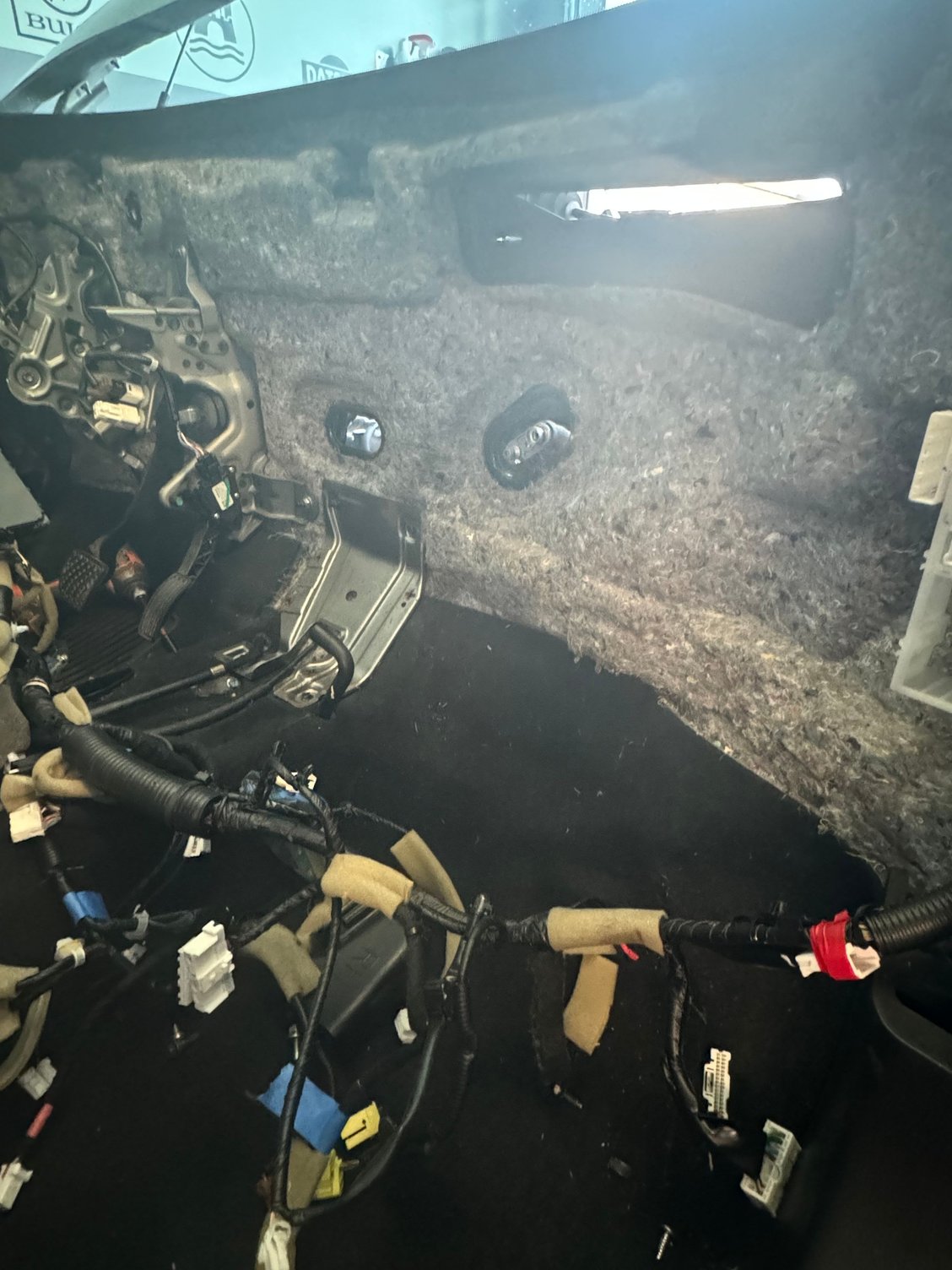

Replaced HVAC box.
Just DIY replaced mine with factory parts—HVAC box, new expansion valve, new receiver/dryer, and system recharge. All in, my cost was $1,000.00.
super time consuming job. On the plus side, my wife individually cleaned each and every component that I removed. Talk about detailed. Also since I had to drain it anyway, I replaced the radiator coolant.
