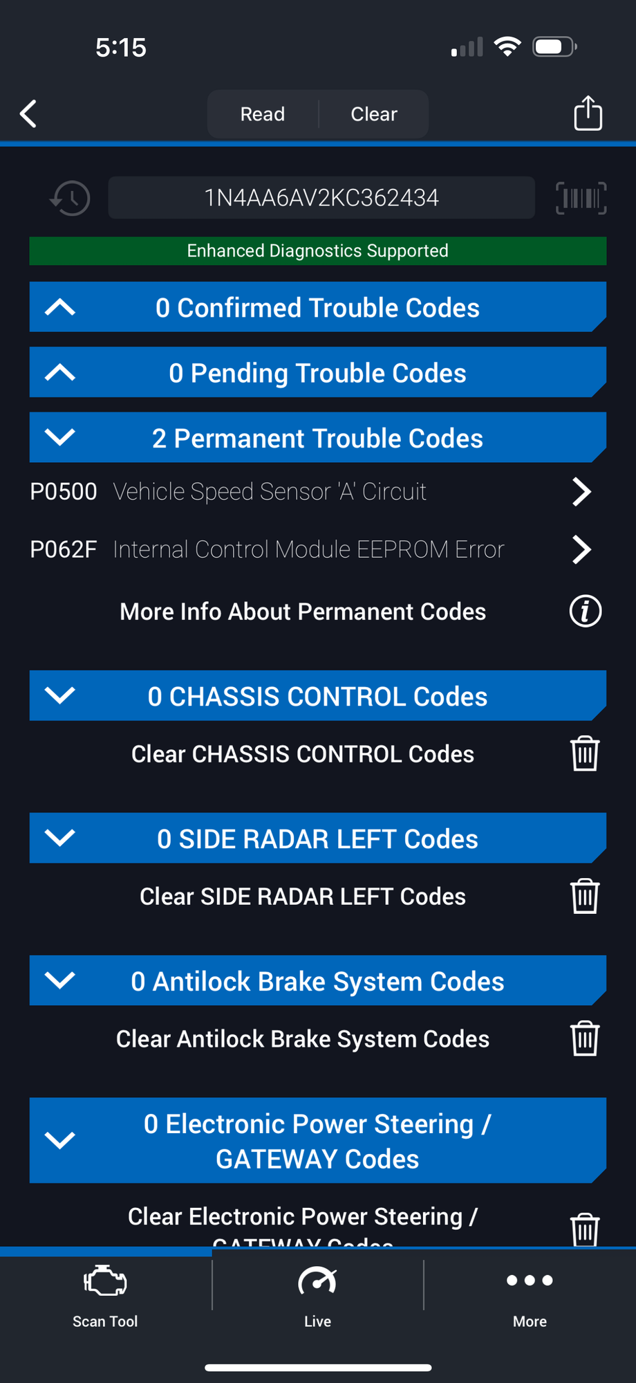

Long story short. A guy bought a car from auction and it started. Battery died and looks like he attempted to connect it then something happened that it doesn’t start.
I check OBD2 report and this is what I got. Would like to see you guys input to where to start.
also check engine light flashes when attempting to start.
lots of codes from airbags and such that are wreck related

Thanks for the reply, car was from auction, from end damage. No water was found on the vehicle. I inspected IPDM and looks like the guys put one from a 2013 Altima coded DD when it needs a D6. Not sure if that’s the issue but I have a correct one on the way.
I clear codes and rescan and now I only have a p062f and a 500 code

was able to start the car,
ECM and IPDM had to be replaced/ programmed. Wouldn’t get signal to start.
starter was also bad, had to replace after getting IPDM signal to crank.
