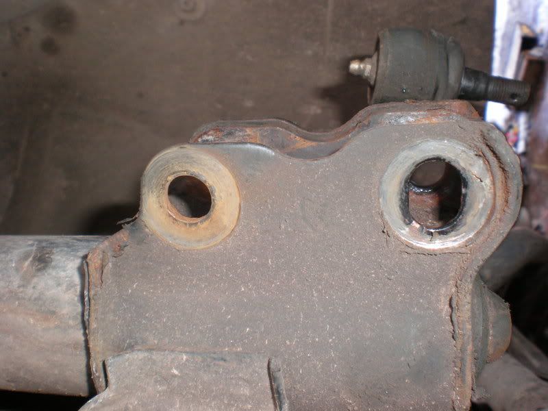

Here is a pic of the strut assembly w/o the hub assembly attached. I believe this is how alignment shops adjust the camber.

Most will claim that it's impossible to adjust the camber and act like you have no idea what you're talking about if you tell them otherwise.

wearing of the inside edge can also be caused from high speed cornering. After i put my springs ( eibach prokit) in, I was getting "brave"..lol My friend has the same springs in his car and they dont wear as fast. If u have Eibach prokit, it wont change the camber to the point where u need camber bolts. but if u have sportlines .. then u need them. I`ve tried slotting the holes on my struts like in that pic and it wasn`t that good. A nice bump will cause th strut to shift. For reference on getting camber bolts,1st-4th gen Max use 12 mm bolts. 5th-current gen use larger 14mm bolt.Hope this helps
